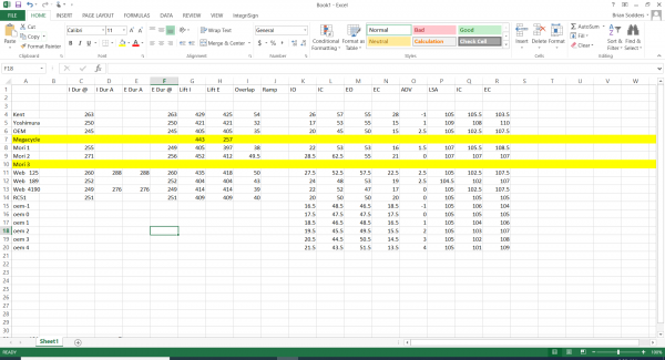

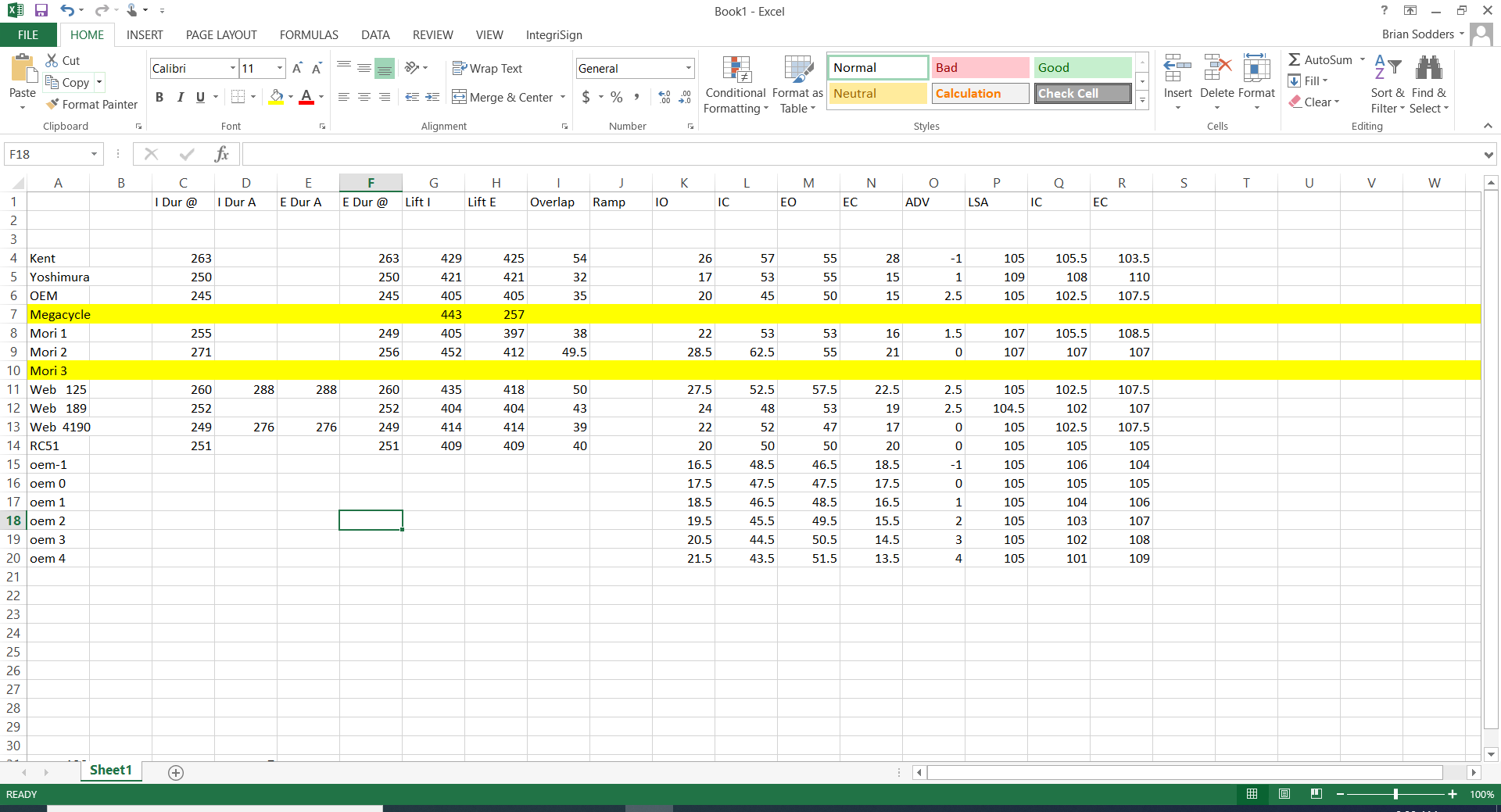

I have not made this chart interactive yet and some of the #'s are a little suspect only because I have not measured them myself. On the bottom of the list I advanced the oem cam timing to simulate events with an adjustable gear just so you can see how it is that we can make our oem cams perform a bit differently. Feel free to comment so I can update with better data. If anyone wants to share a dyno sheet I'd love to start charting HP& TQ numbers so people can get an idea with real data what their bike will do and at what RPM range.

The Kent re-profiled cam quoted figures are for HON21 profile which is used on SPs/RC51 not VTR1000F. The VTR1000F profile is HON19 which is obviously different.

I am unsure what this exercise is trying to achieve.
All aftermarket cams are run in conjunction with a whole variety of other mods such as P&G and/or skimmed heads, OEM air box mods and/or alternative boxes, different air filters, different jet kits, different exhaust combinations and many many more options. So it is virtually impossible to make a comparison.
If the exercise is to establish if there is any benefit from variable valve timing from slotted cam wheels on OEM cams on a completely OEM bike then I can tell you that the maximum improvement is 2bhp - 3bhp @ R/wheel

Agree, Roger.
It would be great if cumulative gains could be achieved, for example +8bhp with high comp pistons +4bhp with a jet kit gave everyone who did those mods +12bhp, but everything is interdependent and, of course, each engine has its own set of tolerances.
It's always interesting to read about an owner's journey, but the results aren't always transferable.
And far too often people change several things at once!
You never know for sure what is a positive change and what was negative unless you do one thing at a time, measuring and evaluating each one separately.

I completely agree with Tony. It would be helpful to members to have a BHP increase for various levels of tune but in practice it is impossible and therefore a chart becomes meaningless. The development programme of the VTR1000f by Revolution Racing in 1997/98 was sponsored partially by HRC, Moriwaki and our own team sponsors. We were able to work through the bike item by item to see how it could be improved for racing purposes, some tests to destruction, and the results was fed back to HRC. The ultimate result was the Stage3 BSB Superbike raced in 1999 which produced 152bhp @ R/wheel and I doubt if that will ever be reproduced today.
Members who ask me about upgrading their bike receive an approximate bhp improvement for each package level of upgrade which is based on previously achieved results by Revolution built engines.

No offense taken...the point of the exercise is to get the hard data on paper and compare results because there is a lack of hard data and or results. Regarding cam timing changes... I think that having the events listed is a very good idea because they are what make the cams do what they do. I'm not necessarily looking for peak numbers either, that's a bit of a rabbit hole. What I'm looking for is driveability, reliability, topend power, bottom end power, throttle response etc... I know exactly what the factory cams do, and now I know what my custom grind does. By advancing or retarding either I will know what effect that has on both of them from that data we can extrapolate what another grind may or may not do. If you recall I posted some homegrown flow numbers to determine what lift is necessary and or effective for a stock head. Turns out the factory lift and duration are pretty danged close to optimum because after .300 lift those heads level off very quickly with stock valve sizes. Now I don't know about anyone else but that satisfies a curiosity that I have and that's basically it. But it is nice to look back and see what I did that worked or didn't...maybe I'm naive but I expect other people on a forum for VTR's might have an interest in that as well, otherwise it's all guess work. What's really cool is that Roger pokes around occasionally and makes a comment or two...eventually he'll slip up and reveal some of the hard numbers that got he and Bob to the impressive numbers, hopefully...if he knows them... If not that's cool too. I have motor number 2 being built on my bench as we speak and it's getting the works without going over board.
