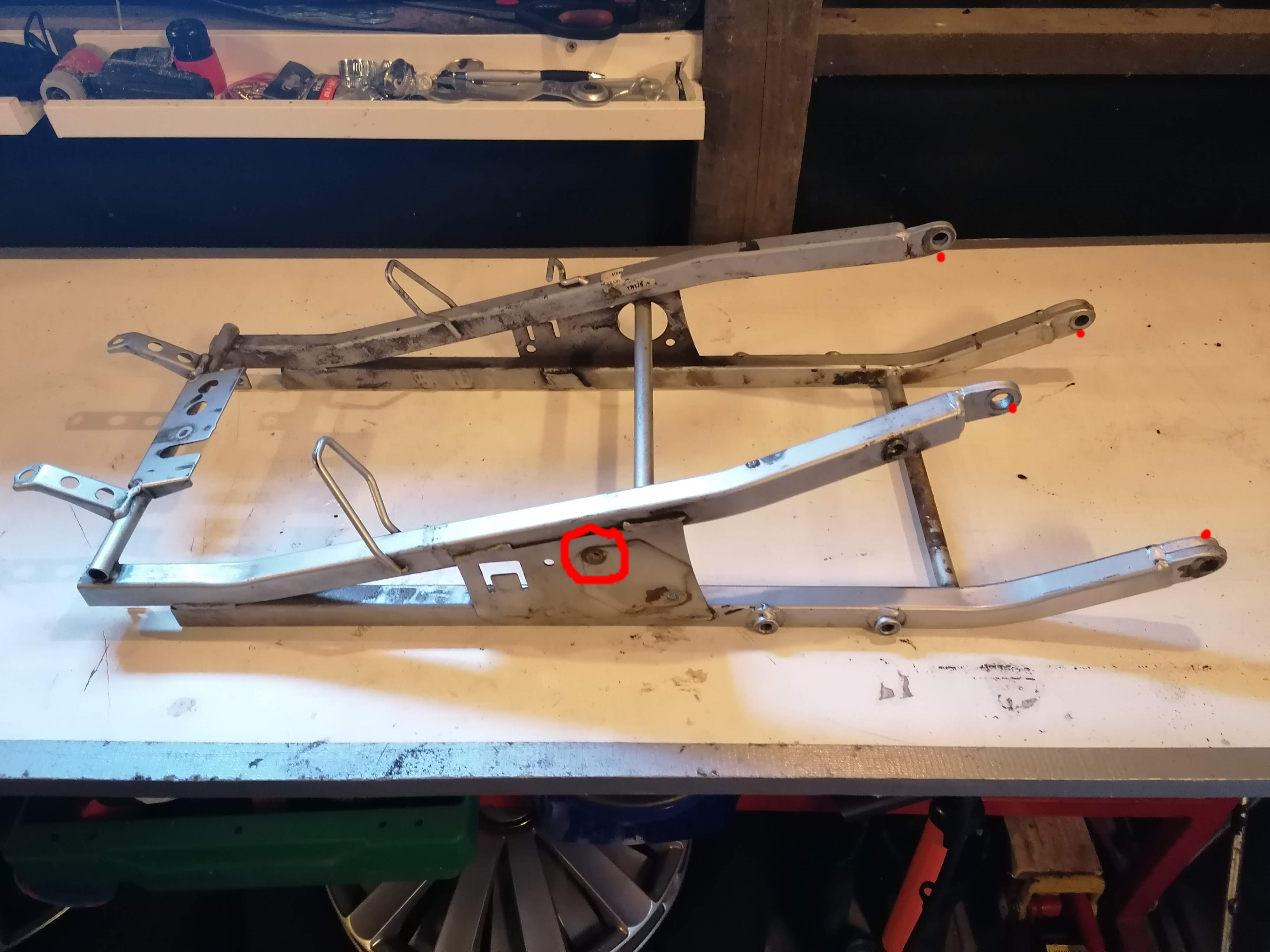

Picked up the subframe from the powder coaters - quite pleased with the result :thumbup:
Before:
And after:
Got it back on the bike:
Then looked out the shed window and decided to spend the rest of the day on the sofa :eek2

Nice did you remove PC from earth points ? IIRC you need bear metal where it attaches to the frame & you must have bare metal for the reg/rec earth. The green wire that goes under the bolt that holds it on the plate...
Posts: 17490
Circle is the R/R mount hole. Dots inside of arms... Scrape back to bare metal.

Like it..... :thumbup: just had mine powder coated Satin Black ground back the coating for R/R may of gone over the top but cleared the whole plate contact area.

Cheers Mac and mjvw. I'll make sure there is a connection before putting it all back together :thumbup:
The satin black subframe looks great :clap:

To Mac and nosepicker.
The green earth that bolts on with the reg/rec is not the reg/rec earth, that earth is in the wiring and block connector. It is still an earth though but should be ok if the bolt and thread is clean. It is important though to have a good connection between the main frame and sub frame so making sure it's metal to metal where it attaches is a good idea.
