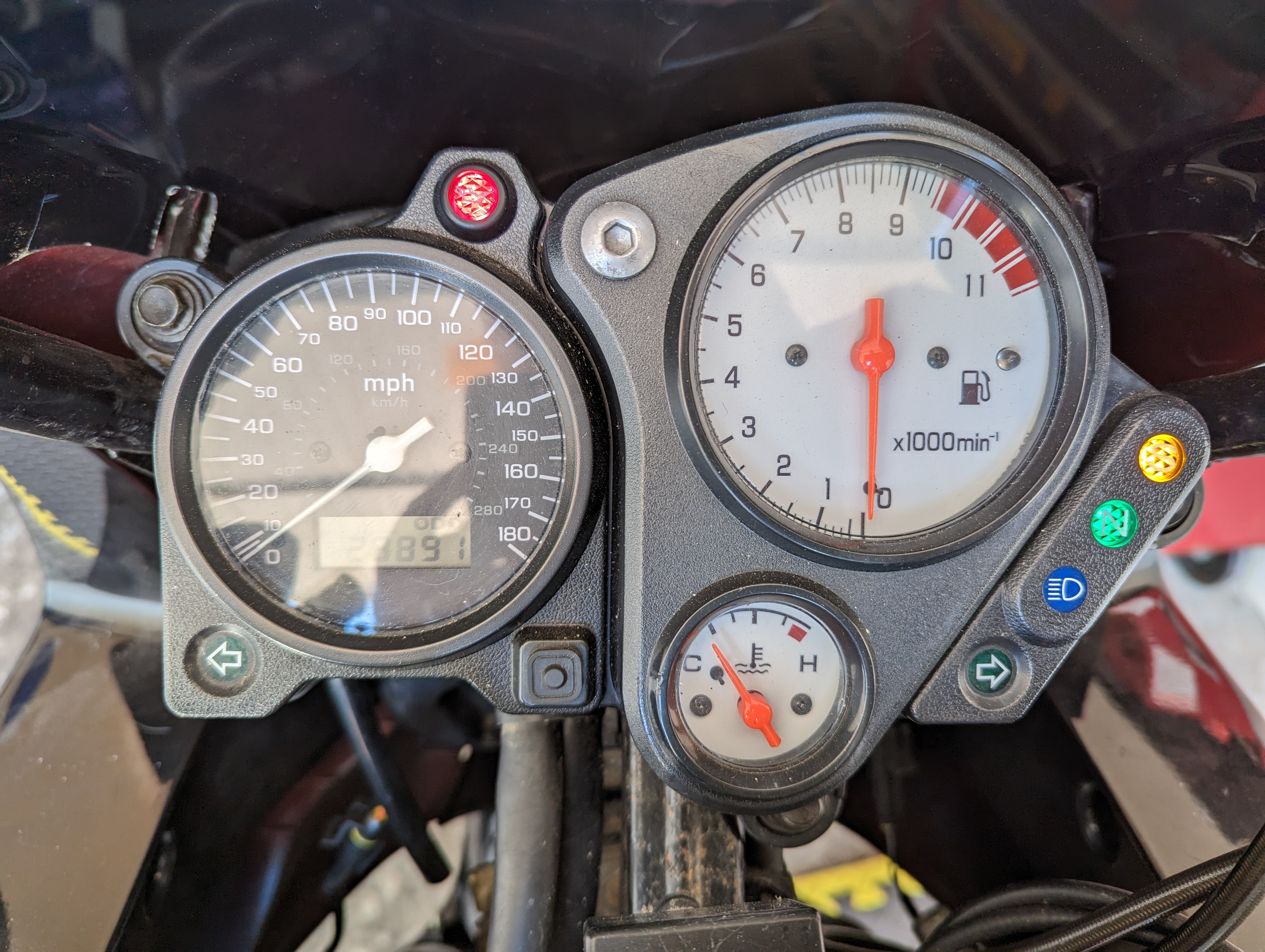

After an hour so with a friend with decent electric skills and a multimeter, seems the reg/rec is causing it. So new one coming this week.
So managed to get lights/dashboard all working. Should fire up fine once the reg/rec arrives and is fitted. Might extend the ground wire to the battery instead to get better contact.

No. Bought one just in case but first plan was to unplug as much as possible to see if the 30A still blew. But we were testing the new starter relay that we'd put in before and that seemed fine. So started checking the things plugged in after that and the reg/rec was giving all sorts of strange readings.
So unplugged that and started putting the other fuses in one at a time and all seemed OK. Dashboard, lights, horn, etc all working. As soon as reg/rec plugged in, fuse goes.
So ordered new reg/rec and an also going to move the ground connector to the battery as it will have a better contact.

It lives!! Back running again.
Happy days. 👍👍

One of the bolts that holds reg/rec on had the nut threaded (and it's welded to the frame), so couldn't use that. So drilled new hole in the plate that it mounts on so r/r was at a slightly different angle. Drilled another hole for the earth so it gets a good connection while I was at it.
So it is still earthed to the frame.
