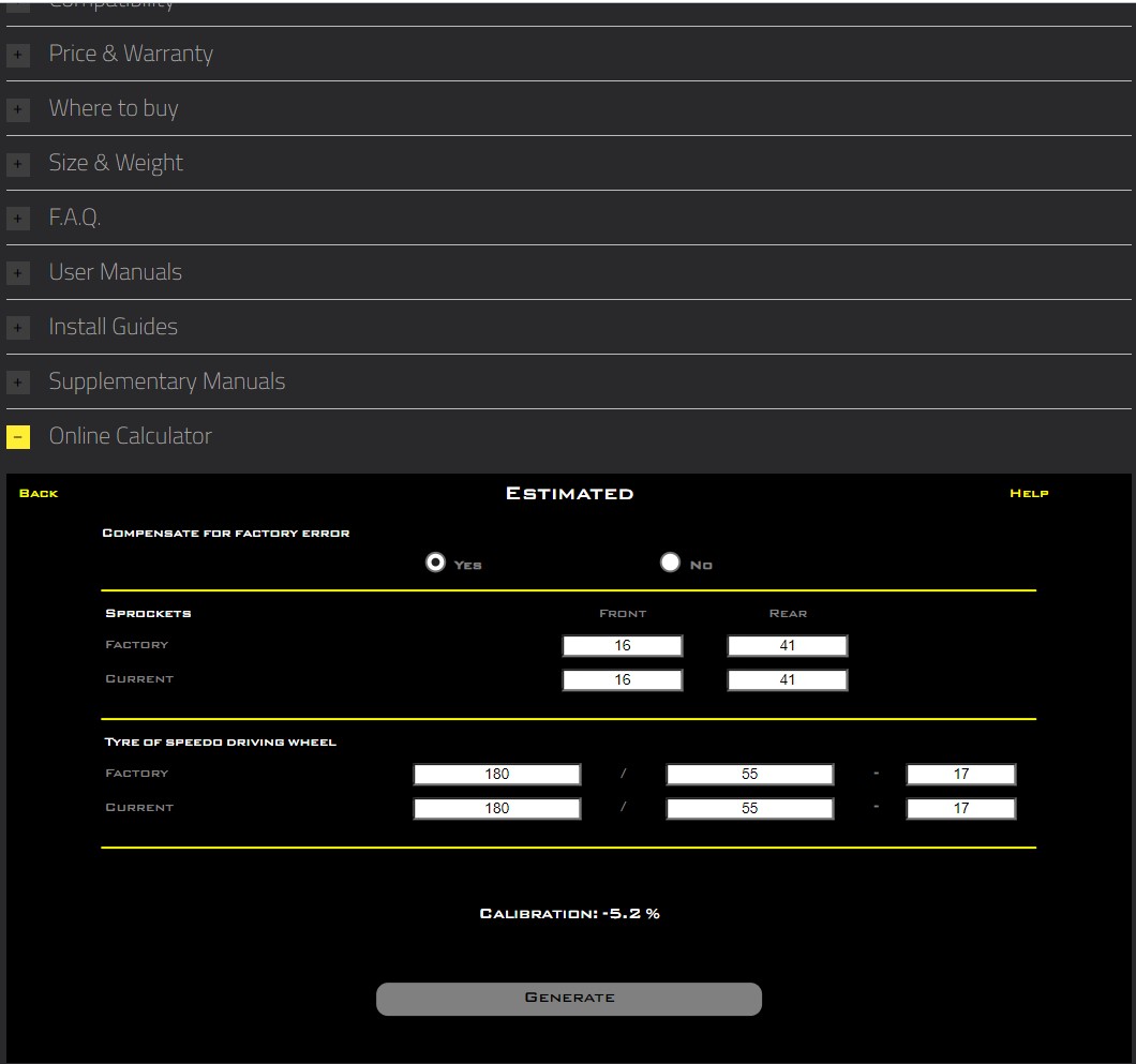

DJWALKER wrote: Sat Aug 06, 2022 5:58 am Yes mate I know that , I wanted to know If anyone new how much it effects speedo readings .
DJ, I'm guessing after reading Mac's post (re 17tooth front sprocket) your question has been answered :?:
However Healtech have a gearing calculator for their Speedo Healer. You can workout the percentage it's out from that chart once you have added the details of sprockets and rear tyre size etc. Click the link below for the Healtech site, then on the home page scroll down to "Online Calculator" then click the positive sign, then click on "Estimated" followed by "Generate" as shown here:
