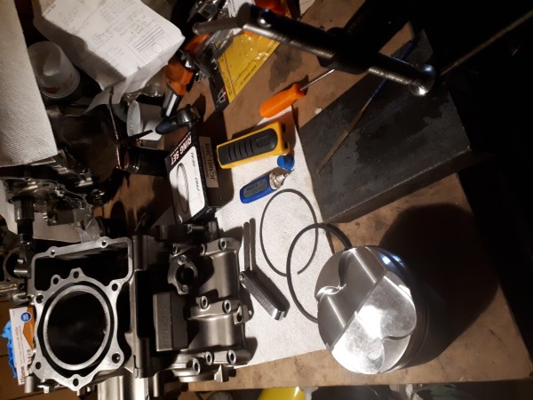

Come to papa....Chris58 wrote: ↑Tue Mar 13, 2018 7:47 pm Received JE custom 99mm 11.5:1 pistons today, getting block bored next week.
I dealt with a guy named Bryant.. I would highly recommend dealing with him.
Heres a few pictures with a bit of useful info. Notice on the spec sheet it has a job # for reordering...

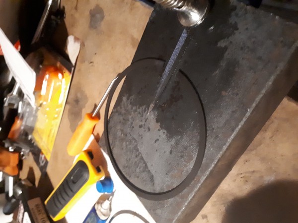

Next I filed rings to spec with a small file clamped to a flat piece of steel, and orientated them on pistons. Then Installed the pistons on rods, making sure the intake valve reliefs were orientated. I don't have a ring compressor..so I compressed the rings with my fingers and used my third hand to push the piston in.

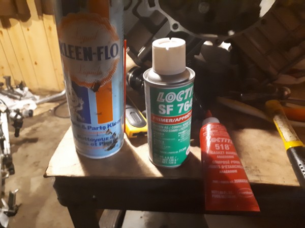

To mate the cases I used anaerobic case sealer. I also found a primer for it to be sure it cures, I have a hard time trusting it because the excess doesn't dry..

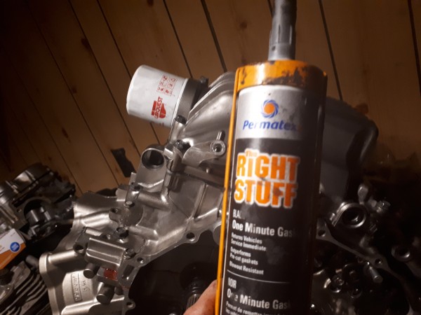

I use Right Stuff to seal just about everything (oil pan, side cases), highly recommended product.. guarenteed best gaslet maker/silicone you will ever buy.

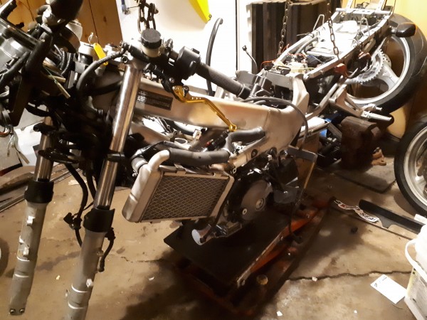

Did a bit more today. Got the engine in the frame. There was no need for those special tools for the frame spacer nuts.. Just had to line it up perfectly and pry a bit.

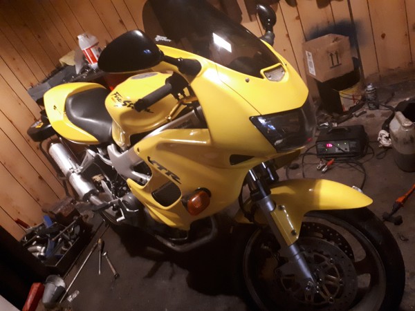

This build is finally done...time to start the break in period. fired it up today for the first time. It runs great, idled great, no leaks, not burning oil
The a/f ratio gauge shows the carbs are jetted good, I took it for a spin and it read anywhere from 12.5 to 13.5 on accel.
After running it for about a half hour I changed the oil.. expecting to see lots of filings in the oil.

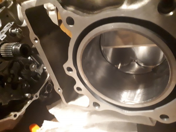

There were none to be found! Most likely thanks to the second machinist who re-honed the bores to a much nicer finish.

Thanks, I figured a little write up and pics might help out some fellow storm riders.. good to see you learned something new. Regular sealant can open up your main bearing clearence too much.
