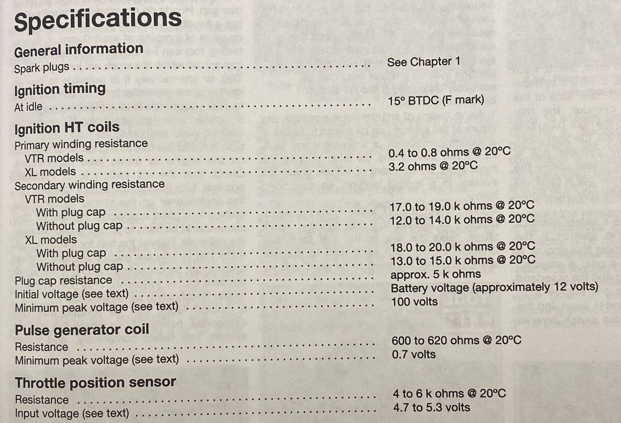

Afternoon guys,
I got around to removing testing the coils;
Complete (coil,lead and cap) they are measuring 17.5 and 18.5 kilo ohms. I cannot for the life of me find if this is within spec or not?
Any help would be much appreciated :)

If you've not already seen this from the Haynes Manual:
Complete with plug caps yours seem to be in spec on the secondary winding resistance :thumbup:
If there were a problem with your OEM coils, leads or plug caps I would expect readings from the front and rear to vary, yours are both really close.

Thank you Chris! You sir are a legend! I don’t have a Haynes but maybe I should get one.
I’ve ordered a second hand set of coils, leads and caps already so I will try these and see if they’re any different (it’s for my dropping to one cylinder at 2.5k problem.)
As you said the bench test results seem fine but that’s not to say one coil fails under load.
At least now I know what good coils test at!
