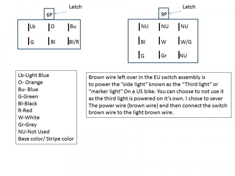

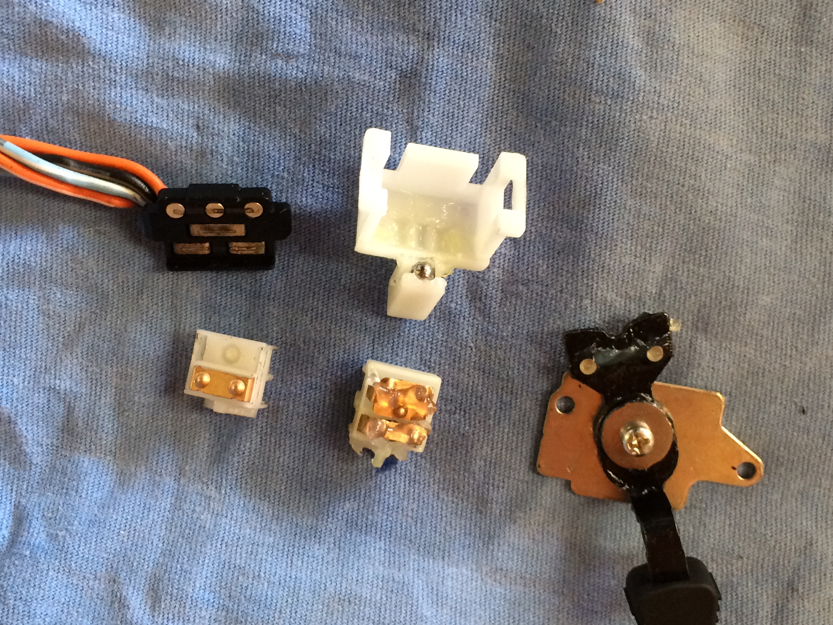

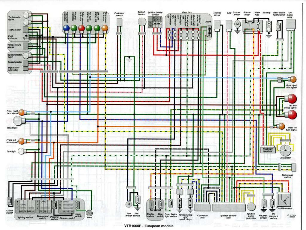

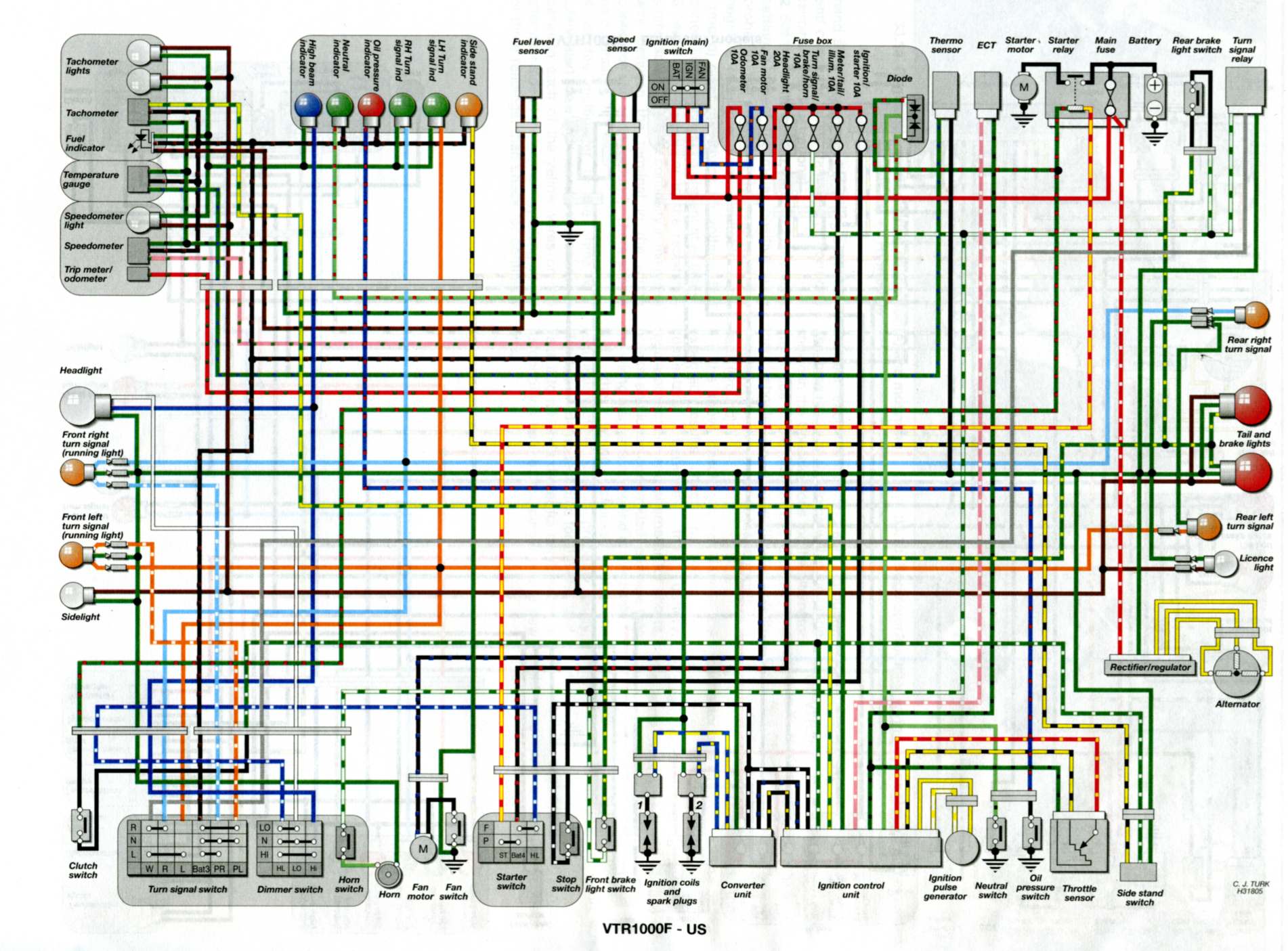

Did the conversion to the euro pass to flash switch a few years ago. This is the part number, 35020-mbb-640. Don't know if they are still available. Don't remember exactly how I did it, but if I can, it wasn't that hard. Used this pin out to sort the wires (thanks Eric). You'll need a pick to remove the terminals. I have a commercial tool, but one can be made from a piece of work-hardened steel wire, maybe. That way you don't have to cut wires.
Here is some info on how to: https://www.superhawkforum.com/forums/m ... hts-32695/
I did some fooling around with the turn signal switch, but don't remember why. I don't think it's necessary to do the swap of the two controls.
Original (US market) had two contacts
