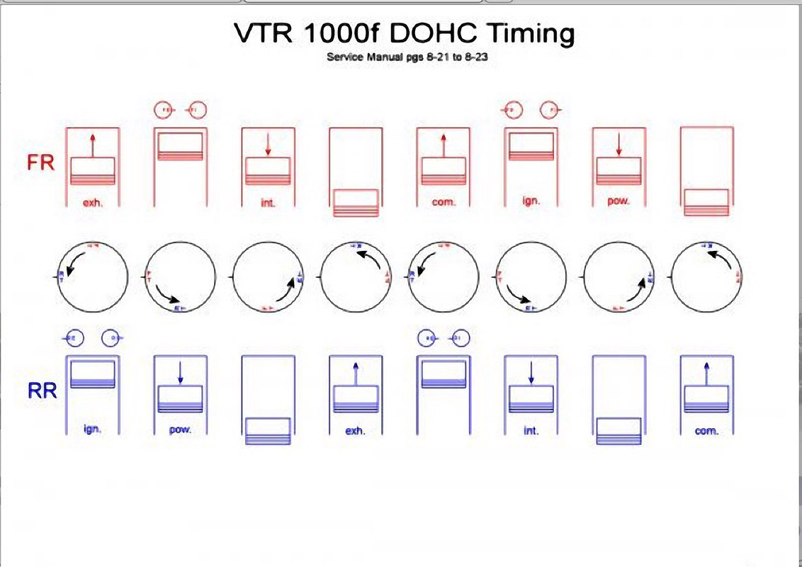

Posts: 21801
Re: New VTR rider..project
I'm glad to hear you are getting there :thumbup:
Posts: 16002
That's why Honda put a cam sensor on the later Varadero!
Well done for sorting it.
gtecomp wrote: Mon Oct 18, 2021 12:02 pm from old tread
so 0 - 450 deg
No that is not correct......
the front fires and then you get 270 degrees of rotation and the rear fires. Then you get 450 degrees of rotation to get back to "0" or a total of 720 degrees of rotation for the front to fire again.
gtecomp
Posts: 41
Joined: Wed Sep 29, 2021 9:21 pm
Post by gtecomp »
hmmmm.. with 0-270 firing order I receive so much explosions that the neighbor complain to me that the chicken are depressed and no eating :beer:
And yes you are right, but finally 450 deg is distance between two ign. events, where ever you put the "0" event - at 0 or 270 deg.
...or not.hm we have one event on 270 then second at 450 deg..ahhhhhh that's why they called it 270-450.
