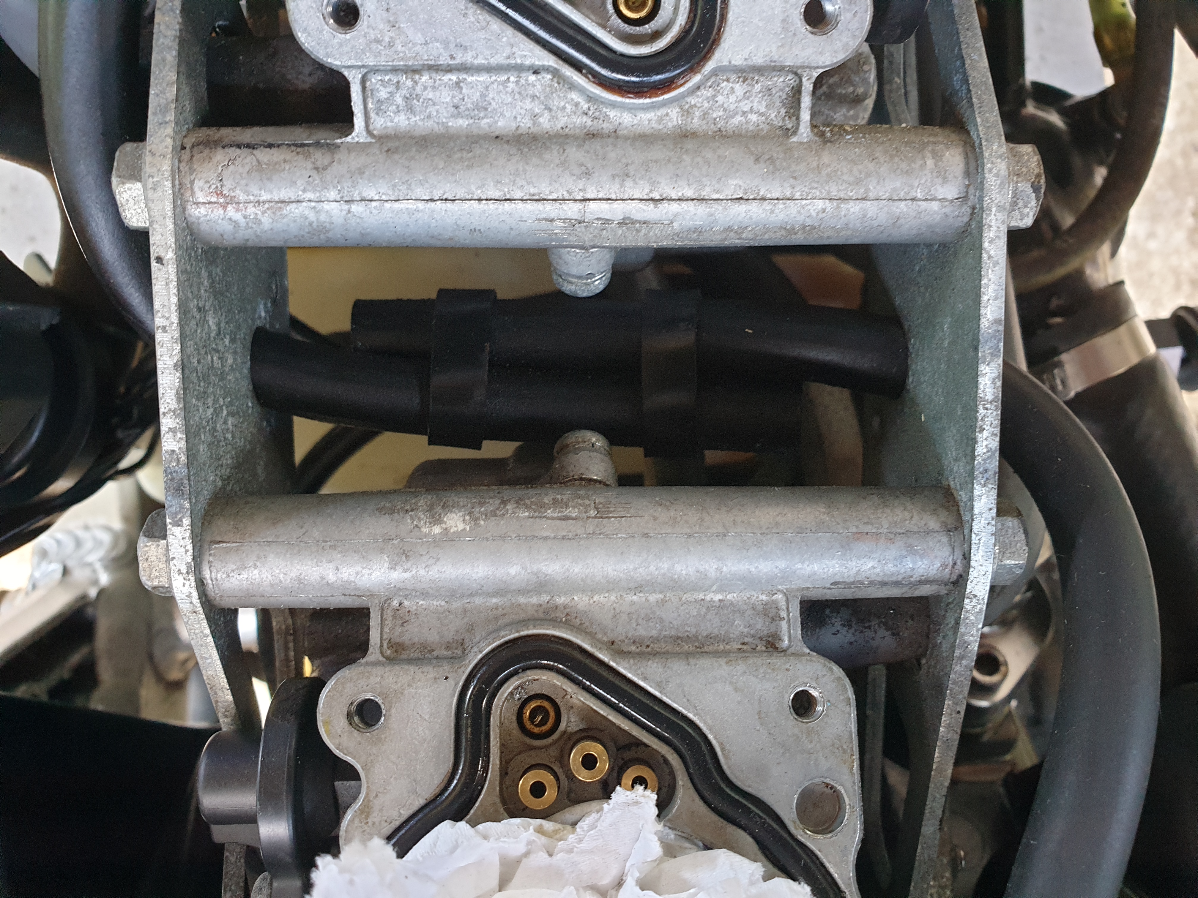

Hi Guys I have managed to fit the cct,s but I seem to have a fuel leak
Carbs
Carbs
Well it's pouring out of the two pipes inbetween the carbs photo above. So it's not strictly a leak it only does it when turning engine over I wonder if it is the float valves sticking but I didn't touch the carbs apart from removing them and then replacing.
Any one got any idea?
Thanks for reading.

Fuel tap gasket.
Re: Cam chain tensioners
CCM spitfire 05 wrote: Tue Jul 20, 2021 4:01 pm Hi Guys I have managed to fit the cct,s but I seem to have a fuel leak 16267928707885343983362216306784.jpg
Thanks for reading.
Ride on brothers
Those are the overflow vents from the float bowls. So yes it does sound like either the floats or float valves are sticking.

Check your oil for fuel dilution before you run the engine.

Guys I am not a clever person it turns out that the bike standing for 2 years didn't do the carbs any good so my main mistake was to not take the bowls of and give them a clean to be honest the float valves were seized with green corrosion I should of known to clean them. Heyho life is a lesson.
