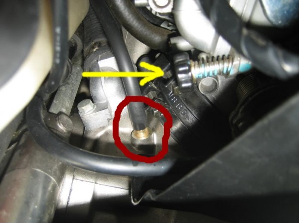

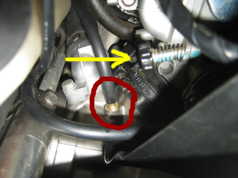

Set idle to 1300 ish give or take 1000 rpm.
Front carb R/H side black plastic thumb screw...
Do it when bike is up to temp, turn eith way it will be apparent which way is up or down.
Give it a blip between adjustments.

Thanks. Bike idles around 1300-1400rpm when hot.
Bike still pops a bit sometimes at idle. Seems to rev ok. Does it need the carbies sychronised? What is involved in that process?

Of all the mods I've done to my VTR, balancing the carbs has produced the most satisfying results. No more pops & farts at idle, and now a choke that actually works!
As per MacV2s picture above, in the red circle, you need to remove the blanking screw from the front carb, and add a brass vacuum adaptor. Then hack in to the existing rear carb vacuum line with a t-piece. Then get hold of a suitable balancing tool, i bought an electronic one. Balance adjuster is on the rear carb, which can be reached without taking the tank off with a long thin screwdriver with an angled/swivel adaptor on the end.
The front adaptor and rear t-piece can be left in place and blanked off when you're done, ready for any future balancing.
There's a detailed thread about it somewhere here in the workshop section.

Thanks Mototrick. I've decided to take it to a professional to do the carbies for me once it's legally on the road.
On 2nd thoughts I'll have a go myself.
Is this the carby sync thread? viewtopic.php?f=31&t=18430
NOTE: Link to PDF of carby sync document no longer valid.
What size vacuum hose? And what are the dimensions of the brass adaptor? What size t-piece?
Is this kit okay? https://www.ebay.com.au/itm/124186918683

I'll answer what i can!
Yes, that is the carb sync thread i mentioned.
The original Honda Vacuum adaptor is known as a JOINT BOOST, Part number 16214MB0000. I think it's a 5mm thread, but maybe get a 2nd opinion on that. If you get one, (maybe buy 2?) be very careful when you tighten it. It's brass and fragile, i broke my first one and nearly ended up with the threaded part stuck in the cylinder head. There's a washer associated with it, part number WASHER, SEALING, 5MM 90452323000. I used some thread lock to seal it as well.
3.5mm ID vacuum hose will work, i bought a 4mm t-piece.
All of the above is pretty cheap and you can get to the stage where you can balance the carbs in less than an hour. The actual balancing gauge is the expensive part. I bought a 2nd hand Twinmax electronic gauge for £45, expensive but very nice to use.
