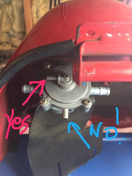

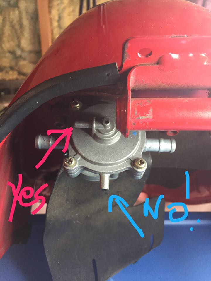

Relay clicking ?
Stick a new battery in it to start off with it may be that the batt has dropped a cell.
Then keeping with the simple stuff make sure that the vac line to the petcock is connected to the correct spigot...

The petcock is fitted correctly and the pipe and hole in the block are clear.
