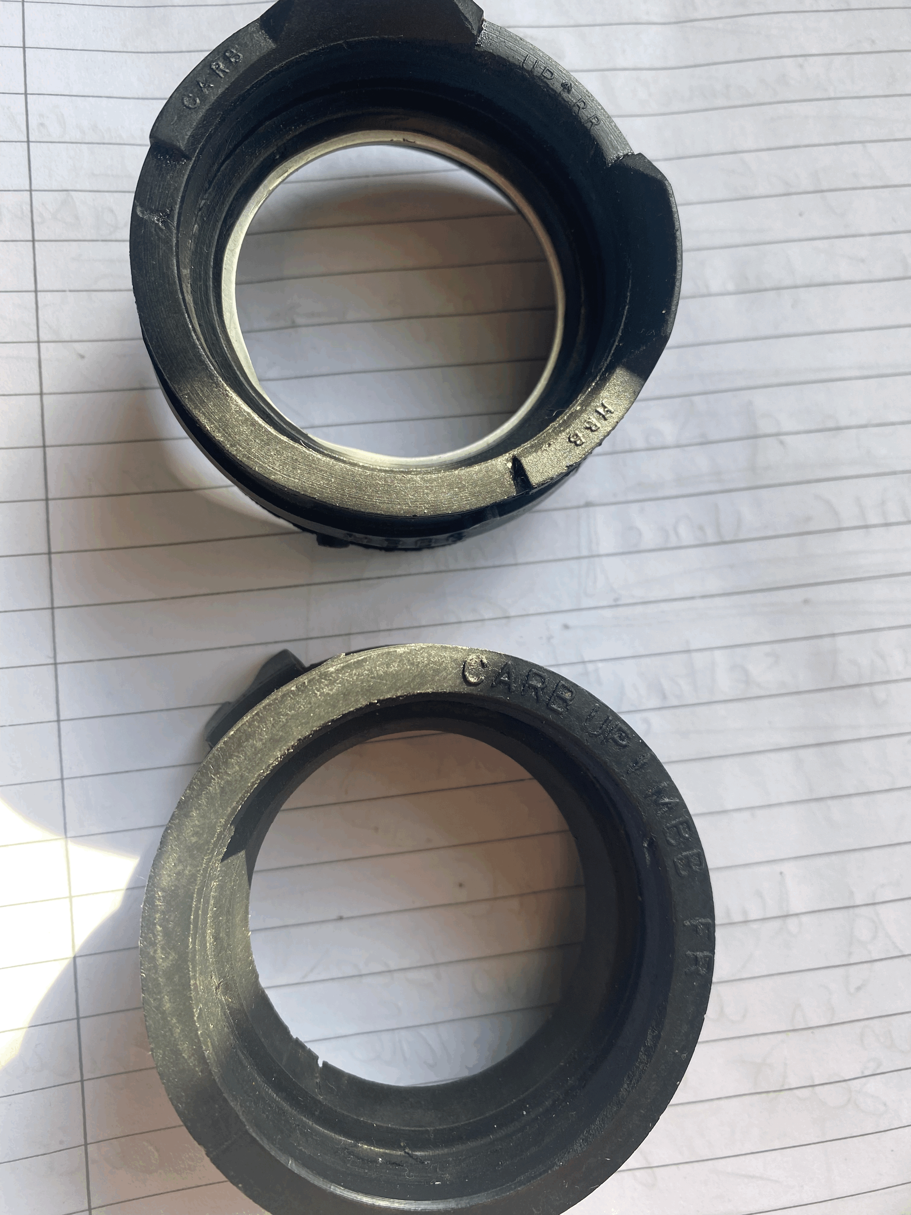

All is well - made the final change. - new inlets stubs - bit of back and forth with wemoto (who are great as usual) as they only stock the restrictor plate version which is down the replacement on the 1999 bike. - here's the interesting bit the front inlet had no metal ring (rear was completely standard) - no signs of it being removed - I've attached a pic - could be an after market item.

You can easily pull the aluminium restrictor ring out using pliers.
