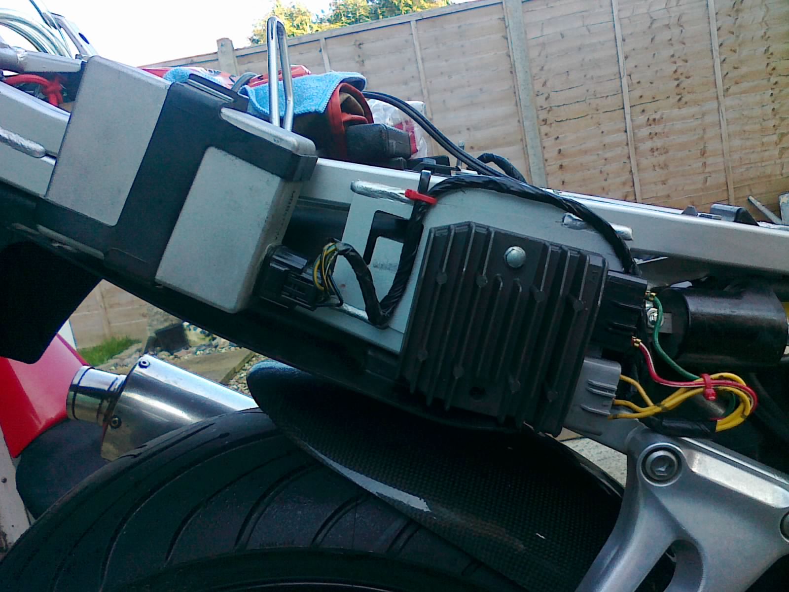

Mounted on the R/H side of the subframe.
viewtopic.php?p=473463&hilit=OEM+Regula ... er#p473463

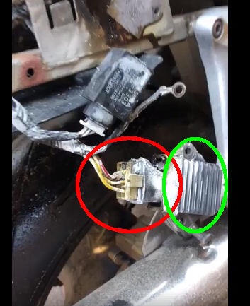

Later bikes should have a finned type to aid cooling but they can still fail & indeed they do... Electrickery old style shunt type means heat... melted wires & sockets...Extream case is it overchagres the battery which can cause it to swell...Or worse can cause the bike to go up in smoke...
Avoid cheap ones off ebay most likly cheap chinknees copies. see above !
Personaly I go with Mosfet BMWS1000r needs a bit of rewiring.
- Attachments
- Burn RR.jpeg (56.24 KiB) Viewed 2544 times
