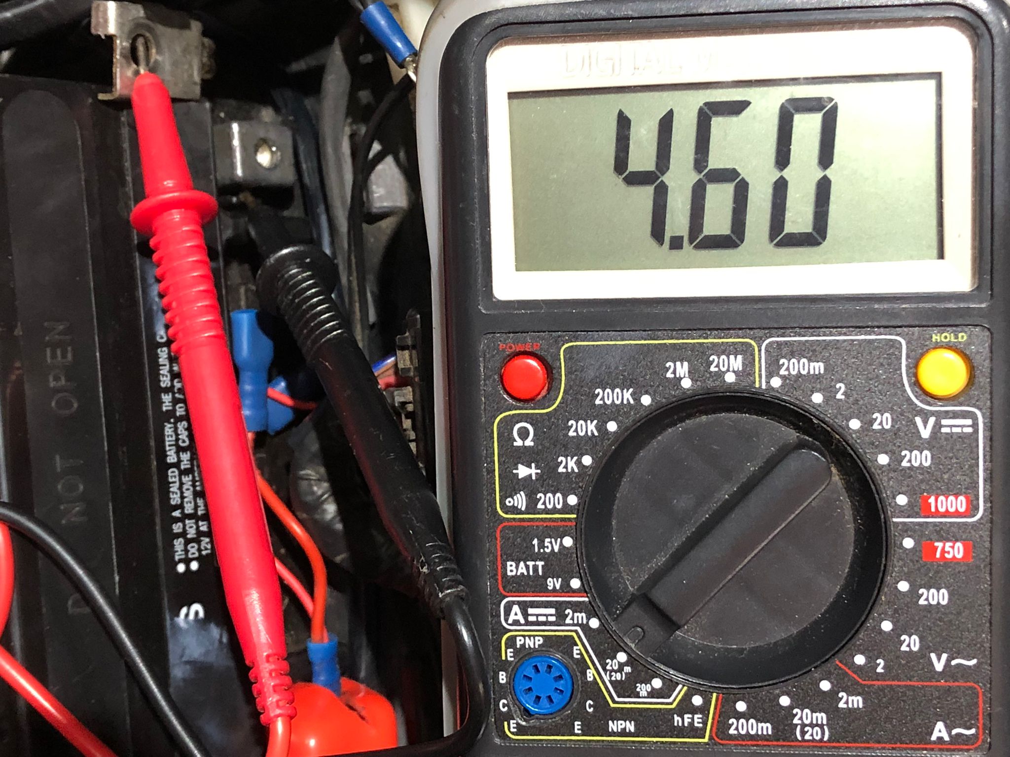

After all this talk I decided to check the parasitic draw on my VTR this afternoon, as I have never checked it 8O
The first attempt showed a 4.60 mA draw :crazy: as below:

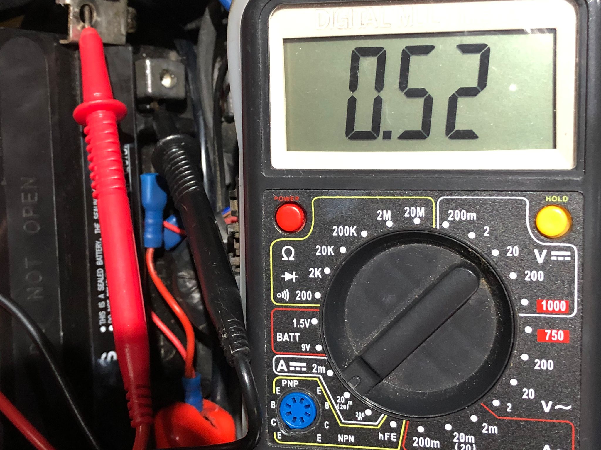

The second attempt was better at 0.52mA which was after I removed the fuse from the aftermarket alarm/immobiliser even though it was in an off state, at rest:

A fair reading with a factory immobiliser would be about 0.3ma, your not far away Chris, if you’ve just got a lcd display maybe it’s still a little high. You can work out from the ma figure and the battery AH how long it will take for the battery to flatten from a set good voltage, 12.9 would be a good battery. I can’t remember off the top of my head the calculation but pretty sure Google will have it somewhere.
