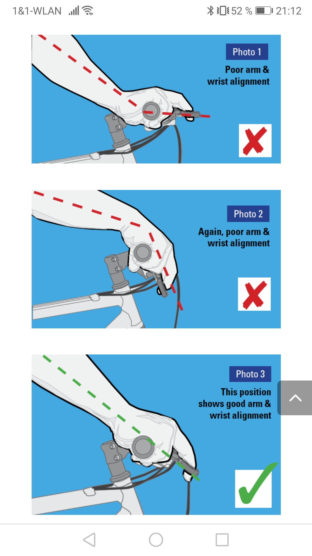

Re: Front sprocket 17T - any experience with it?
Which fingers are getting numb?
Basically there's two nerves in charge.
One for the thumb, index finger and middle finger.
The other for the ring finger and little finger.
The nerve for the first three is often numbed by a too high angle of the hand vs lower arm. That's usually caused by a too high position of the levers. (see picture)
If that's the cause adjustment or a different handlebar could help.
The second one for the outer two is triggerd by too high pressure on the inner hand surface. On bicycles you use special grips with a little more surface reducing the pressure.
Here you could try wider gloves or bigger/softer grips like these:
https://m.louis.de/artikel/schaumgummig ... r=10019505
