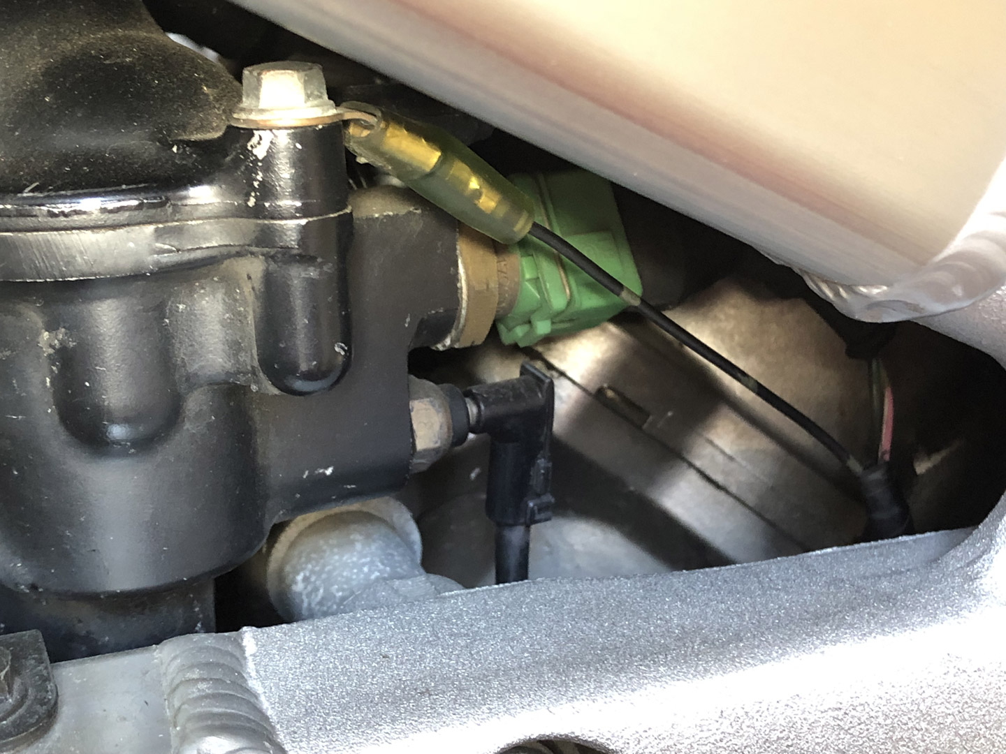

Check out the photo's I took from my VTR,

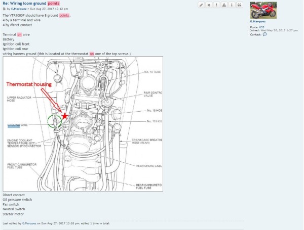

I have been thinking about this odd wire and did a bit of digging as I haven't come up with anything from my Workshop manuals.
This shows the number of earths (ground) points on the bike, and explains where they all go:
The link here is where I got the diagram from, thank to Erik:
https://www.vtr1000.org/phpBB3/viewtopi ... 84#p451284

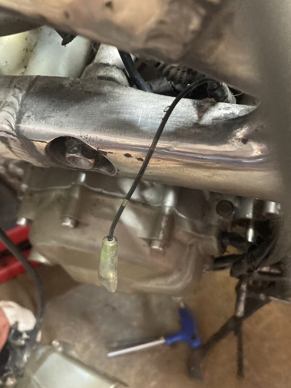

I'm posting this photo up on behalf of northmanuk. This is the wire and connector he is having difficulty in working out where it goes:

OK but whats the other end conected to ?
That pic is a bit chocolate teapot...
It looks like the wire that goes to the top of the thermostat... Look at your pic it has the same green dot on it... Maybe the ring conector is missing...

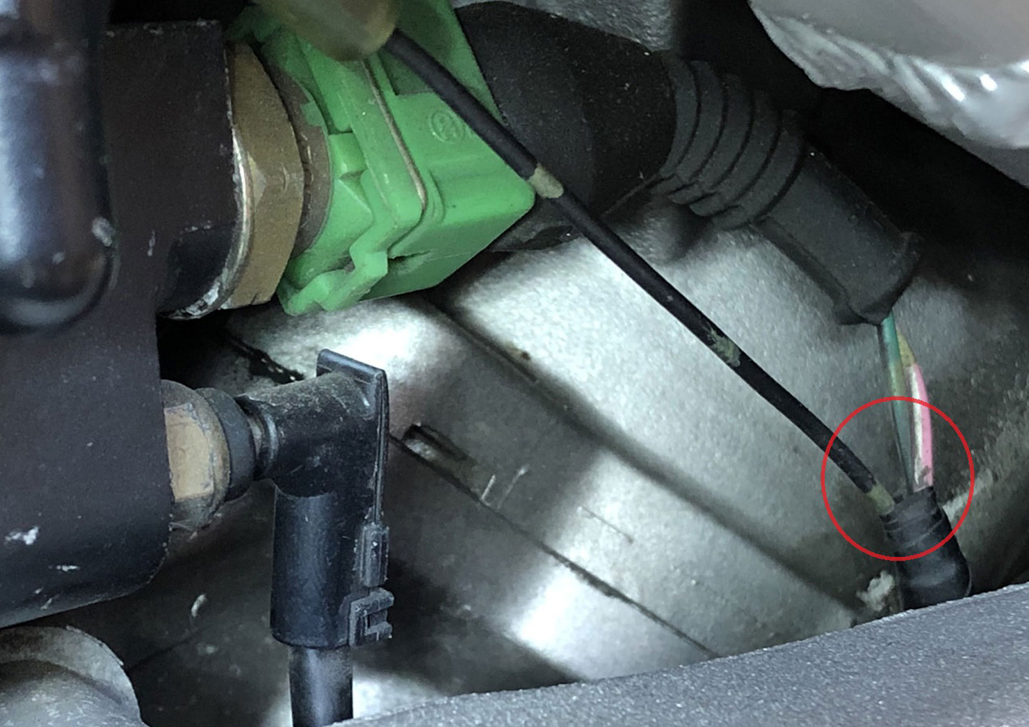

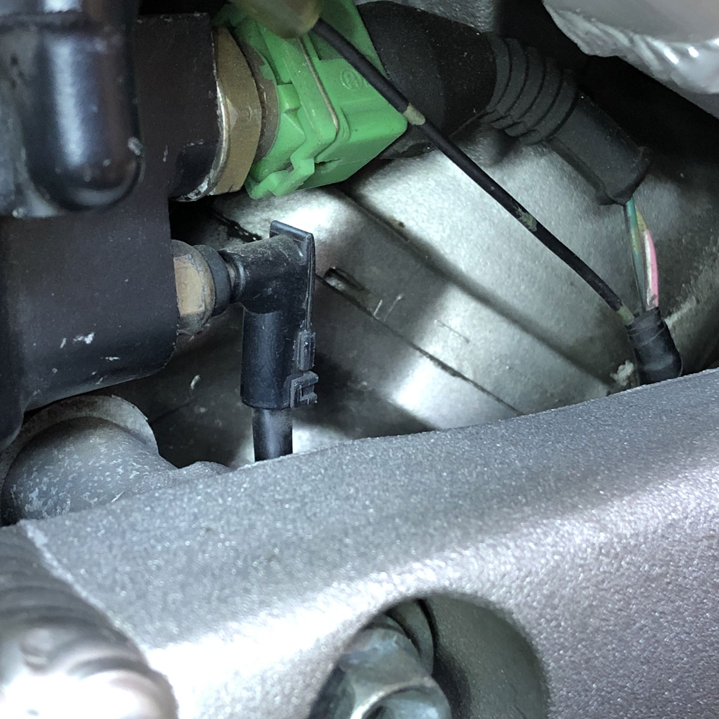

Does the wire in your photo come out of the loom at the same exit as the 2 wires that go to the big green plug? (the 2 wires are pink with a white line, and green with a black line if I remember correctly).
As I have ringed in red below on my bike :?:

northmanuk wrote: Fri Aug 19, 2022 9:05 amyes
Ah, well that wire being one of those 3 is the correct one that goes on to the thermostat housing as shown in the photo of my bike below, the one you have fitted must be for somewhere else. Try looking to see what other wire(s) exit the loom with that wrongly fitted wire.
