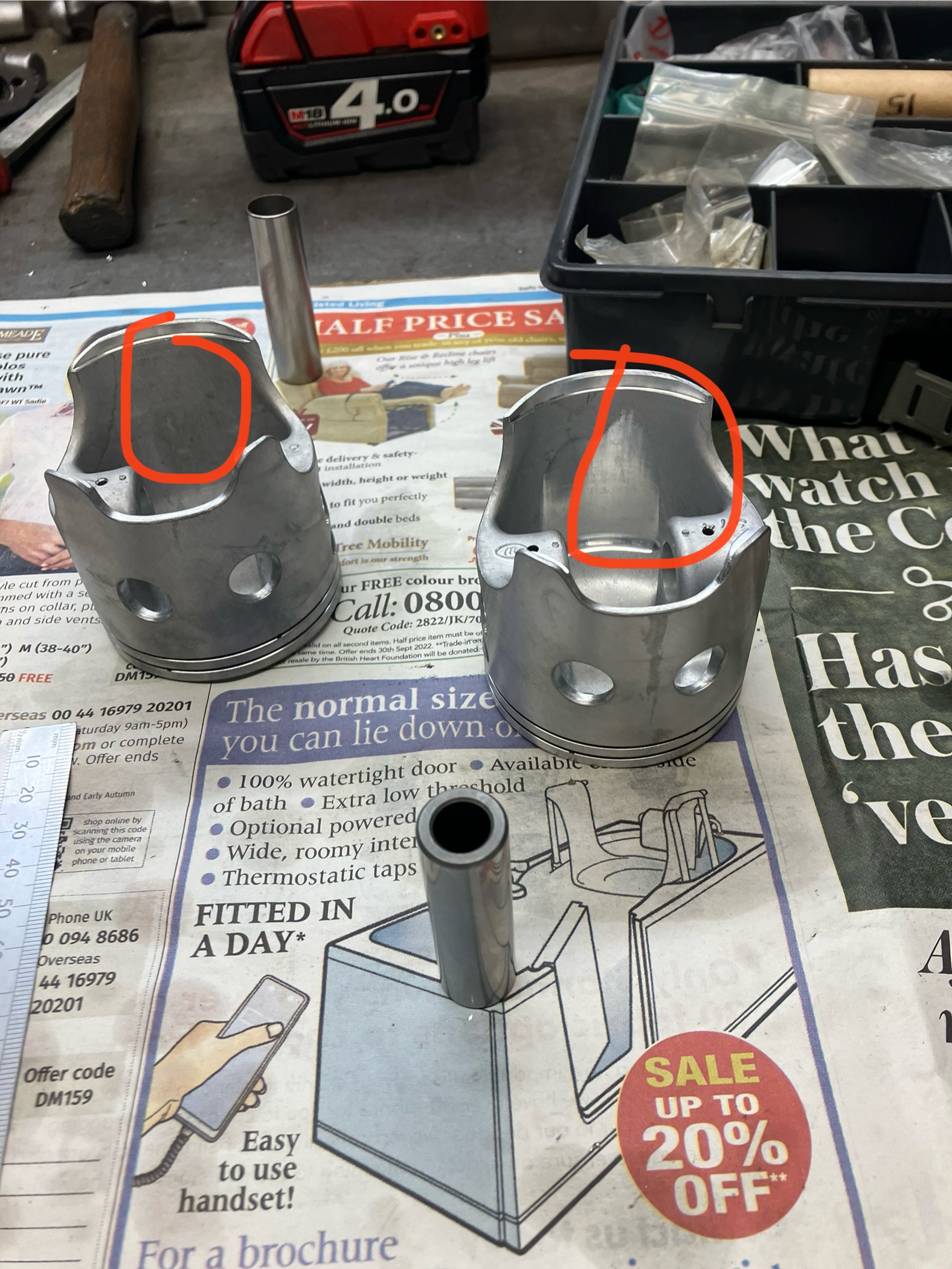

C) cut windows in the back of the pistons to suit the boost port.

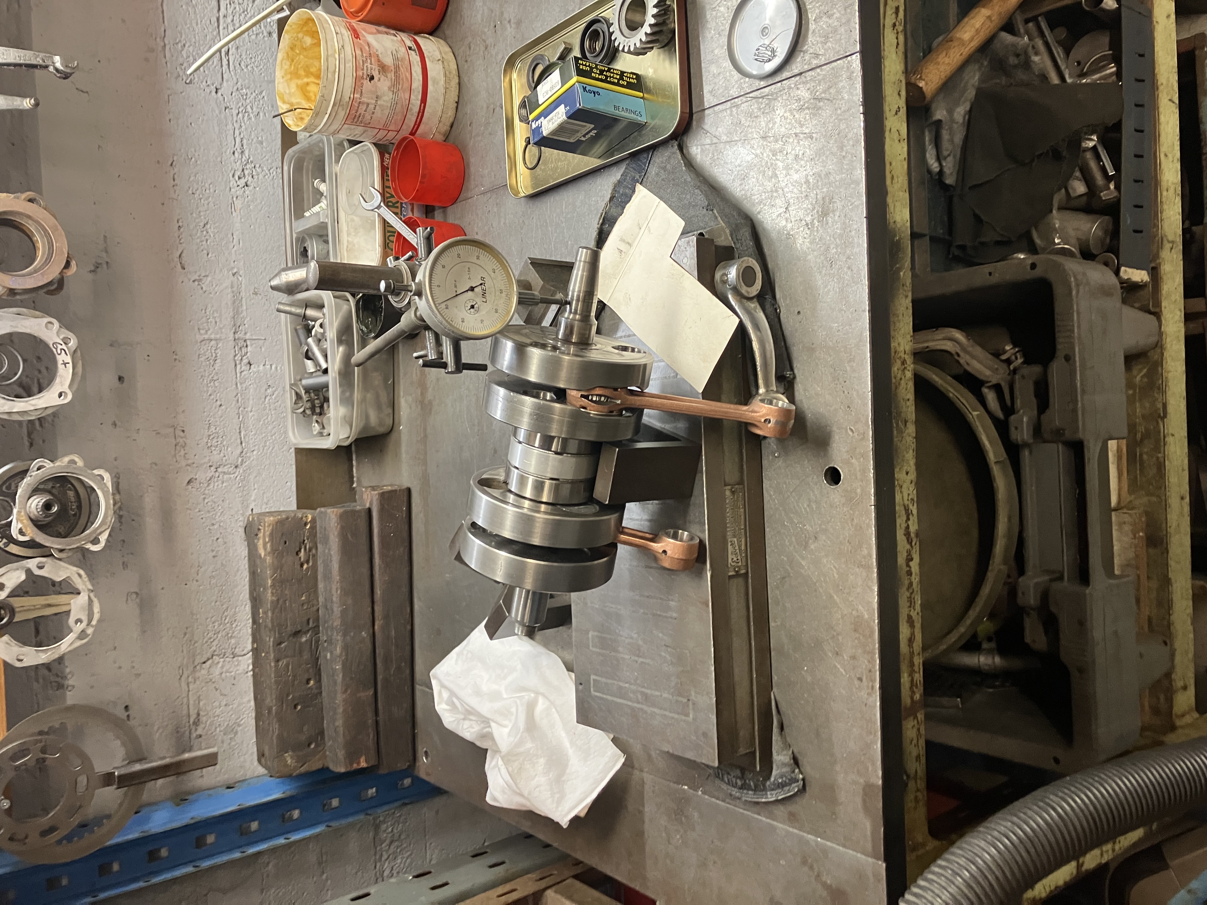

He said he would have the bits done for me to collect Saturday, but the crankshaft fought him for 3 days as it is getting old and sloppy from being taken apart too often in the past. Getting it to run true took him till Friday night so when i arrived we still had to do the barrels and pistons.

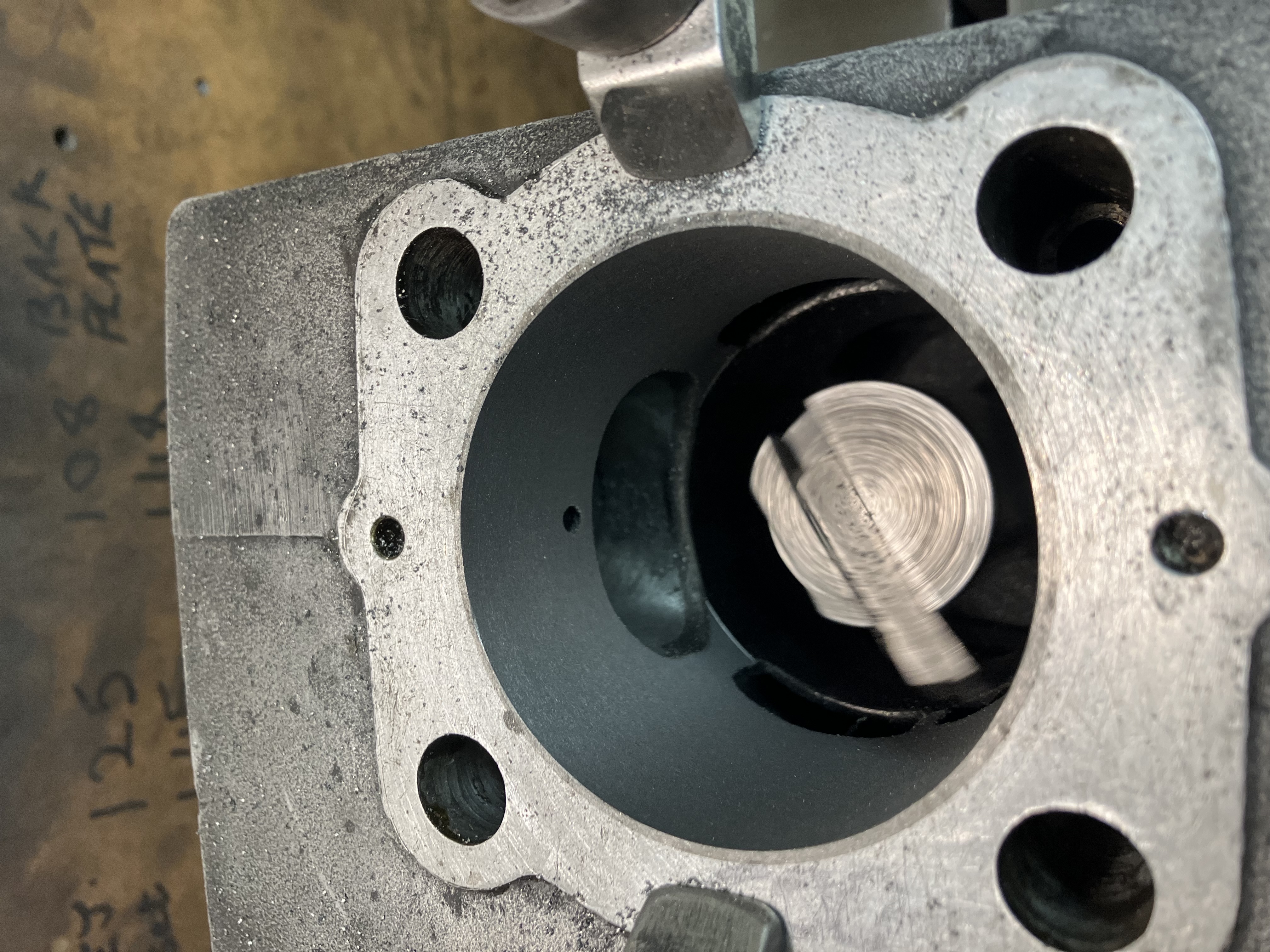

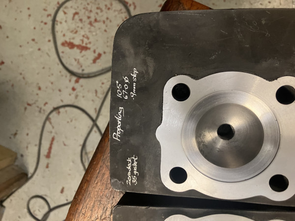

Once the bores were cut to the new size we dry fitted them with the piston (no rings) and new .5mm base gaskets to check the deck height and port timings on each side to see if they are matched.
Harry wasn’t happy with one exhaust port higher than the other and some variations in the transfers, so he scribed a line where he wanted them to be and got his porting tools out to cut them to the new height and shape.
Then he started the honeing process to get the piston clearance up to 0.0025” and a good surface finish for the rings to bed to.
This should have been easy but the large ports keep catching the edge of the stones and breaking them off the tool holder, so about 2 hr later we have the clearance right on both barrels!!!!!!!!!

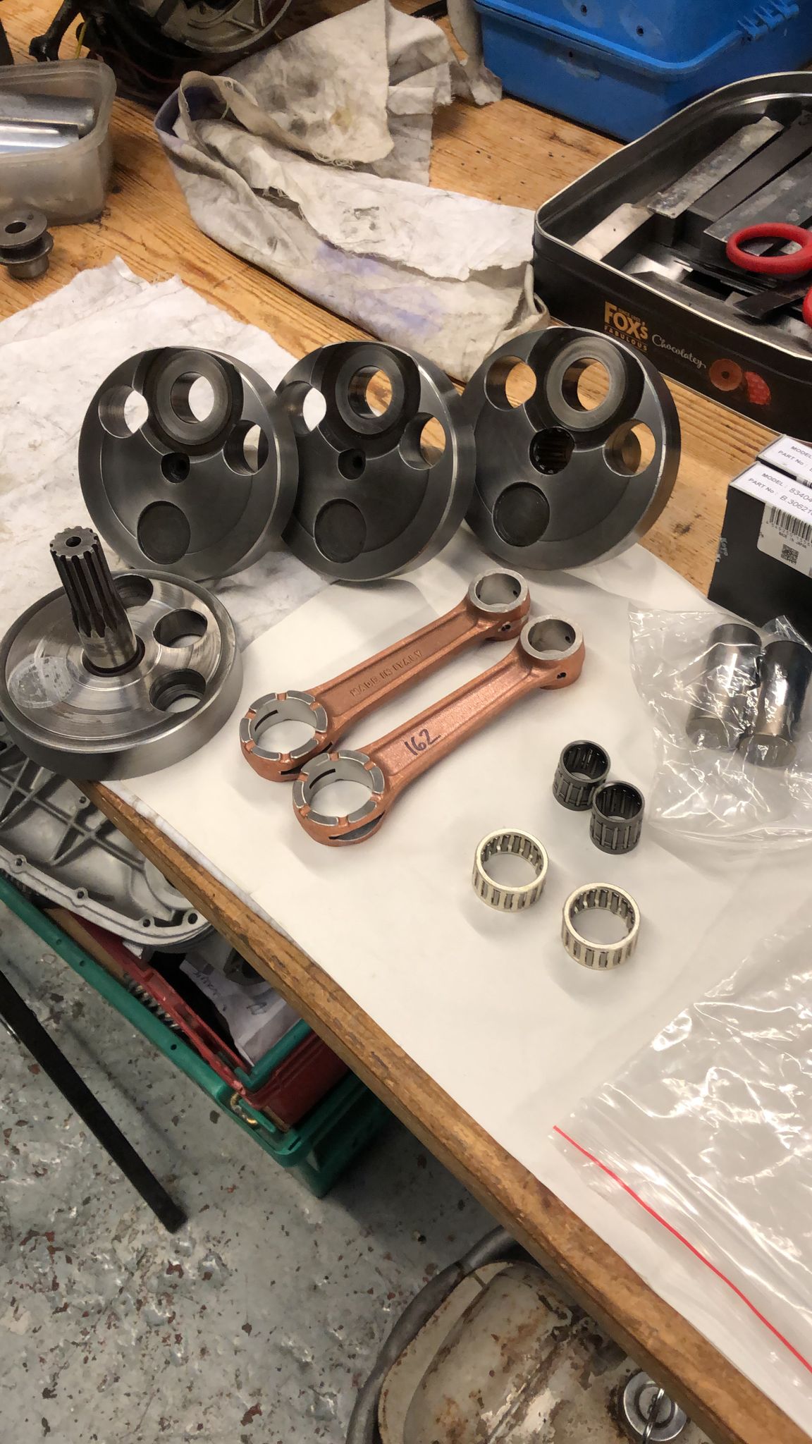

This was the crank waiting for assy with its new rods
Crank bits ready
Crank bits ready
Then once assembled checking the runout
Crank true
Crank true

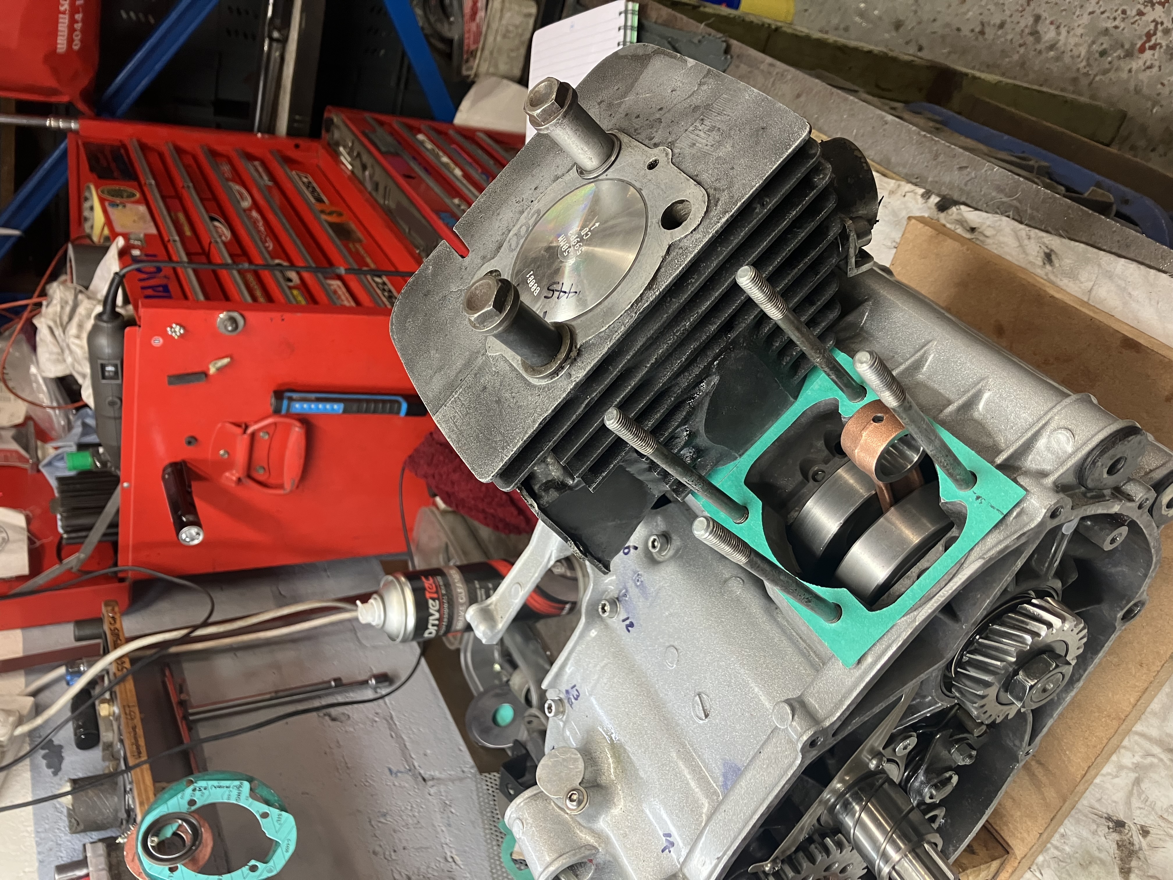

Engine together to check the deck height (how much the piston is above or below the top of the barrel)
Deck height check
Deck height check
Deck height check
Deck height check
Adjusted the transfer ports
Fixing the porting
Fixing the porting

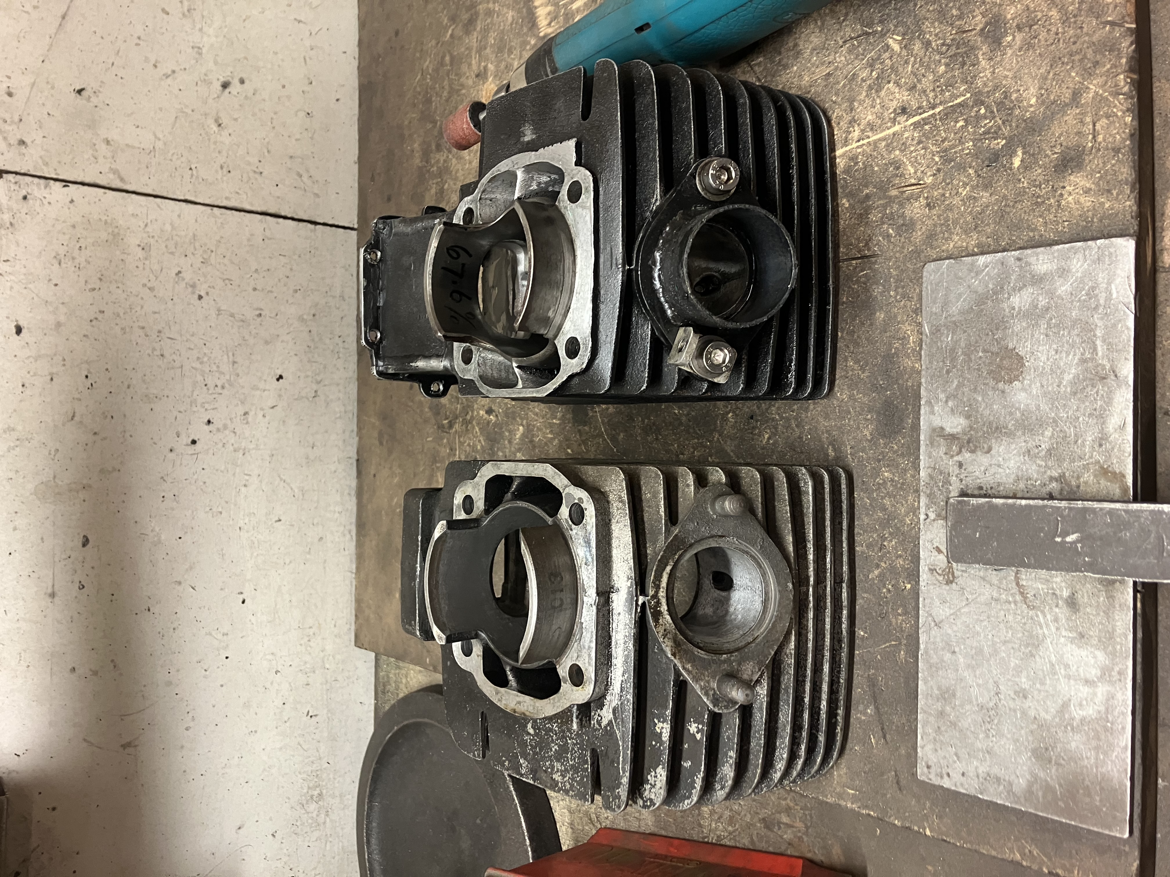

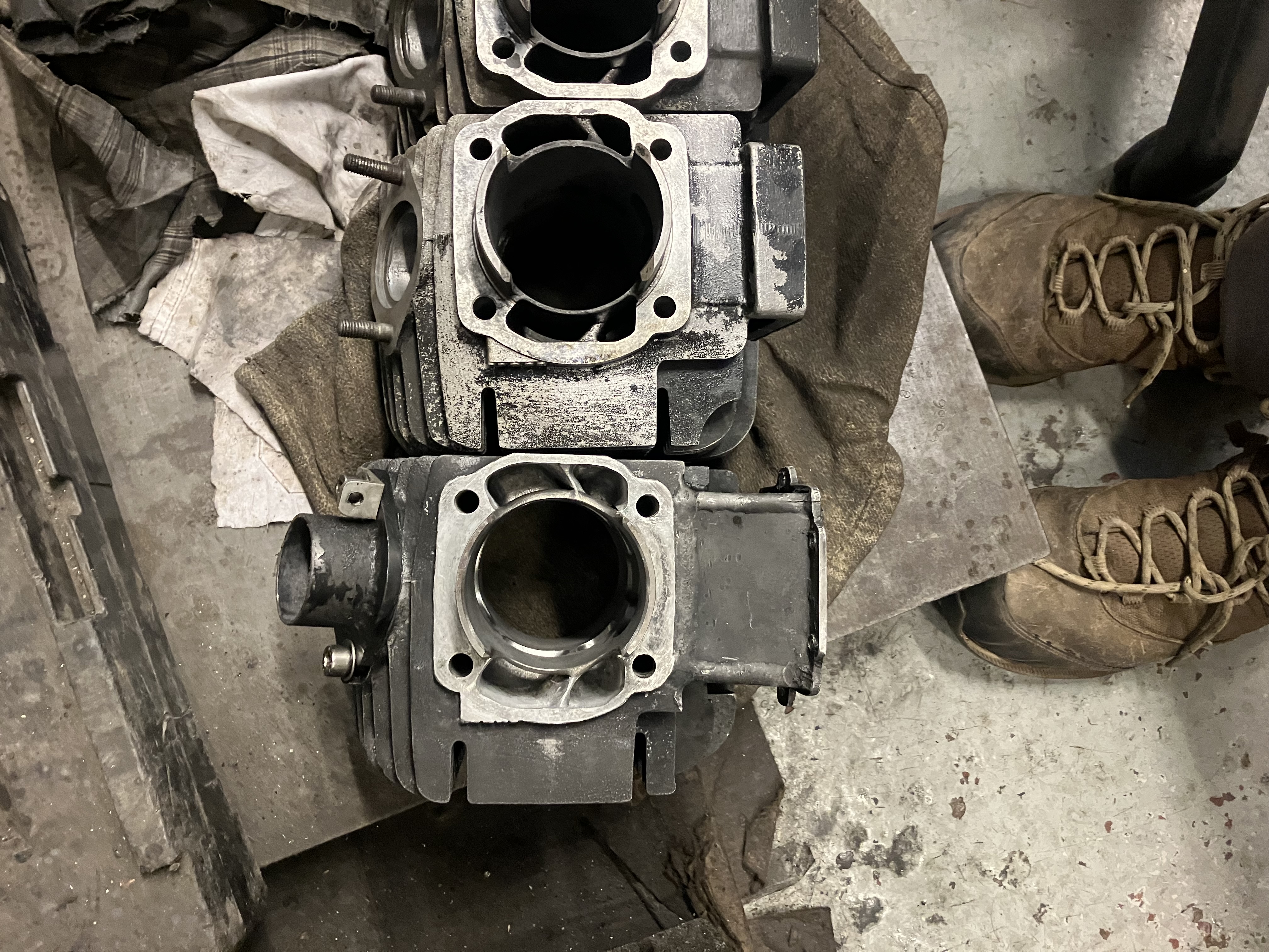

And I noticed some std rd400 barrels so it was interesting to see the difference
Std RD 1
Std RD 1
Std RD2
Std RD2

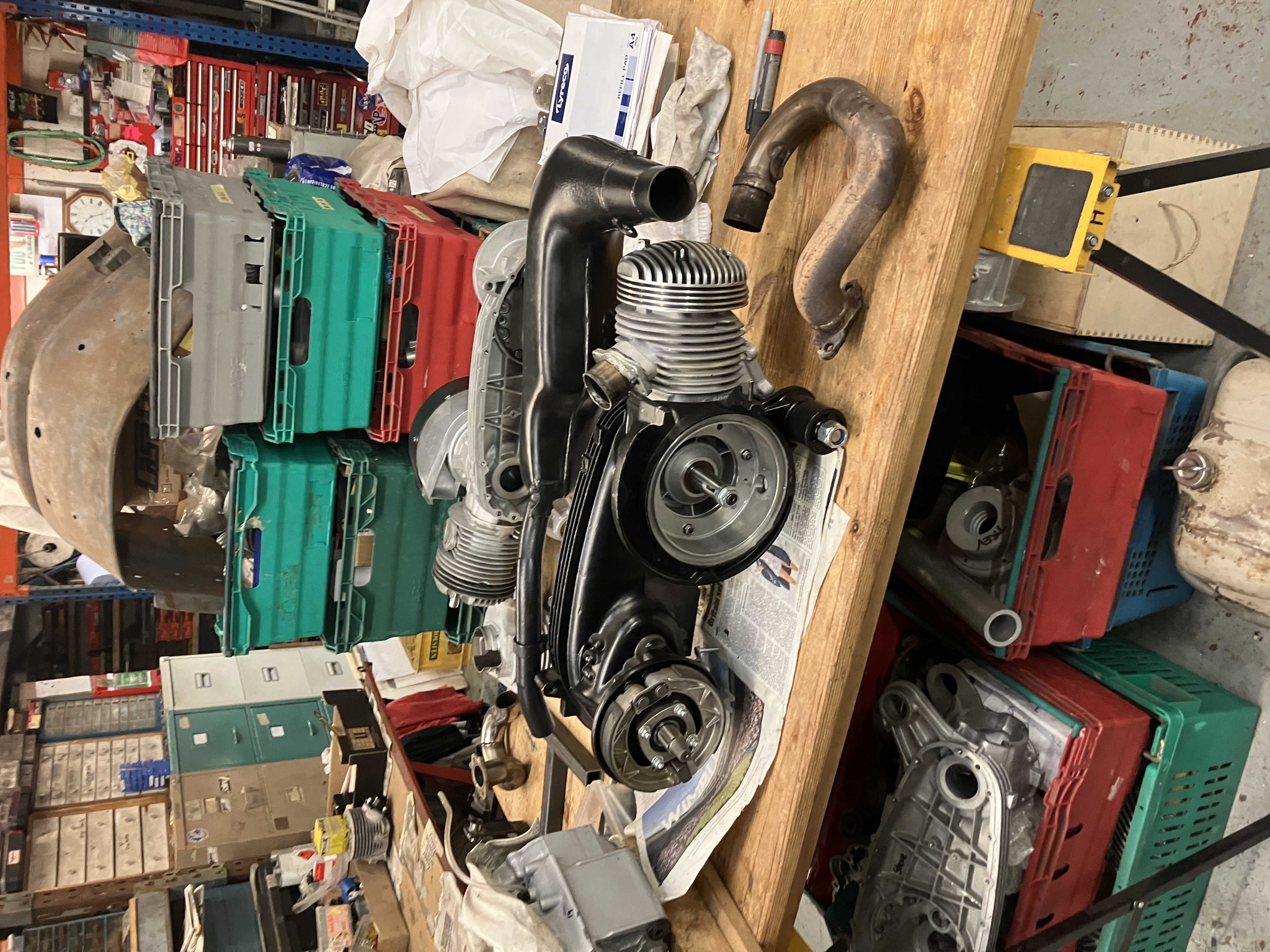

And as he makes most of his money in scooters now, here is one of the street tuned Lambretta motors with special barrels and his billet head
Lambretta 225 special

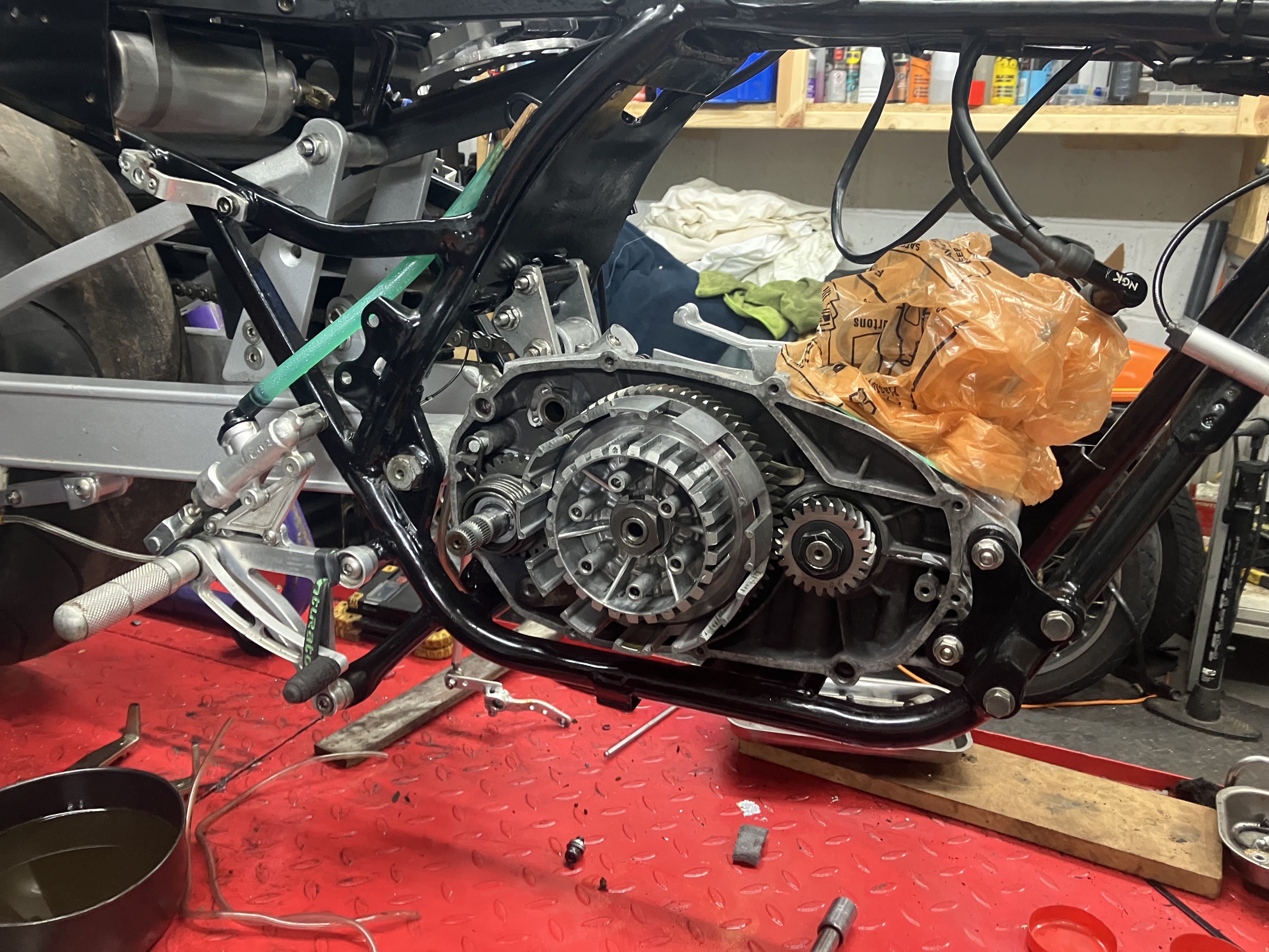

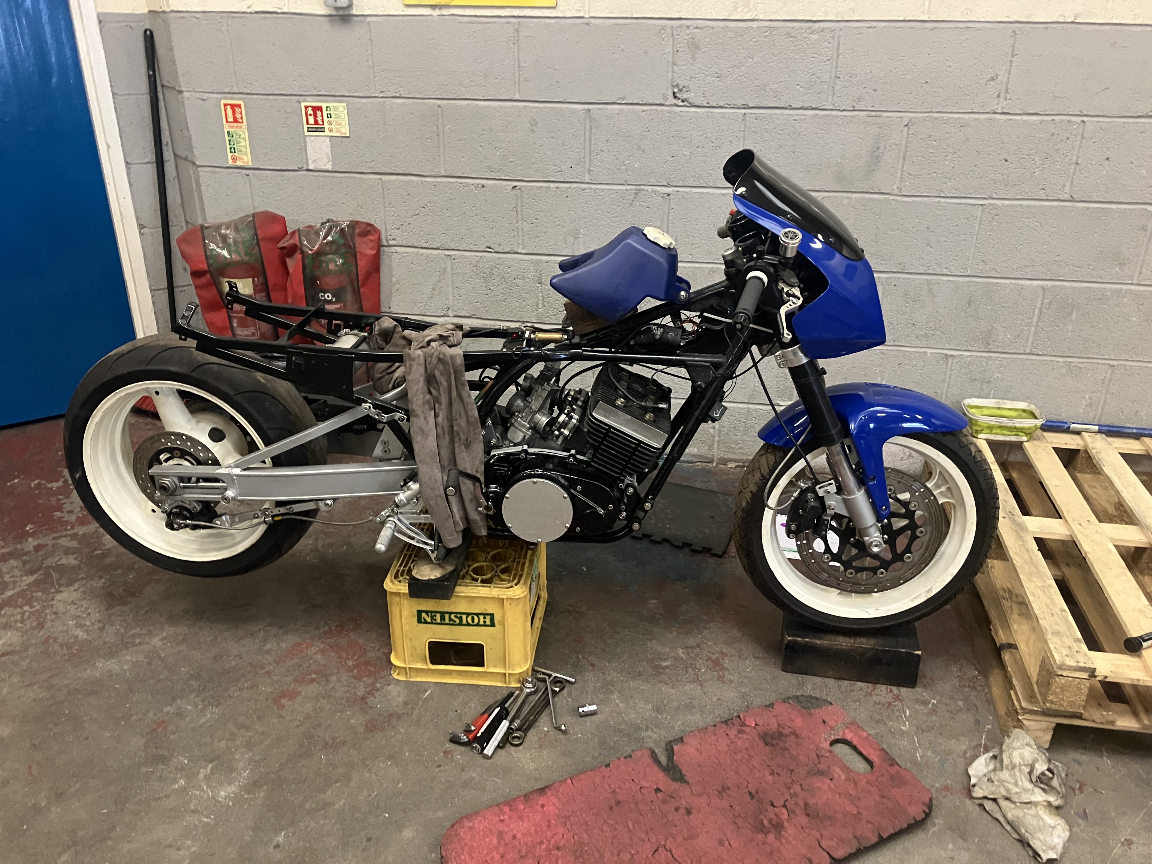

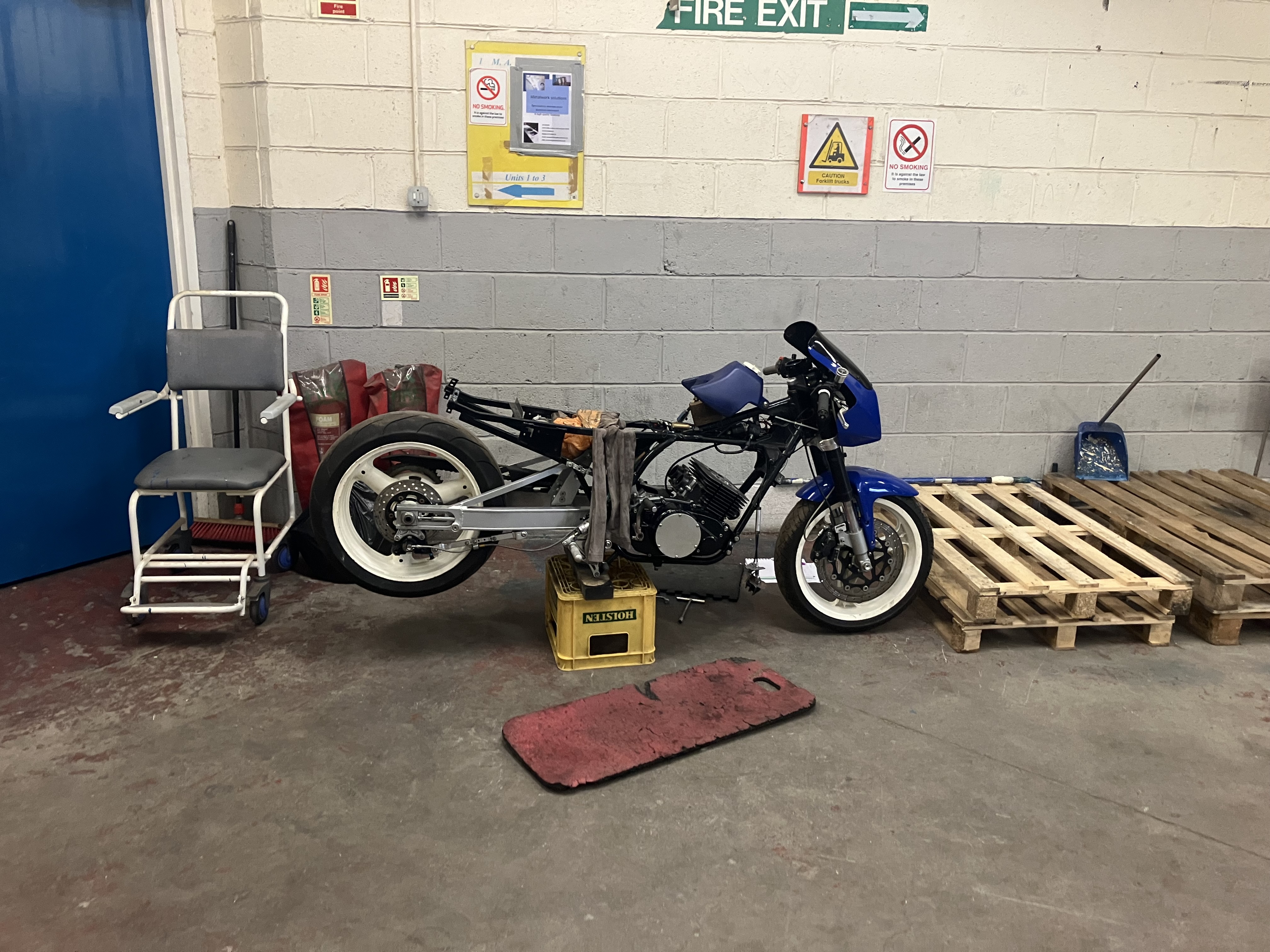

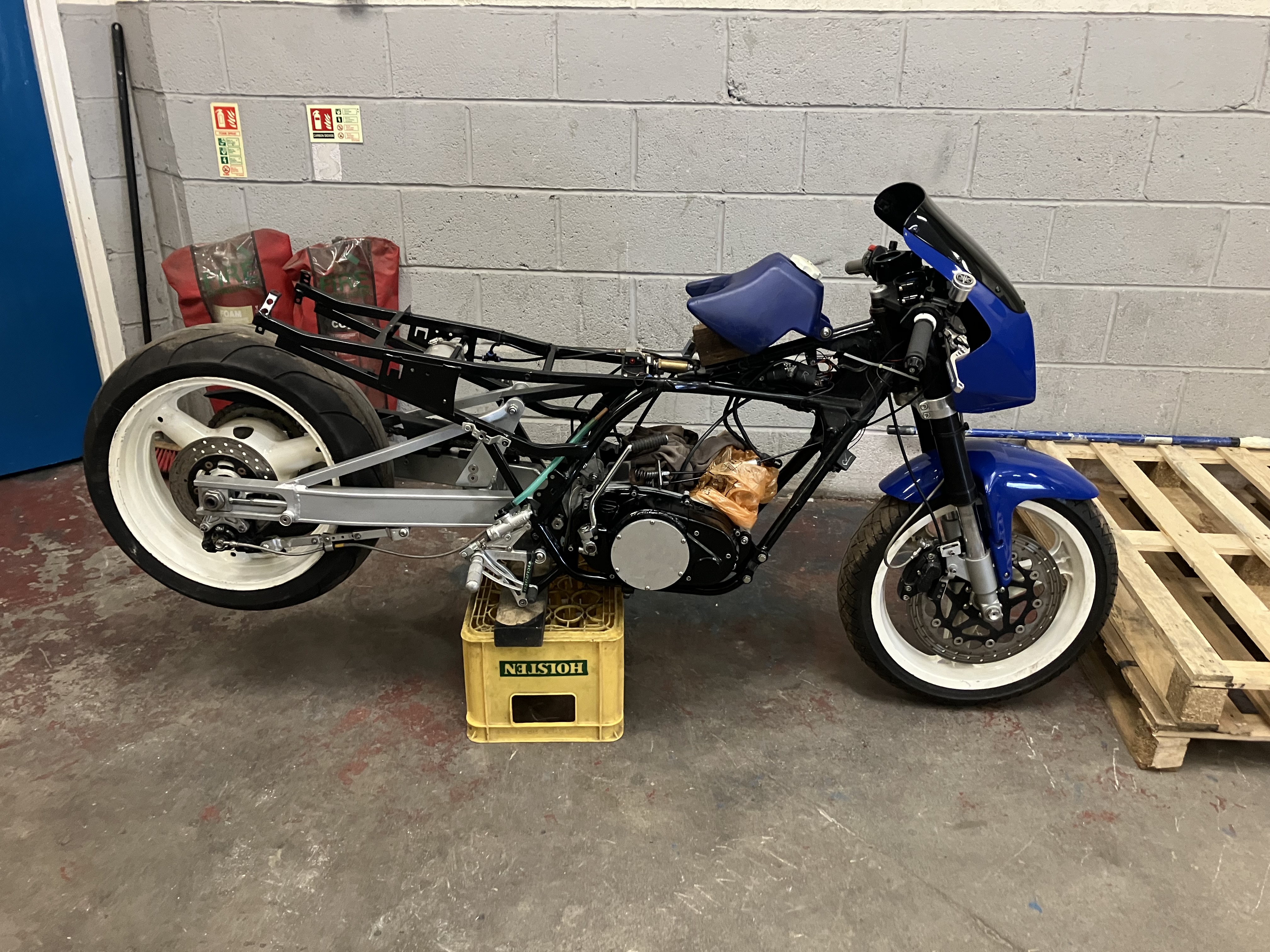

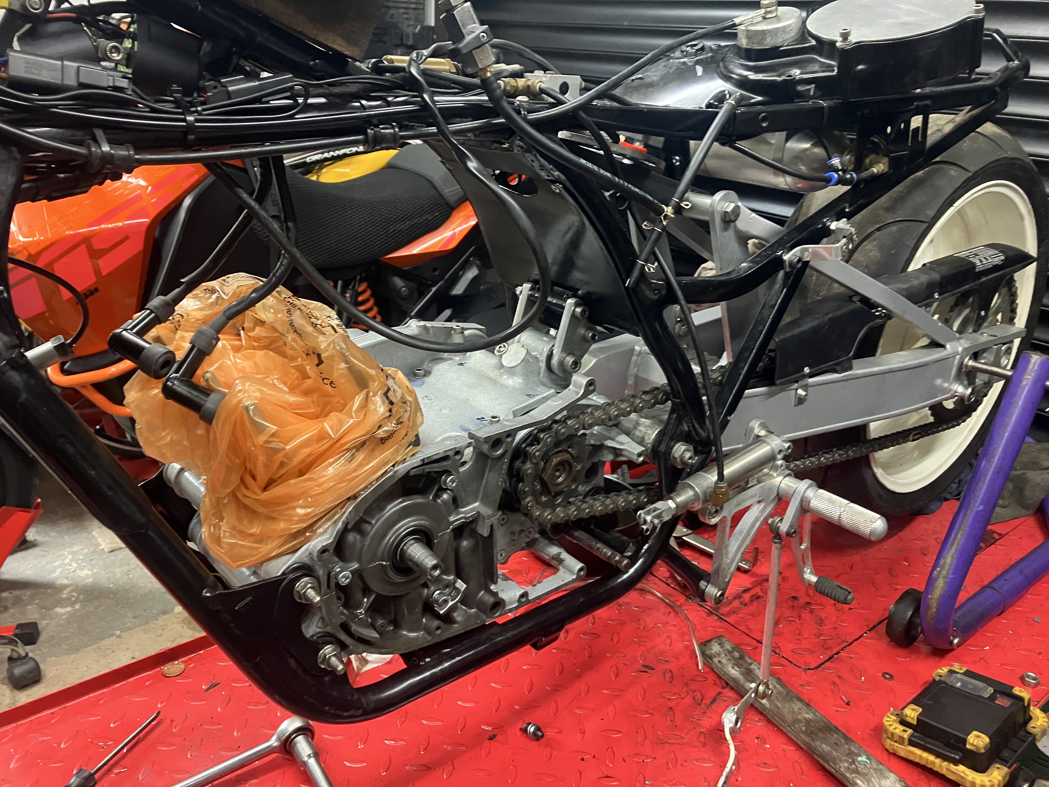

Back in the frame now
@Sirch345 …….. look….. more rubber bands on the back brake pedal,
