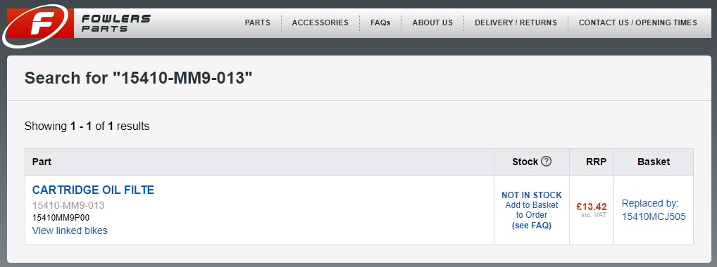

I remember querying that very same question at my local bike shop some years ago, when I was given a shorter filter than the normal Honda OEM oil filter that I had been using for years. They said the older style (longer filter) had been superseded by the shorter one. So that is what I have been using ever since,
PS. Back again. Fowlers even say it's been superseded (click or tap pic below to enlarge):
