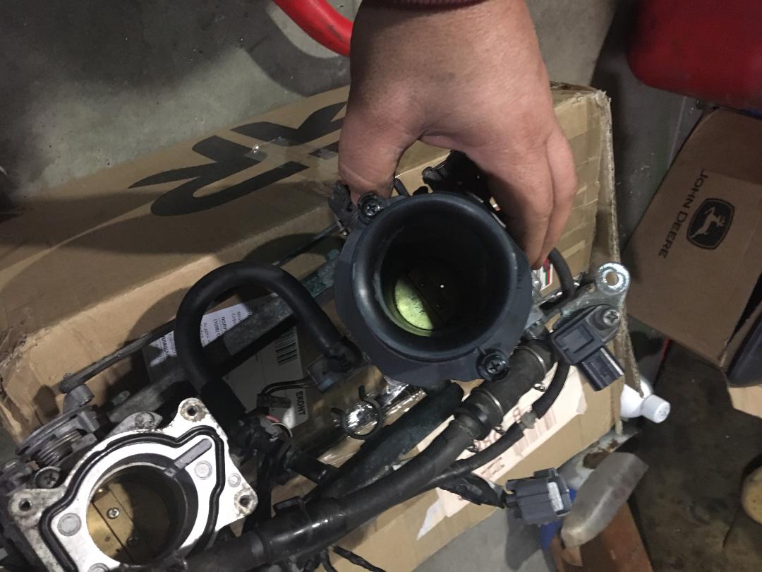

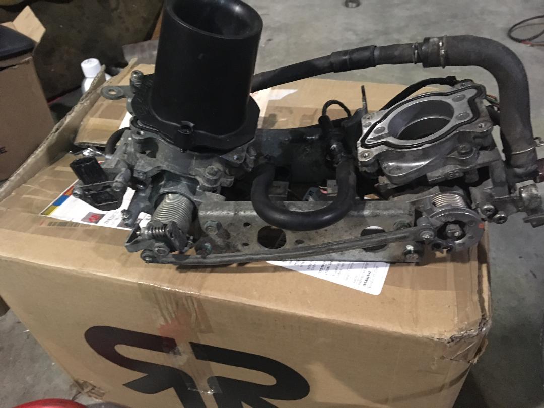

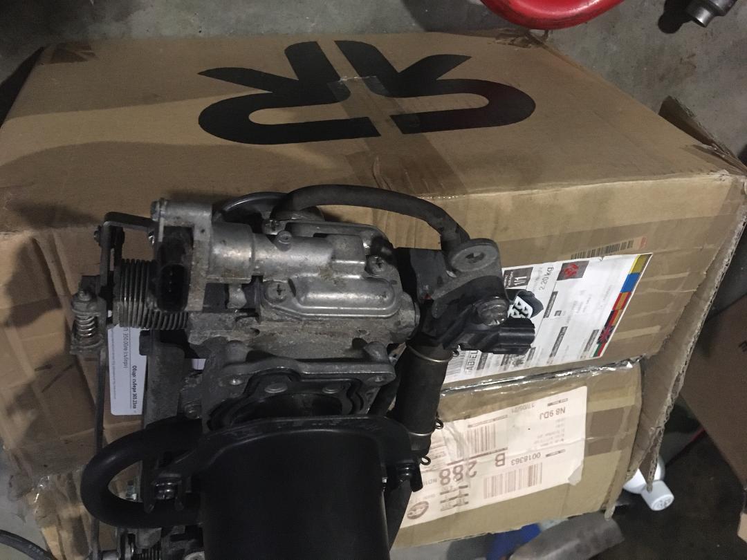

hm..I receive tb from varadero and yes they are small. They have really long velocity stacks ... build for torque :D . I bought them on line and when unpack them I call the seller and arquied with him - why he remove idle adjustment wire/cable - he said there was no one. I check the bodies and found some strange device, obviously idle solenoid. Now I see that this bodies are from newer varadero..ABS

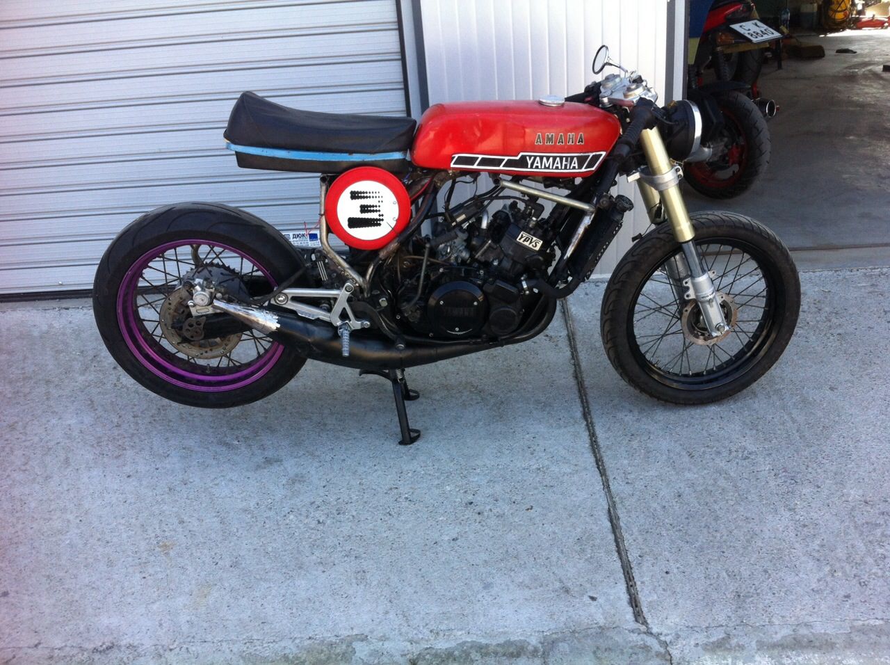

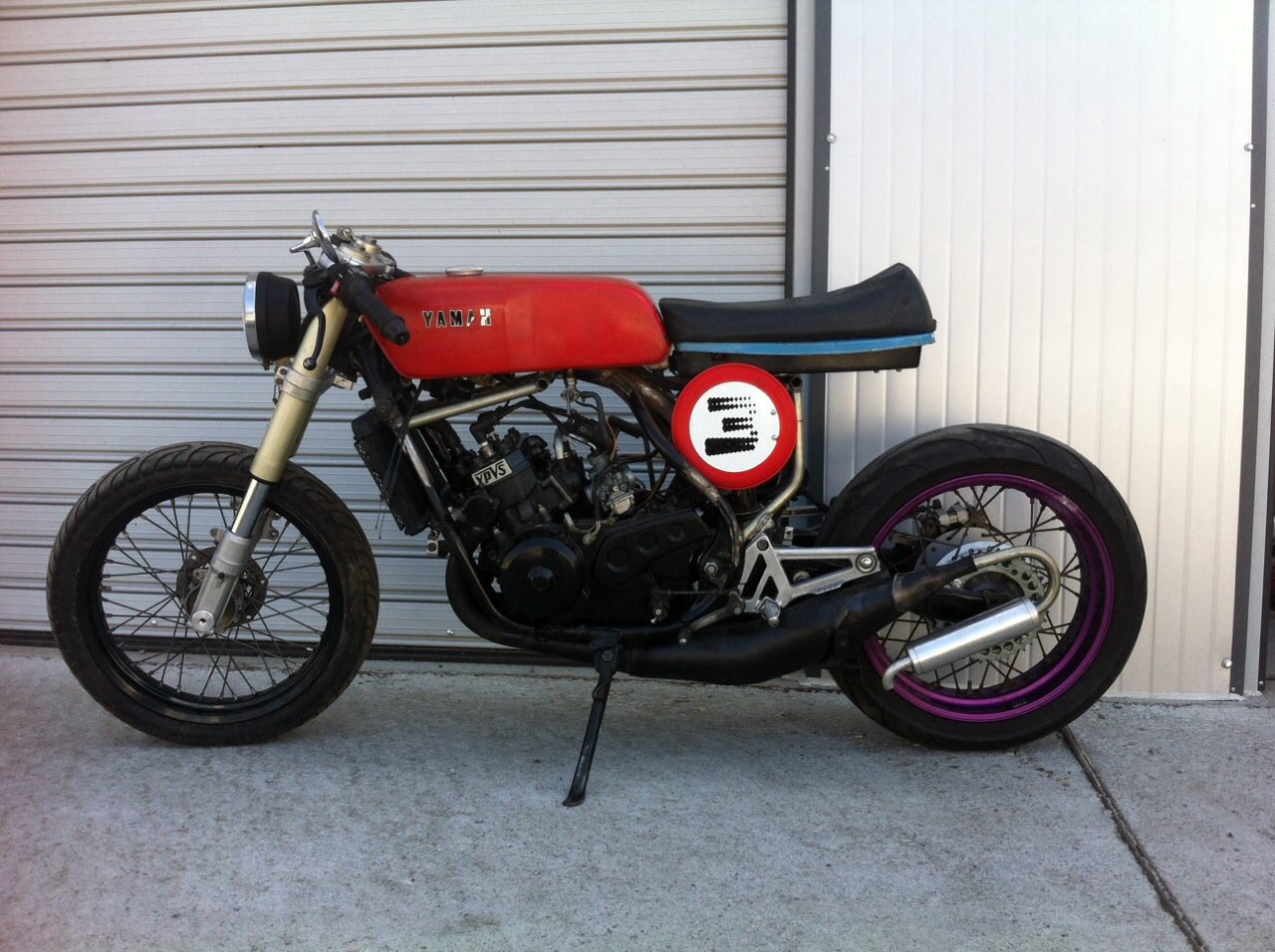

You mention couple of time RD350
Here is mine

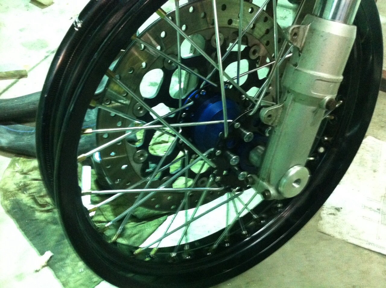

Post by gtecomp »
more pic's

Found another problem with the Varadero TB. Idle motor (that one that I was so happy)is actually stepper motor....which is a problem and most of the ECU's, don't support those. Probably I will change it to some solenoid from tank evaporating system of some car. But this is the future...tomorrow , the connectors for coils will come I can start with ECU wiring
