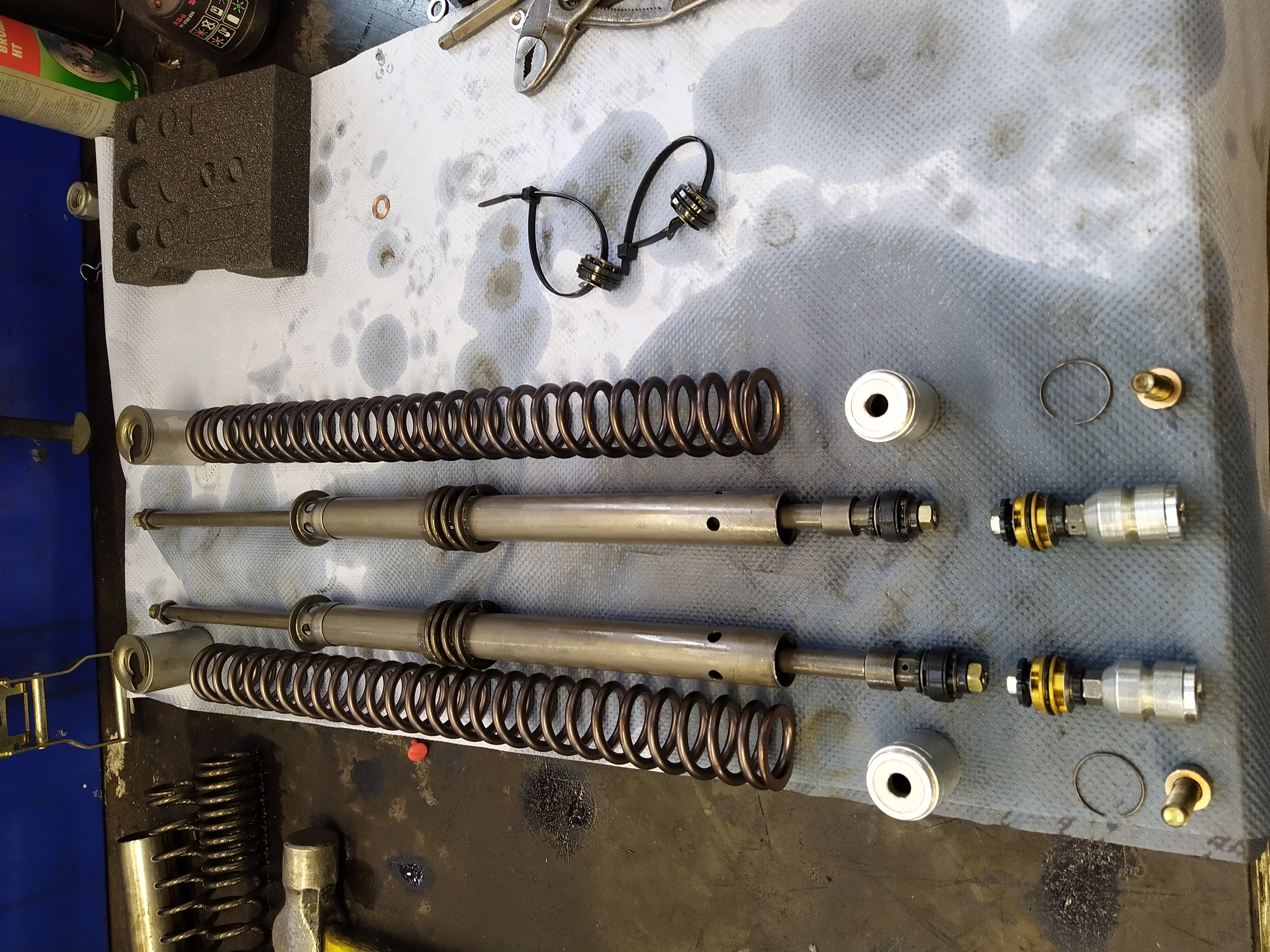

https://www.omniaracing.net/en/andreani ... 19907.html
There is a piston kit for VTR available, with suggested Ohlins springs and correct fork oil results are excellent. Only downside is that the assembly instructions are only an excel sheet containing sizes of shims and their placement. Shims were supposed to be laid in a correct order on the pistons but mine were not. It took me a while to set them but it was worth it.
