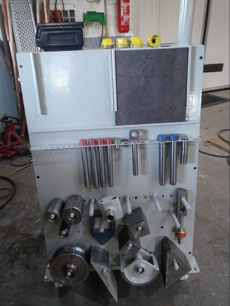

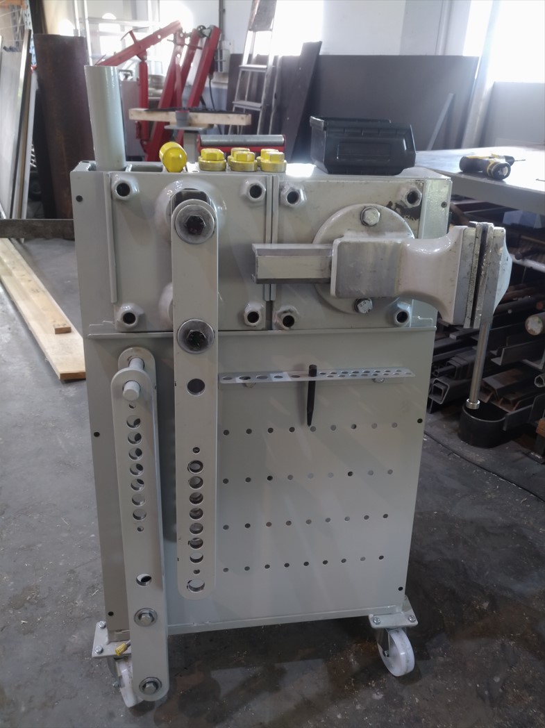

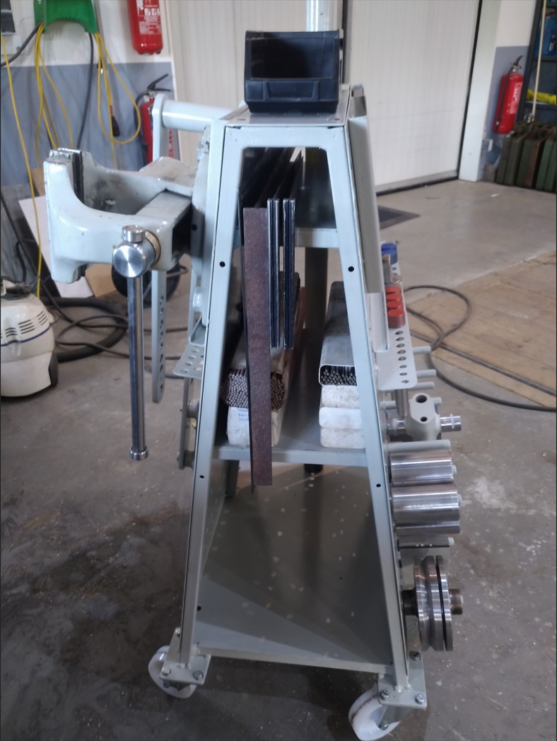

I know this is getting further and further from handlebars, but...
Finished the trolley. I use a 2 pack polyurethane for most things that I build, it cures quickly and lasts forever. I needed somewhere to store the clutter on my welding bench. Here's the result:
The square plates bolt to the corners of the welding bench and get held in place by 3 M24 bolts. Quick to fit, but once off the bench, I have a complete flat surface. The bench has an ungodly number of rawl bolts into the concrete wall behind it, so after years of struggling with floating benches, I finally have somewhere solid.
Happy with that, time for a beer! :beer:

That looks really heavy duty, good job :thumbup:
Much better to give you back your work bench, and being mobile you can move it to wherever you like 8)
