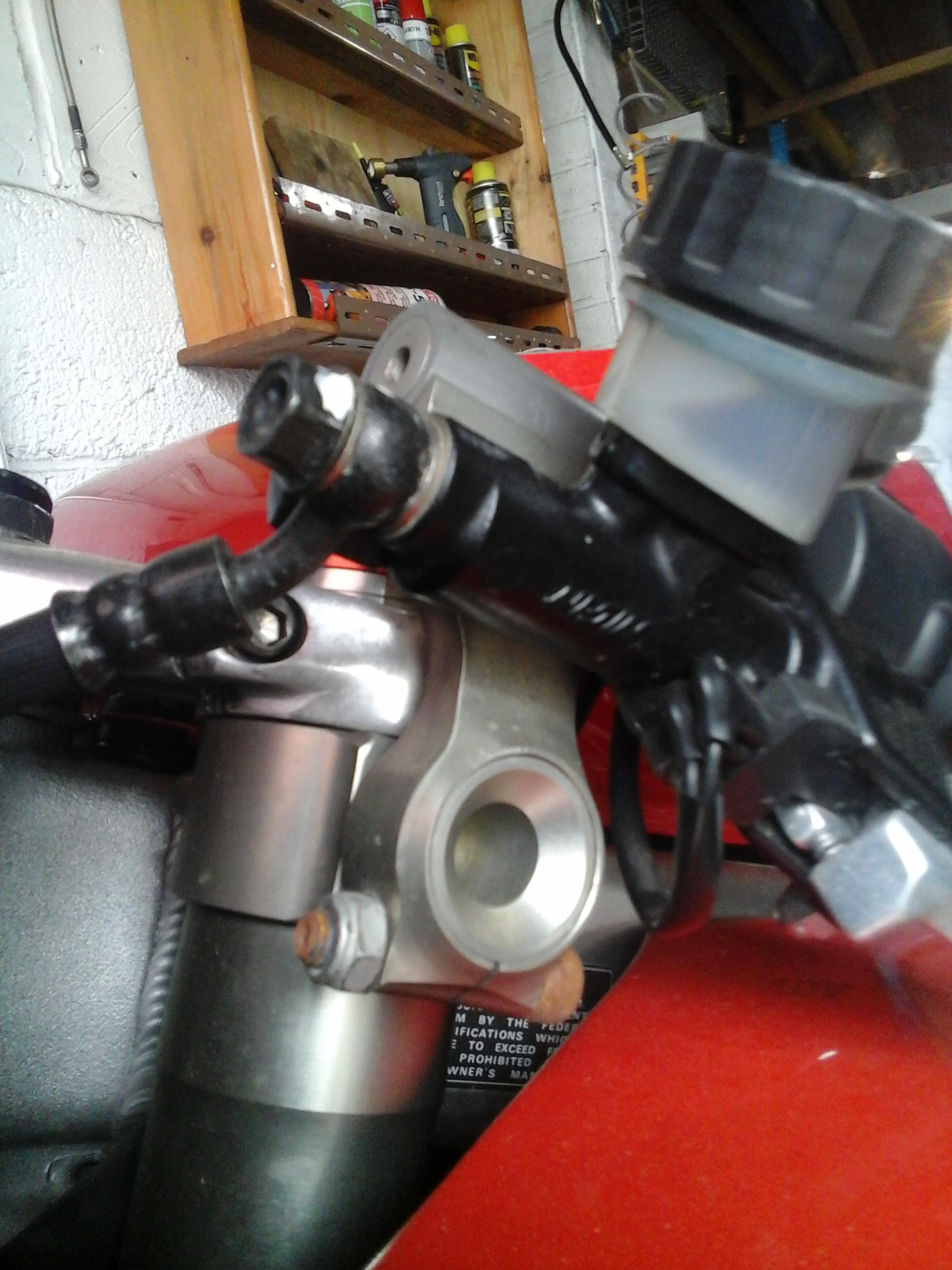

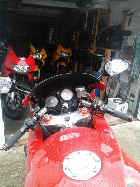

On the Ex Jones Storm with the EX Mons front end on it...I have Woodcraft ones fitted...Without looking I don't know if they are up or under the yoke...
Sure Tony will fill in the details...

CJ Storm.

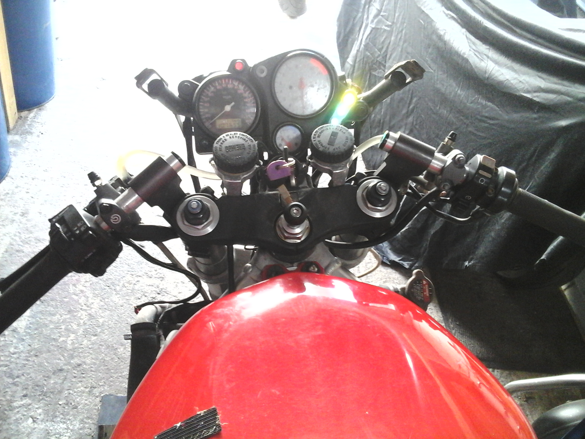

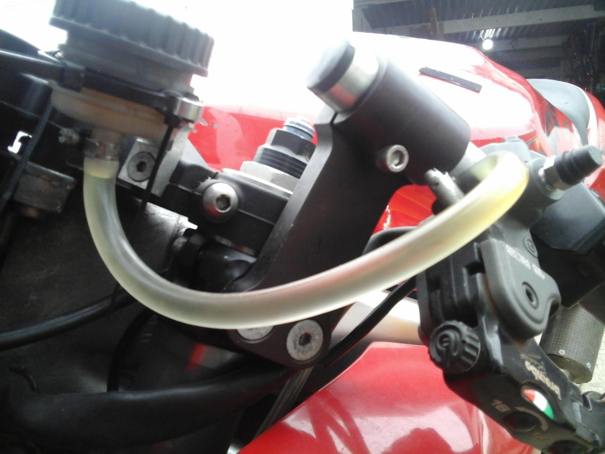

Red 633 has a 916 front end on it I think the bars are TBR...Deff under...

dont recognize the other ones on 633, but same question, what height rise?

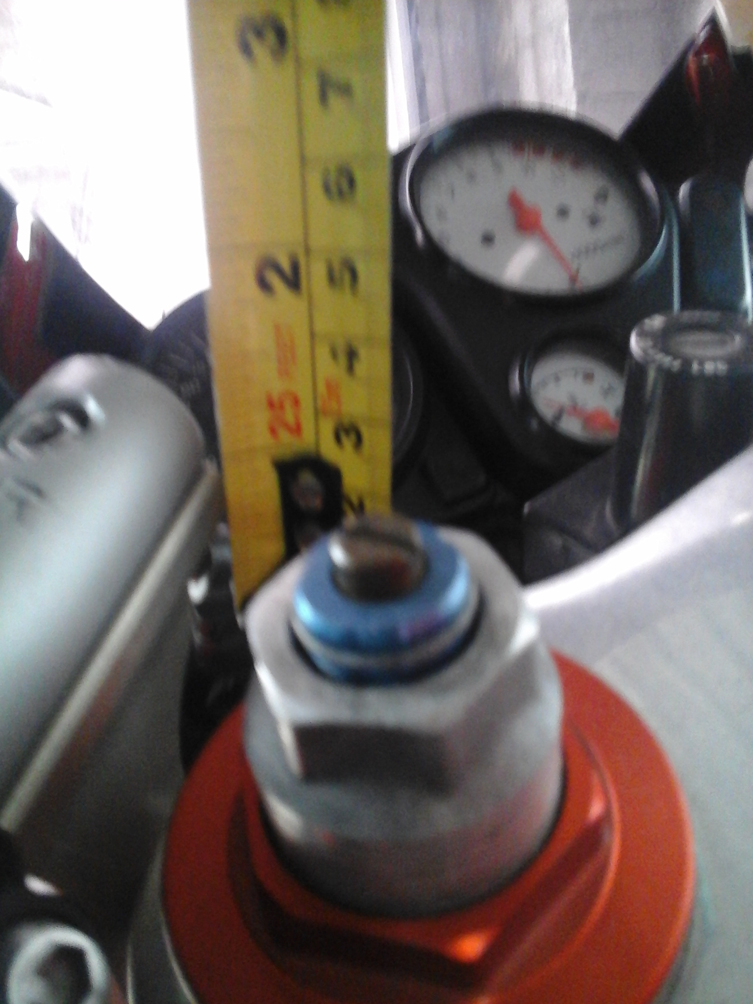

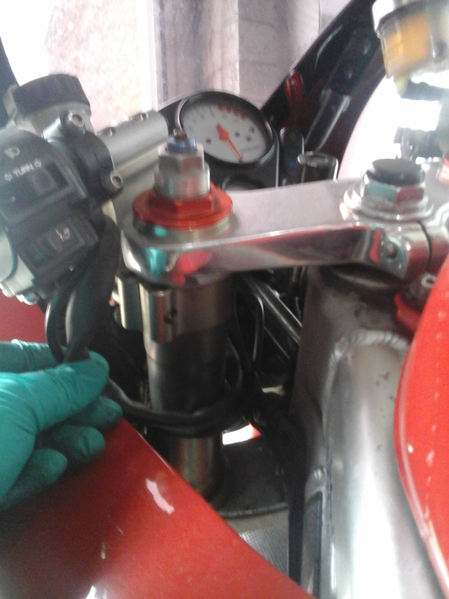

So I pulled my measuring stick out, after I pulled my finger out & pulled 4 bikes out to get to said stick...

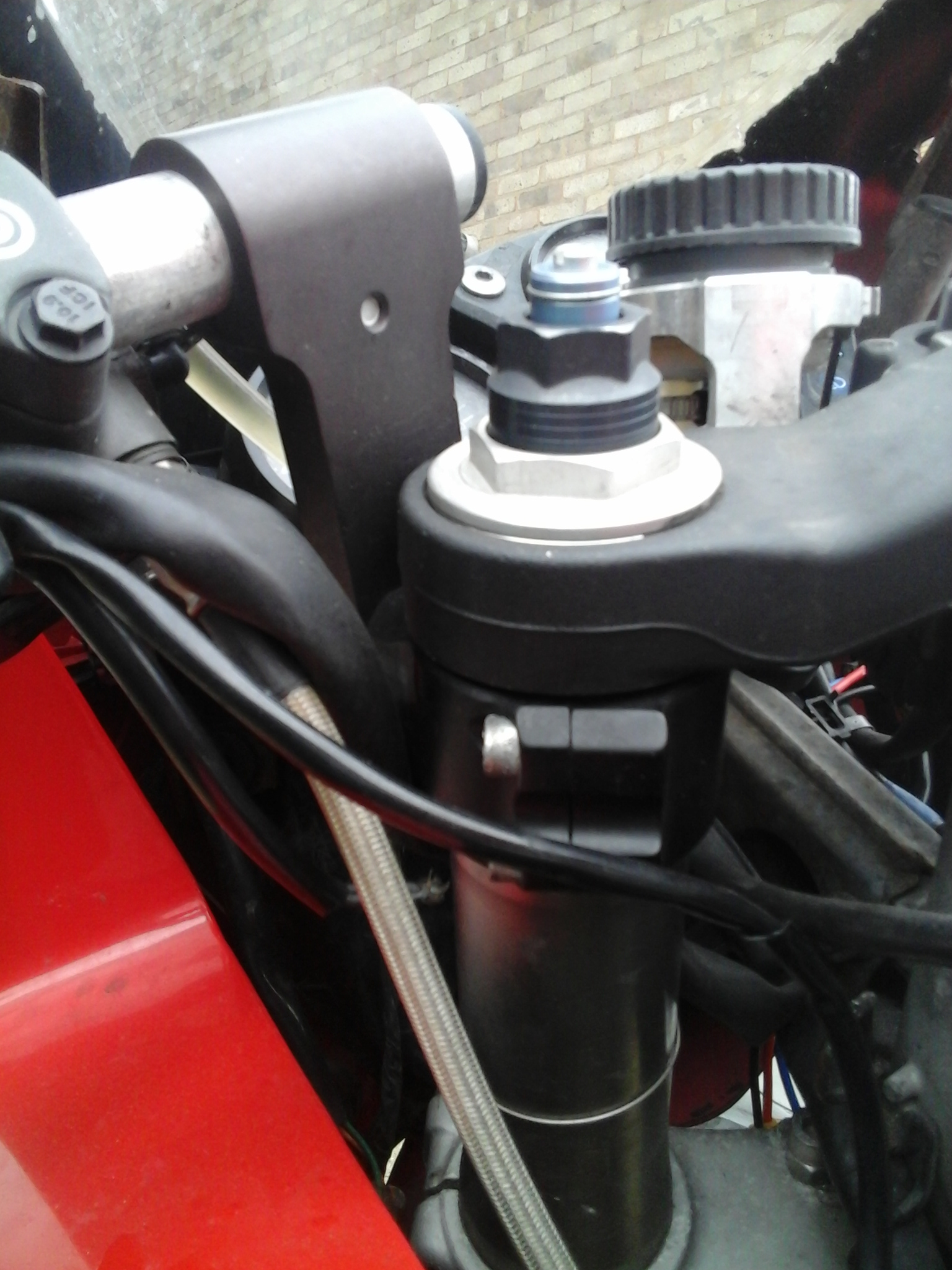

CJ Storm has Woodcraft bars with a gull wing yoke. Top of Yoke to tip of bar is 2".
These are USD forks BTW.
The width on these bar end to bar end is 29"

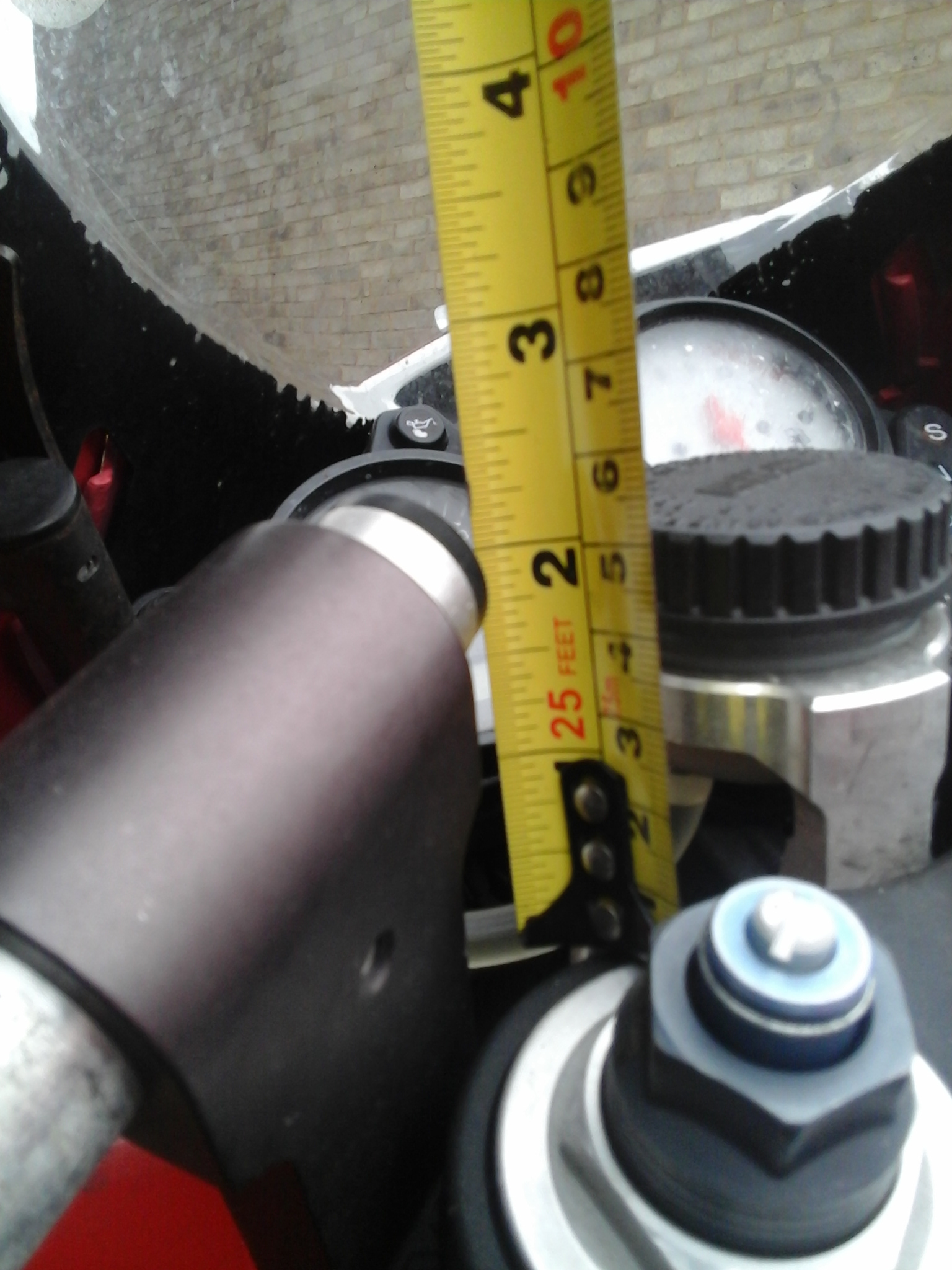

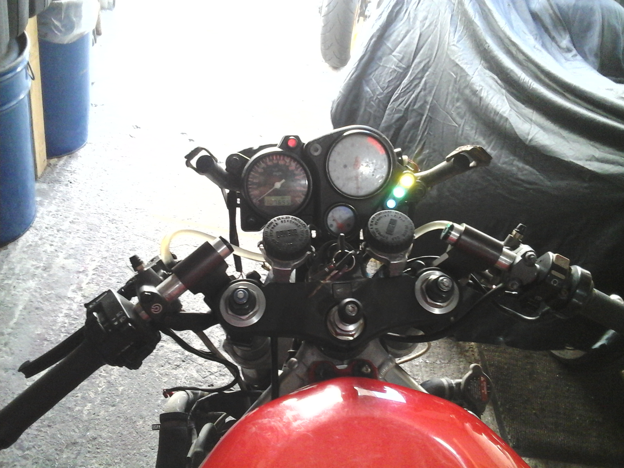

Red 633 has TBR bars but on 916 forks n yokes...
There is a rise of about an inch with these...
The width on these bar end to bar end is 26" but they are set funny the angles are all wrong & need adjusting for me.
