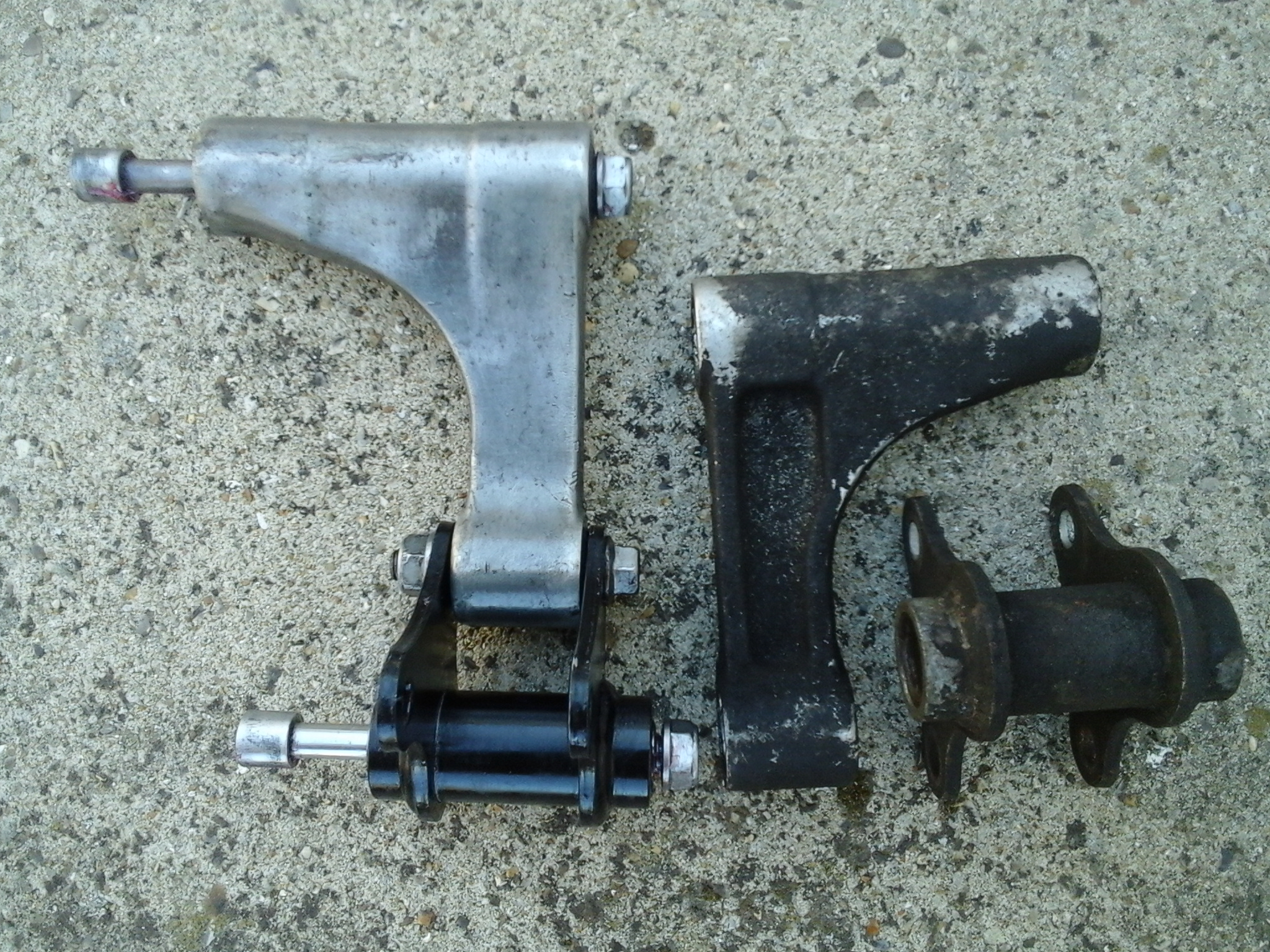

Done a few of these Mike. As long as it strips down ok, take the seals out & you should be able to see or better still feel if the bearings are any good or bad. The small end of the dog bone take a bashing as it's so close to the downpipe, so you may find it bone dry... The bracket to swingarm suffers as it gets all the crap & water of the road...well it does in the UK... :lol: :lol:
The sleeves/spacers/cushions can show wear or corosion & its a case of cleaning up & deciding if they are reusable or scrap. The bolts can corode on to the inside of said sleeves & again clean up or replace.
If you need to replace any of the hardwear then it the local Honda Stealer or parts site. For the bearings & the seals, if you have them a bearing factors will match them & be a lot cheaper than one in a Honda bag.
