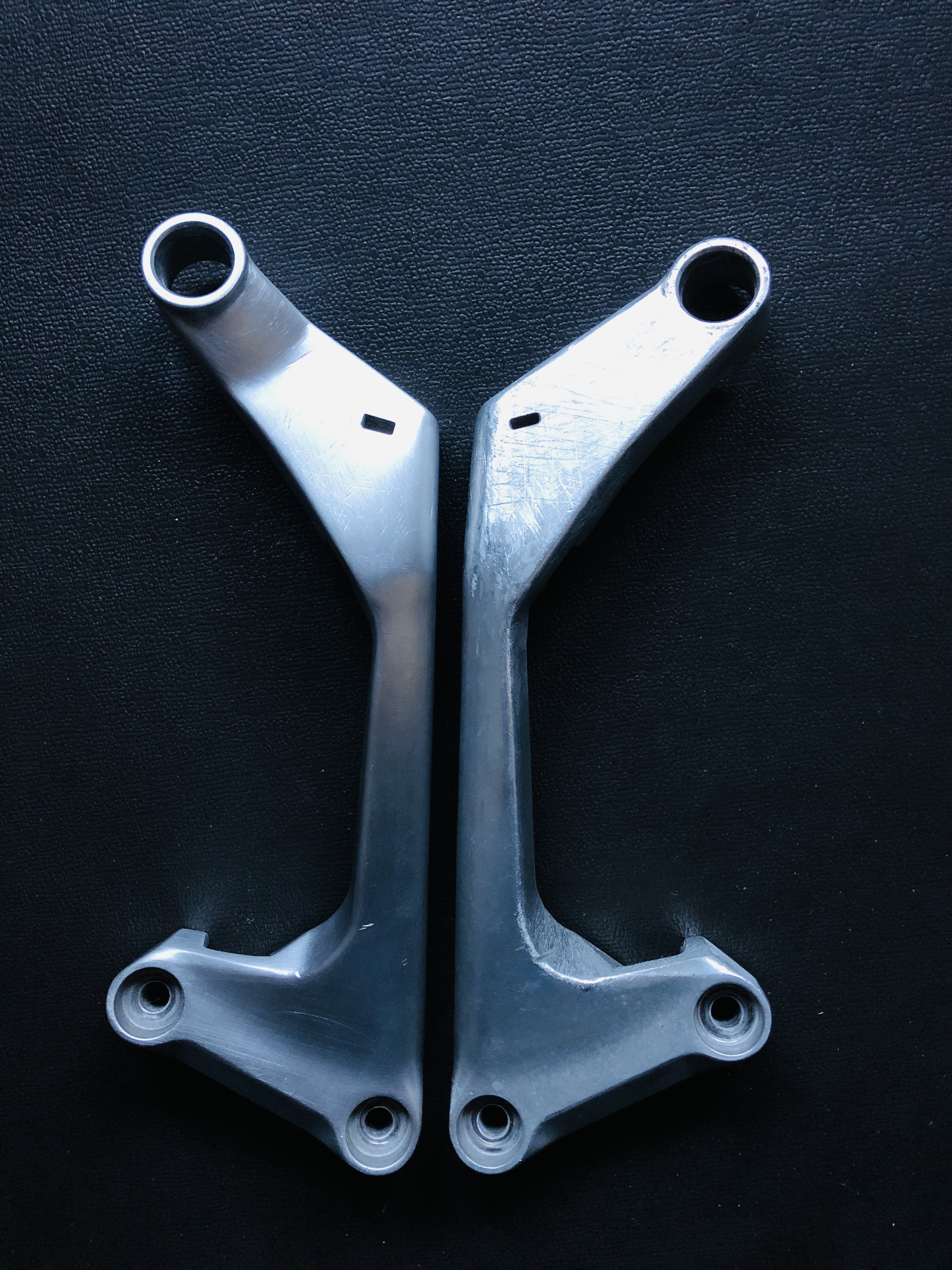

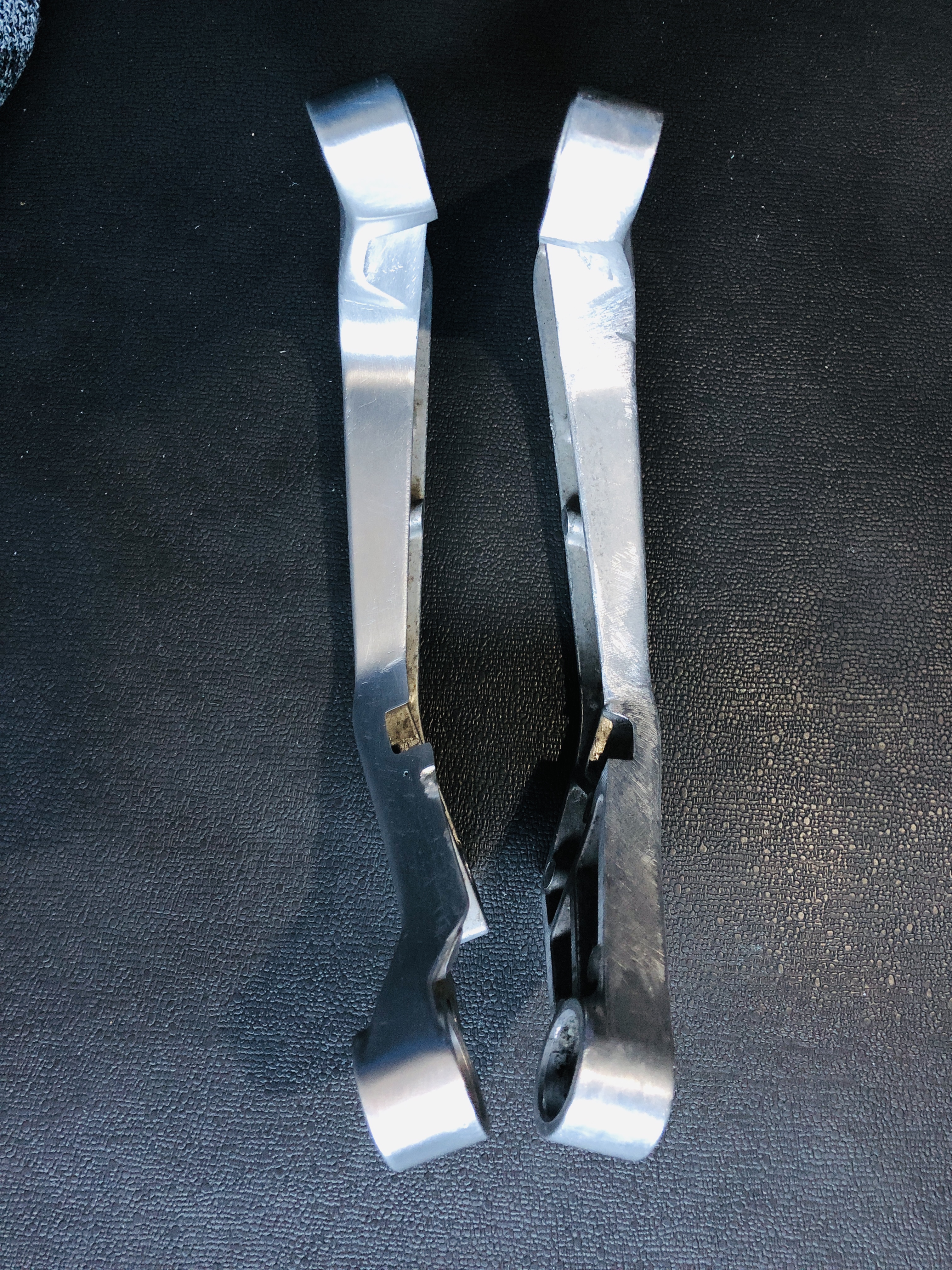

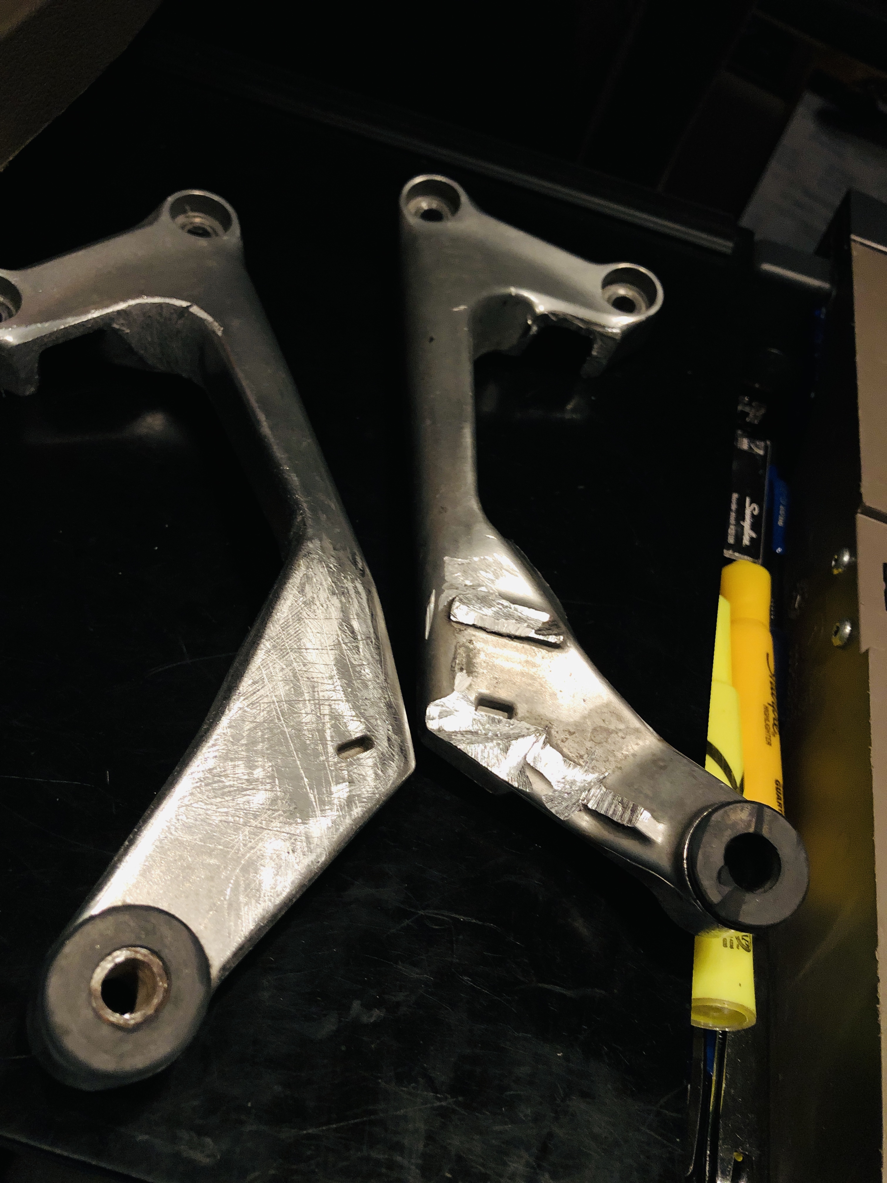

Well even though I'm on the freight shaker I'm still making a bit of progress on the rear peg delete/ muffler mounts.
I've got one finished and it's a bit rough but when I get home and sand and smooth it out should look good. :biggrin :thumbup:
Here's a couple of pics of before and after.
I still have the other to do and probably the harder one to get right.

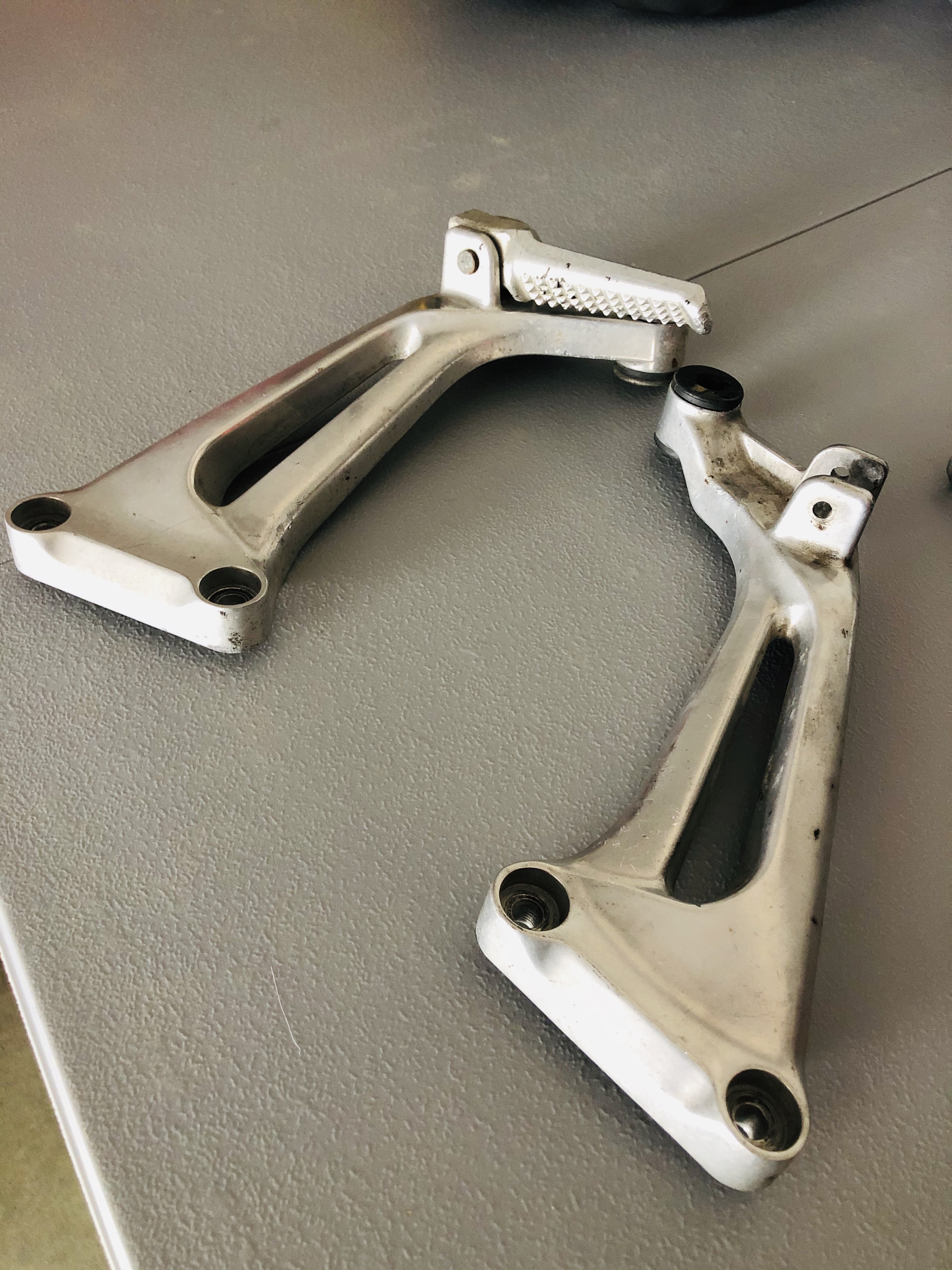

This should be the stock mounts. Nice but a bit bulky if you'll never have a passenger.
All cut up and ready for filing down.
This one done and ready for sanding.
Let me know what you think. :Whistle:

Different look. Marty had something similar done on his first Storm back in about, 2010 I think. His weren’t quite as reduced as yours but they looked good on the bike. Well done,

Kev L wrote: ↑Wed Nov 25, 2020 8:36 am Different look. Marty had something similar done on his first Storm back in about, 2010 I think. His weren’t quite as reduced as yours but they looked good on the bike. Well done,
Thank you sir. :thumbup:
I wanted it to stay stock but with added touch and also something different. I enjoy working metal like this and plan on doing the magnesium sprocket cover as well. I have a spare of that too. :lol: :wink:
I've had a ton of inspiration of what I want the sprocket cover to look like so we'll see how it goes.

Not a fan of a cut down cast one, they're not strong enough for pillion pegs, but too bulky for can hangers. What's wrong with a nice light carbon one?

tony.mon wrote: ↑Wed Nov 25, 2020 6:55 pm Not a fan of a cut down cast one, they're not strong enough for pillion pegs, but too bulky for can hangers. What's wrong with a nice light carbon one?
Carbon would be nice but pretty expensive. 8O
I tend to agree with what you're saying about them being a bit bulky for just can hangers but I do enjoy working with my hands in making something different whether it on my car builds or this bike. I like being different and love different approaches to what I do. This is one of them. :thumbup: 8)
Most will never notice it's been cut down as it's really an unnoticed item by most people unless you're a SuperHawk/ FireStorm fan that would notice the difference. Also the feeling of saying I did it myself has a satisfaction to it when it's complimented. :Smoke3:
Where I live seeing a bike like this on the street is quite rare, if at all. All you see are inline 4 600's, Harleys, or 'Busa's roaming the street so I'm wanting to change the scene a bit with this build where I live.
I could have fabbed up a good basic aluminum bracket but you see those everywhere and a bit 'me too'.
I just hope the end result will turn out as I had envisioned. :thumbup:

I like your style :thumbup:

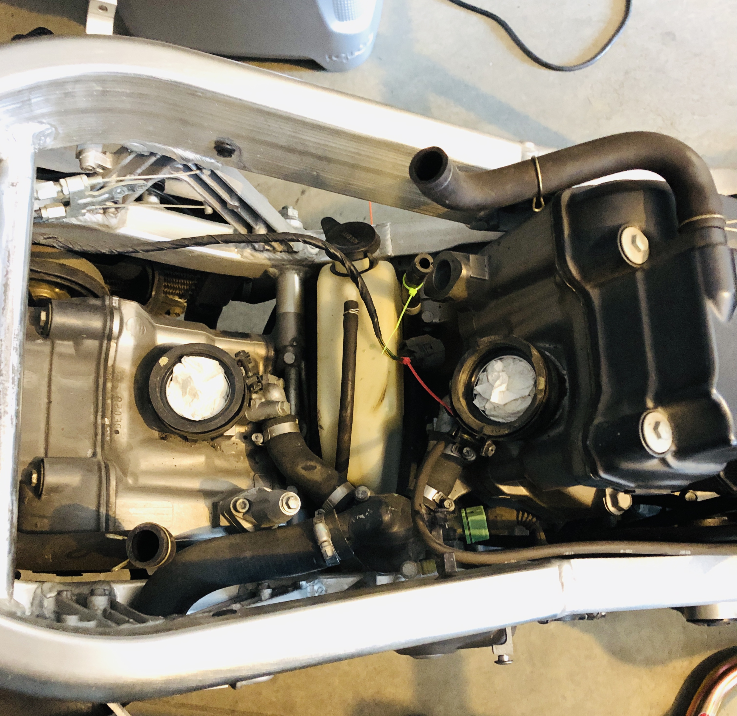

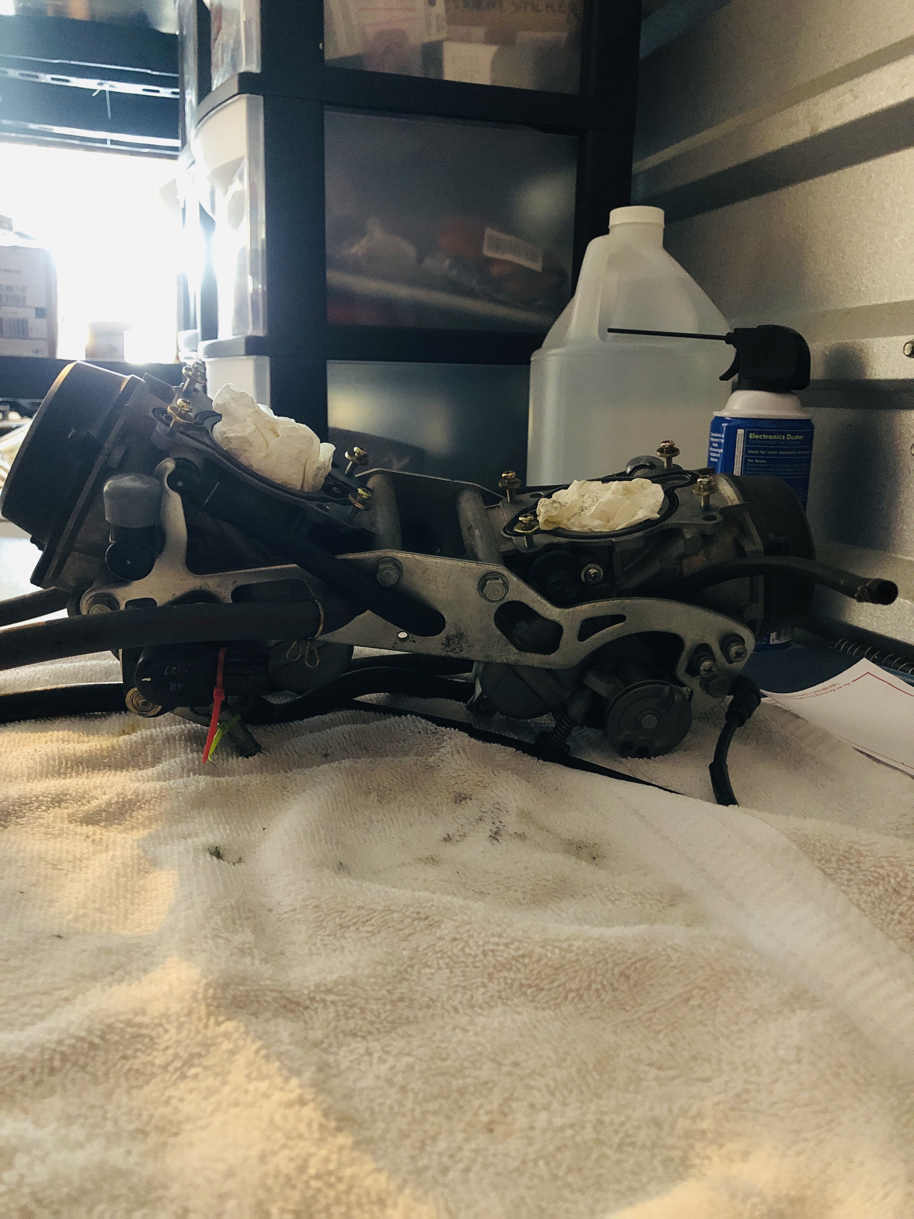

Got the carbs off so I now have access to the coolant hoses and getting ready to do check the valve clearance and replace the cct's.

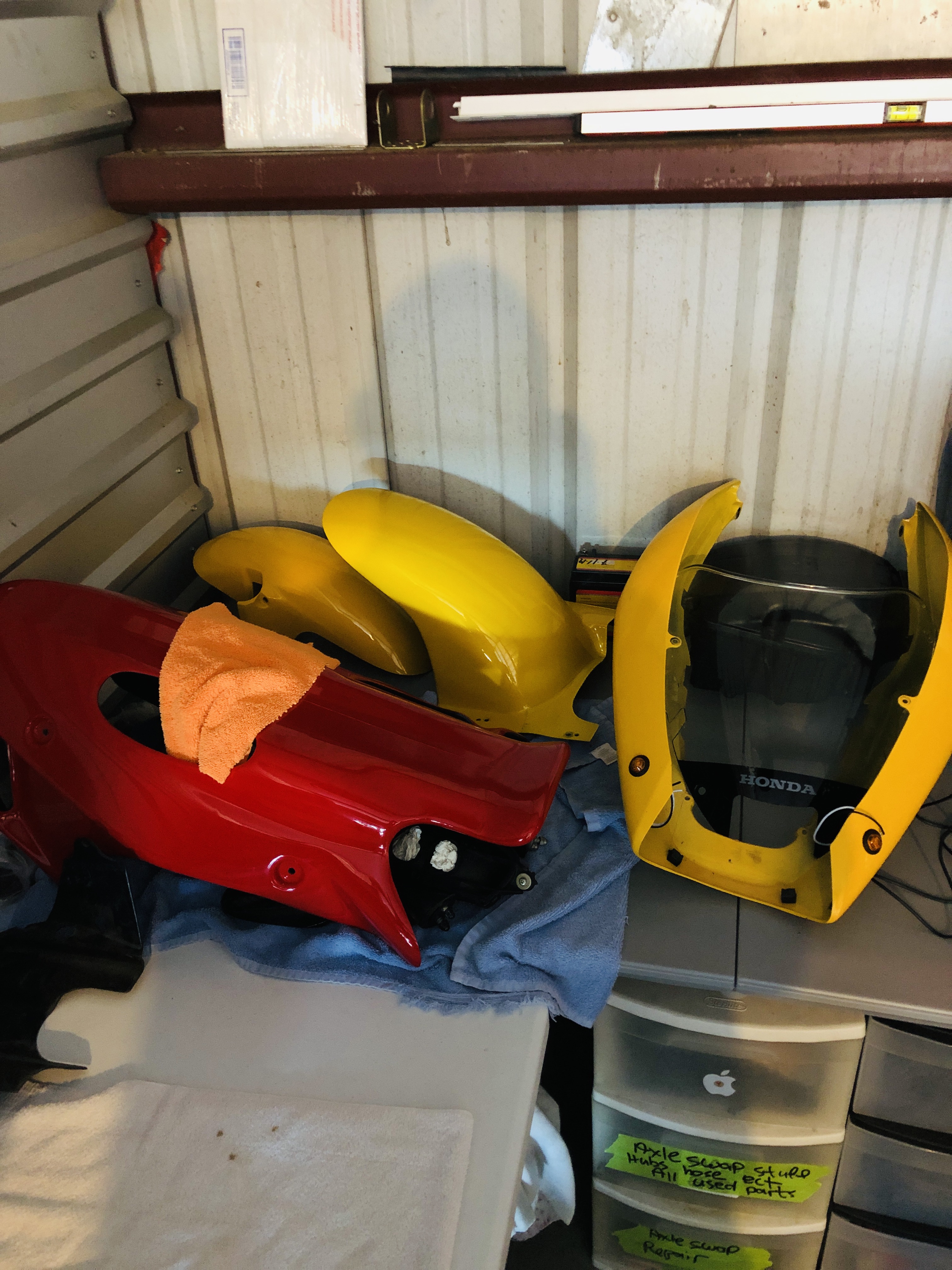

I also hand rubbed most of the new body pieces for the bike as they were purchased from eBay and they came out like new. :clap:

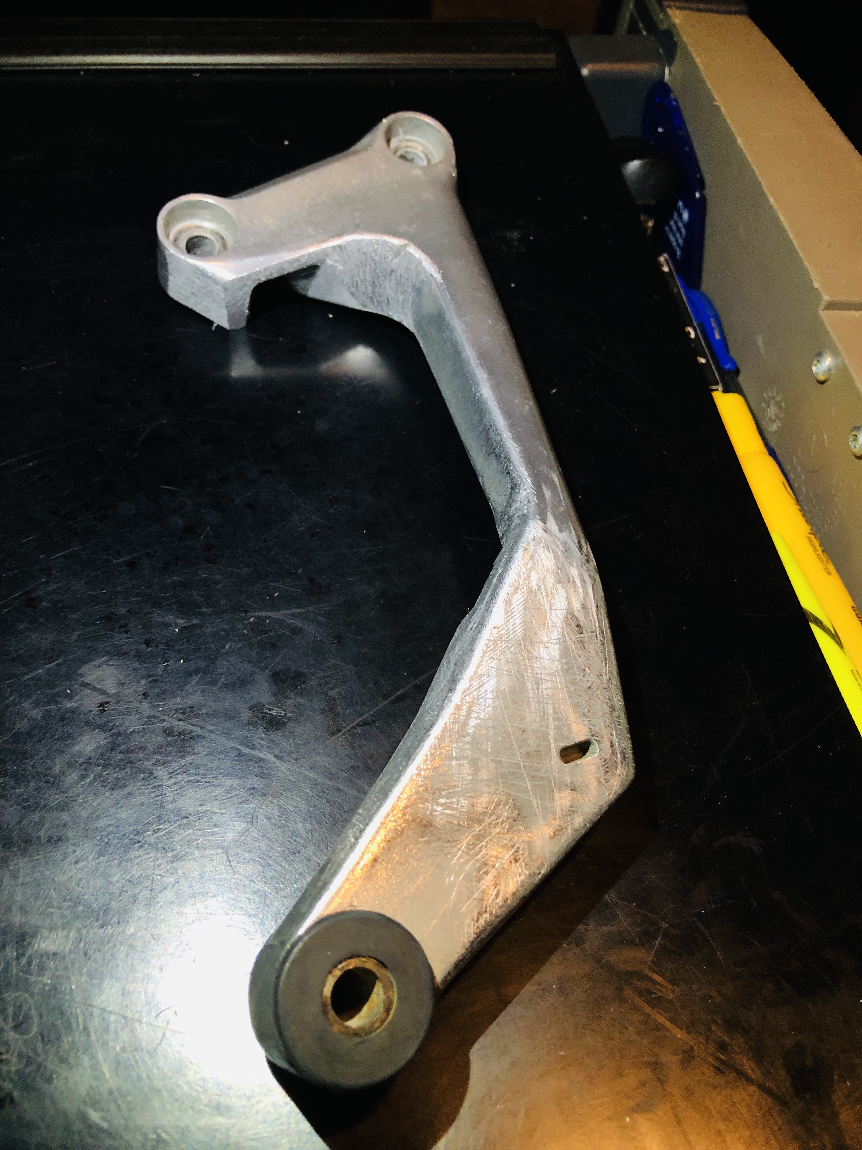

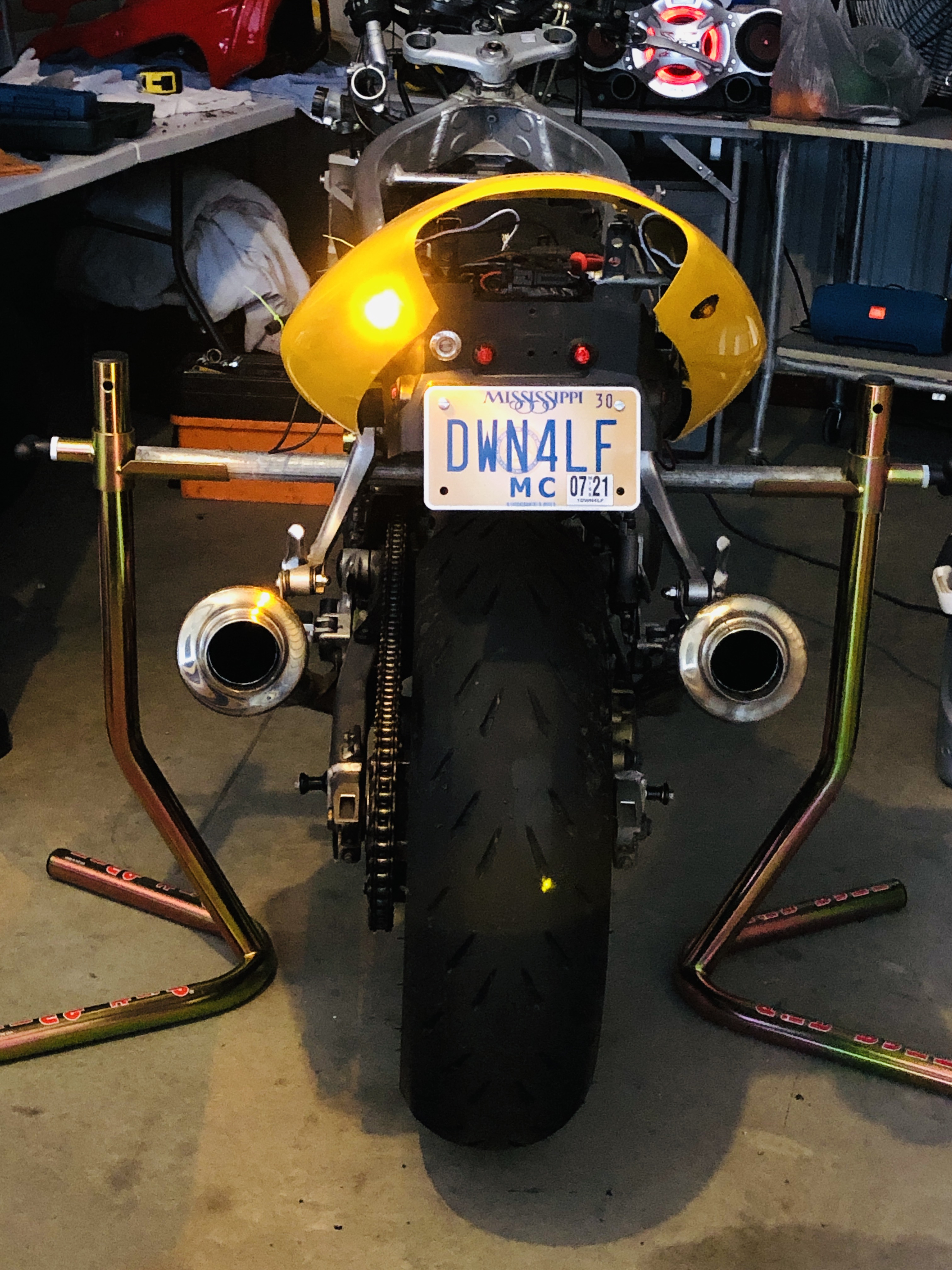

I almost forgot about the progress on the can hangers I modified.
They're looking great and getting closer to completion.
Should look mint when done and still have that OEM look and feel.
:biggrin :wink:
https://www.dwn4lif.com
My website πŸ‘†
Posts: 16568
Re: Say hello to my little friend.
you are making good progress here, and I like the fact that you took some rider training as a key part of this return to biking :thumbup:

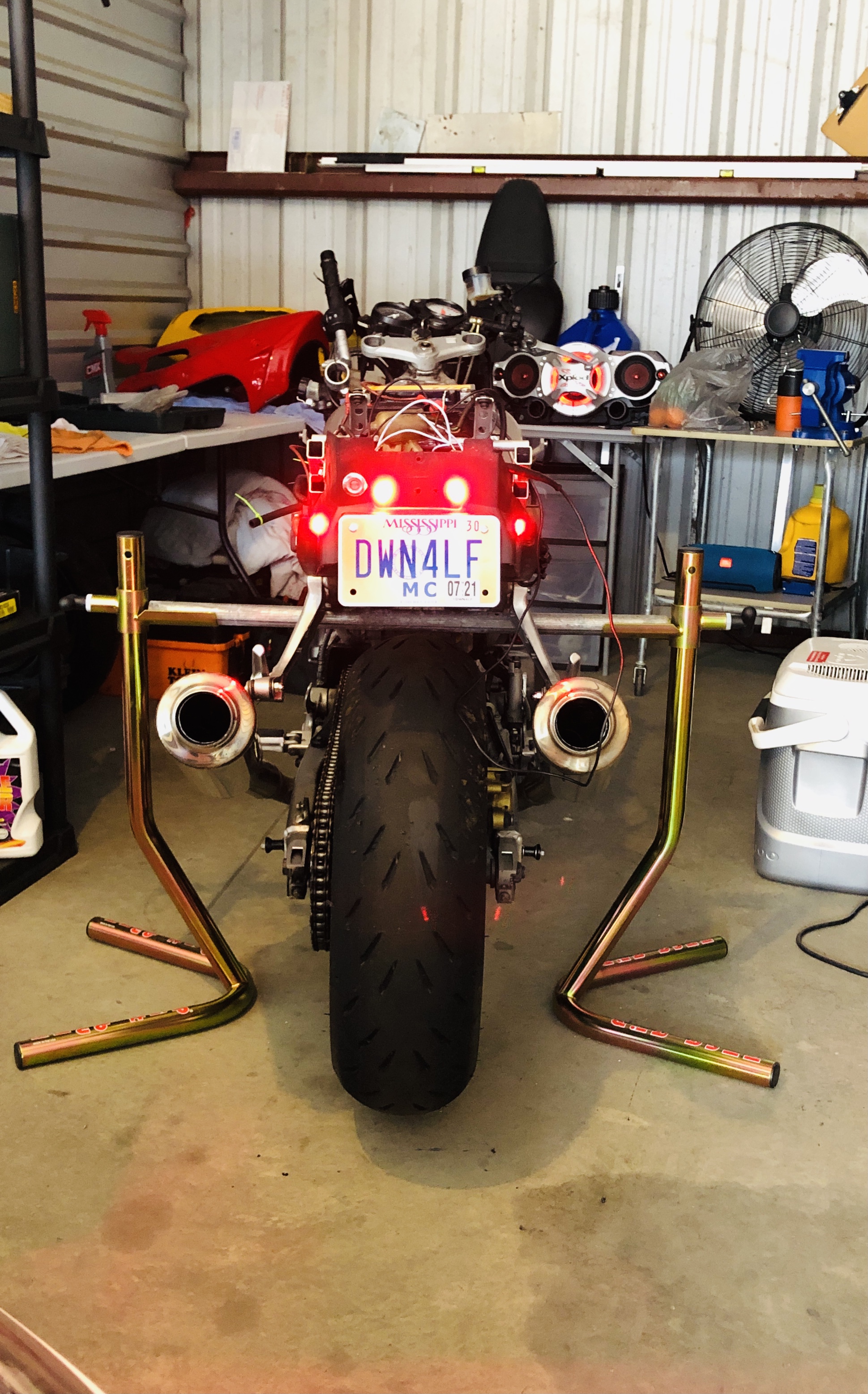

looking at the photo below, I think I spotted that you have the left side end can mounted on the outside of the "no longer the rear foot peg bracket", and on the right side, you are on the inside. so the pipes are not symmetrical
both should be on the inside
Posts: 11218
Looking good. Well done on completing the rider training course. I thought the same thing with regard to the exhausts Al :thumbup:

Thanks guys and I never noticed this on the exhaust setup so I'll have to revert it as it should be. I bought the bike this way so that goes to the previous owner then. :lol: :wink:
Exhaust is being removed anyway as I've got all new hardware for it on the way for restoration purposes and I also plan on heat wrapping it for the new lower fairing and new shock to stay cooler.
I may put 200 miles a month or less on it when it's finished since I'm over the road all the time so the wrap should stay looking good for a while.
Again thanks for the heads up on the exhaust. :thumbup: 8)

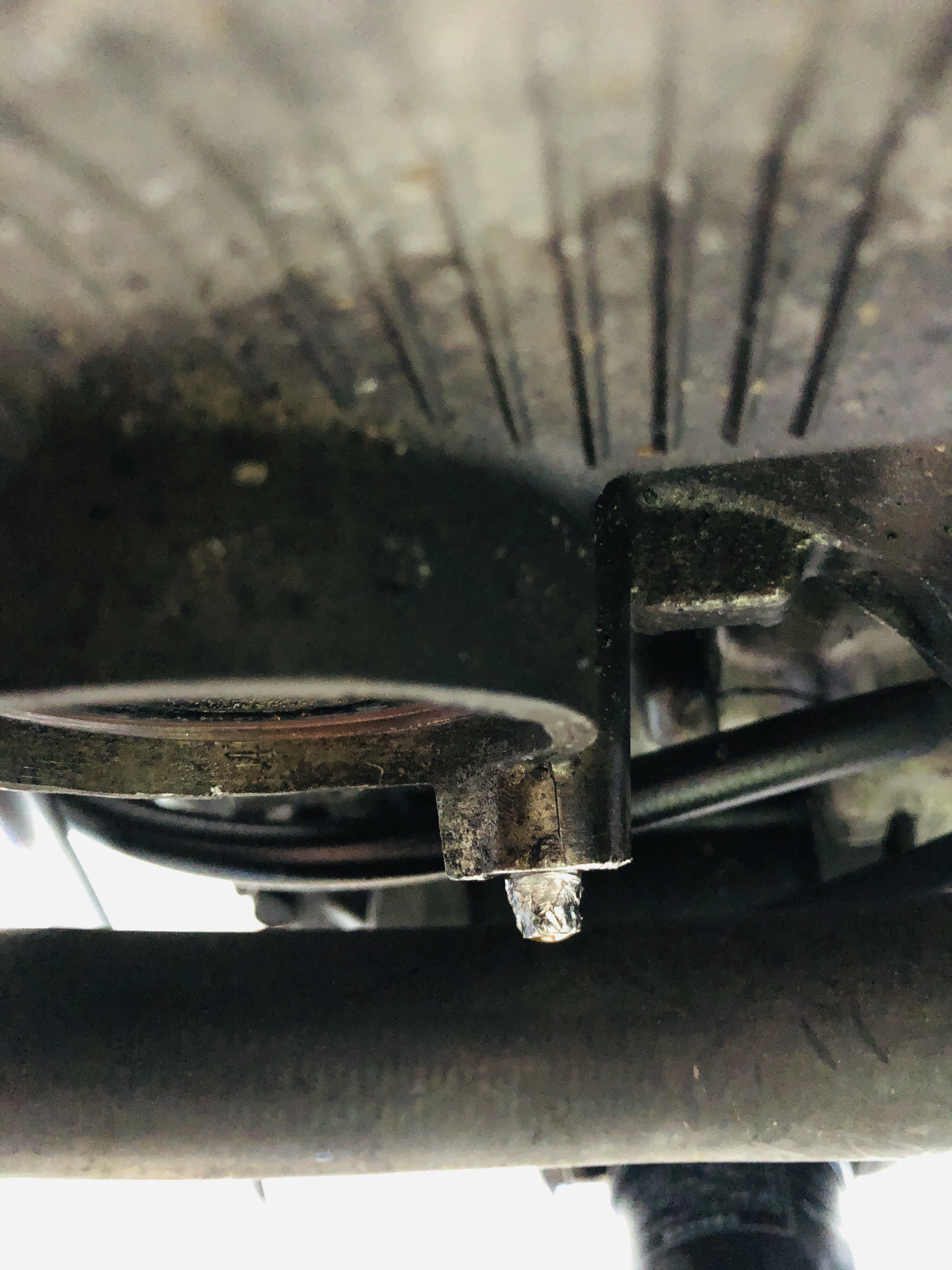

Another update and first the bad news.
Upon removing the exhaust from the bike I also proceeded to remove the studs since I have new studs for this build. First three were easy to remove and then there's always that bad apple to ruin things.
So I've sprayed it multiple times with PBBlaster and when I get back home again in 3 weeks I'll resume bathing it in penetrating oil before I do the heat cold truck on it and try to remove it again. πŸ™πŸ½πŸ€ž
Broken stud but fixable.

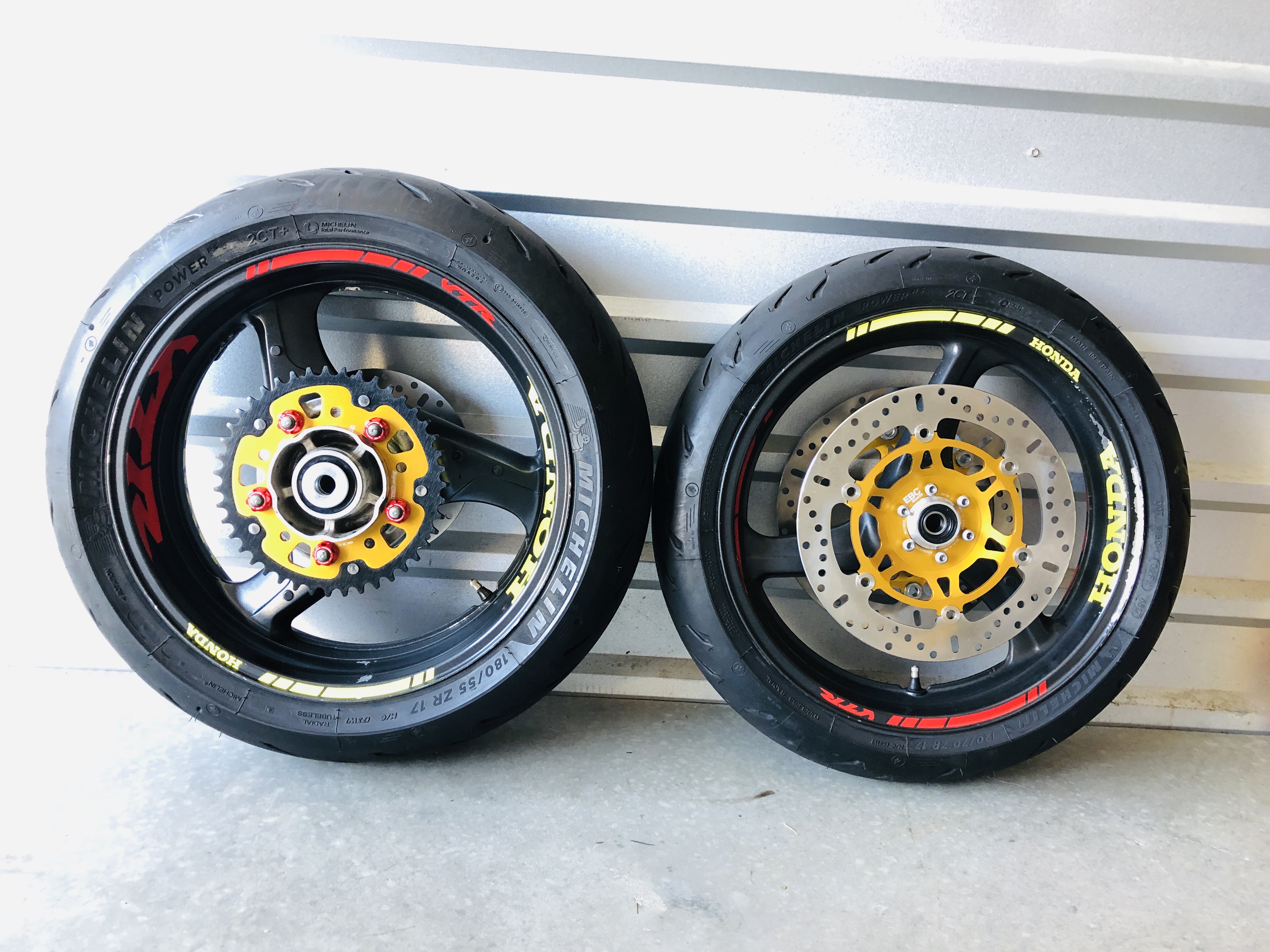

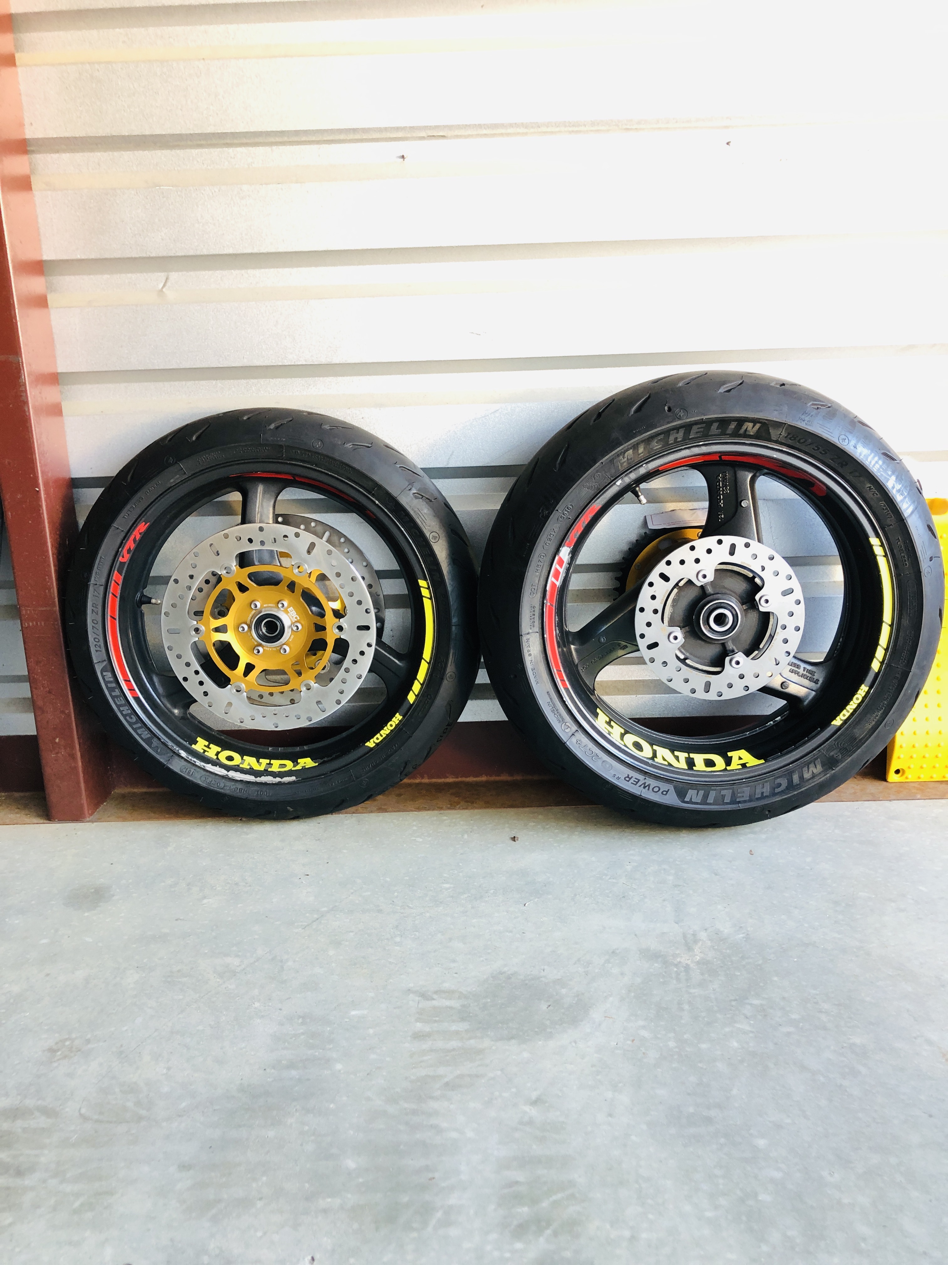

Original from and rear wheels are cleaned up, bearings checked and ok, and sticker The wheels to cover up aged blemishes so I can ride.
I have a spare set of front and back that will get new bearings, seals, and Dunlop Q3+ tires and a good powder coat but that won't happen until the bike is finished and I'm riding it again. πŸ€·πŸΌβ€β™‚οΈ
New EBC rotors and rim stickers.
EBC sprockets and rotors.
I removed the carb gaskets and ordering all new units along with the bands holding them down.
Got the wiring done for the coil over plug setup and just need to mod them for the install. New plugs are in, oil drained, and new Honda filter installed waiting for the fresh oil. Oil cooler lines cleaned up and newer used cooler coming to replace the original that looks a bit shabby with fins beyond repair.

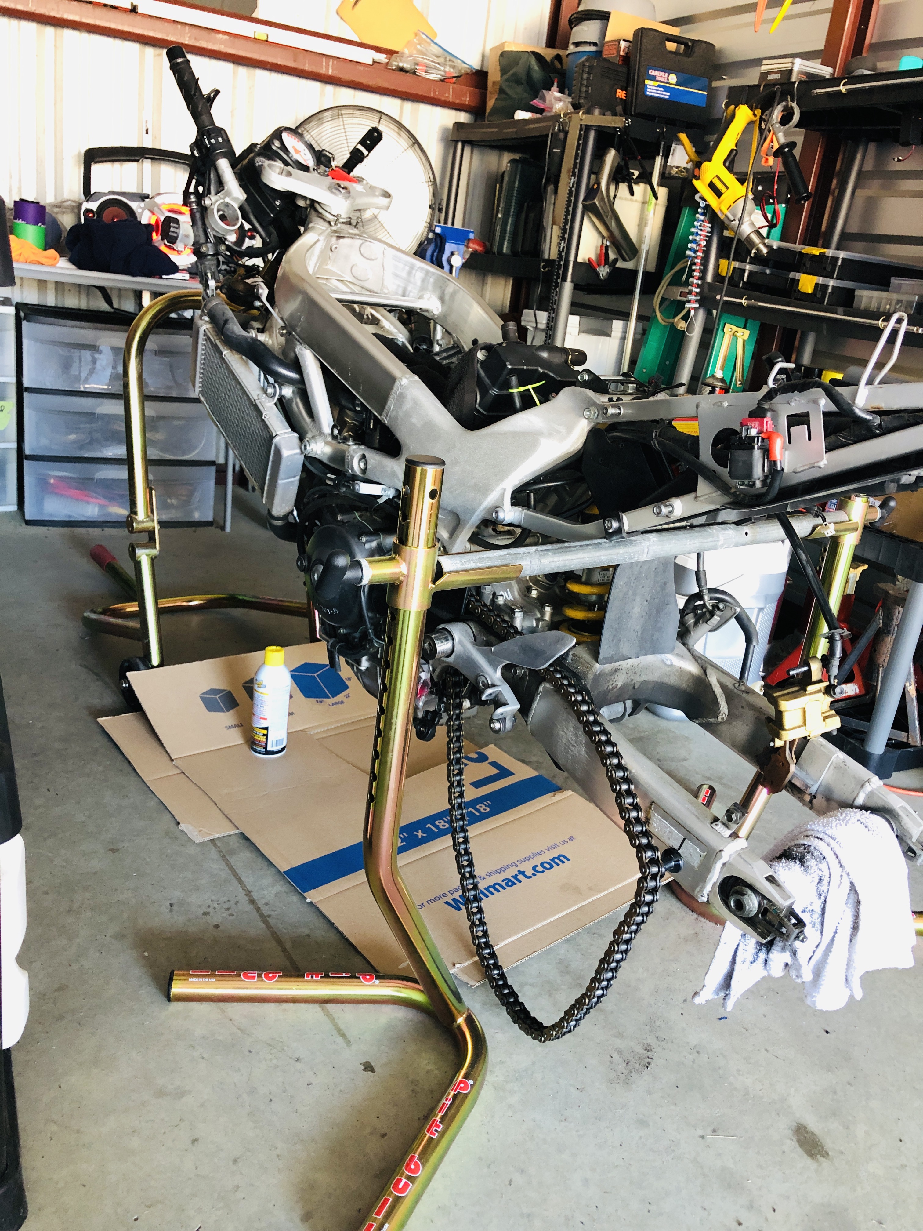

Cooling system will be next in the list and this is how the bike looks with no clothes on. 18+ viewers only. πŸ˜‚πŸ˜œ
Ive already upgraded the main ground with a 4awg cable and added a new ground 8awg to the frame as shown in the picture below. You'll see it above the casing in the pic.
I'll also be rewriting the hot lead with 4 awg while integrating a battery disconnect switch similar to a race car. This is more for theft protection than anything else but also useful if ever needed in an accident etc.

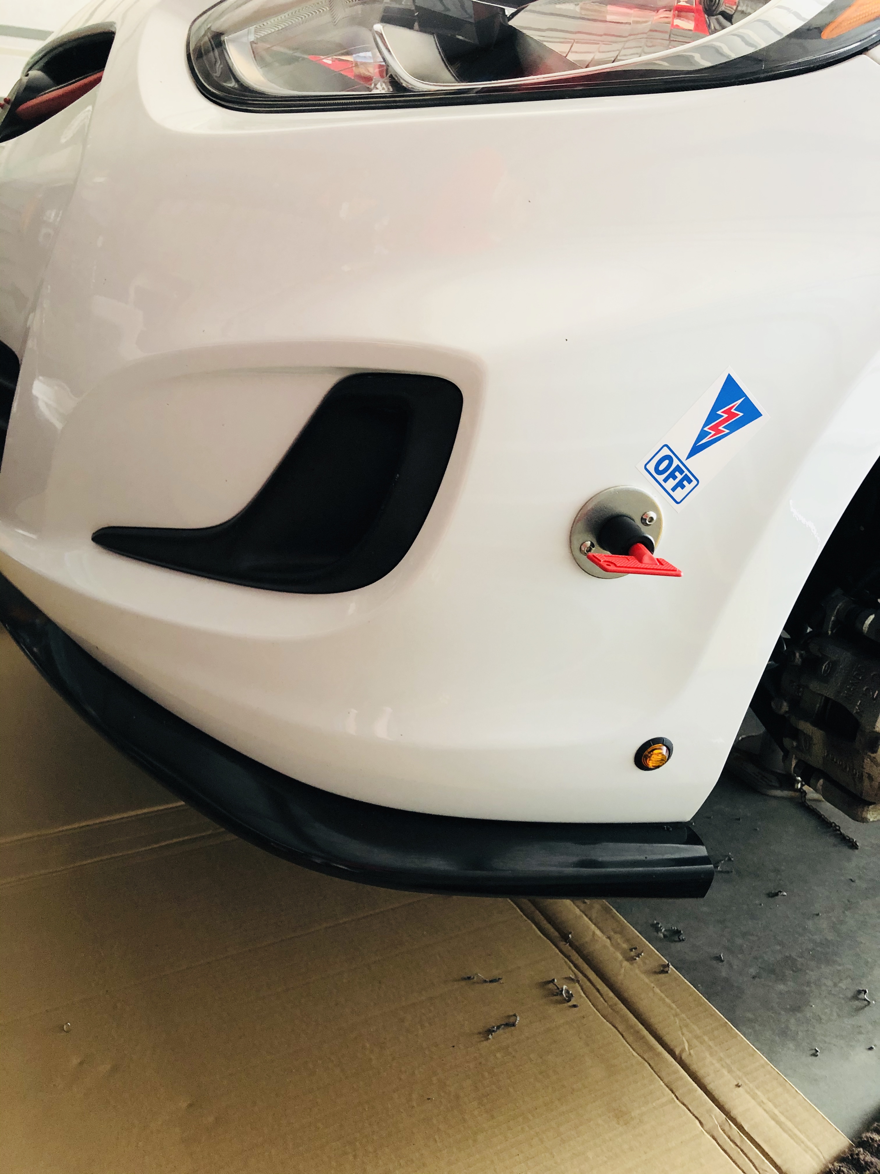

Same cutoff switch I'll have on the bike.
