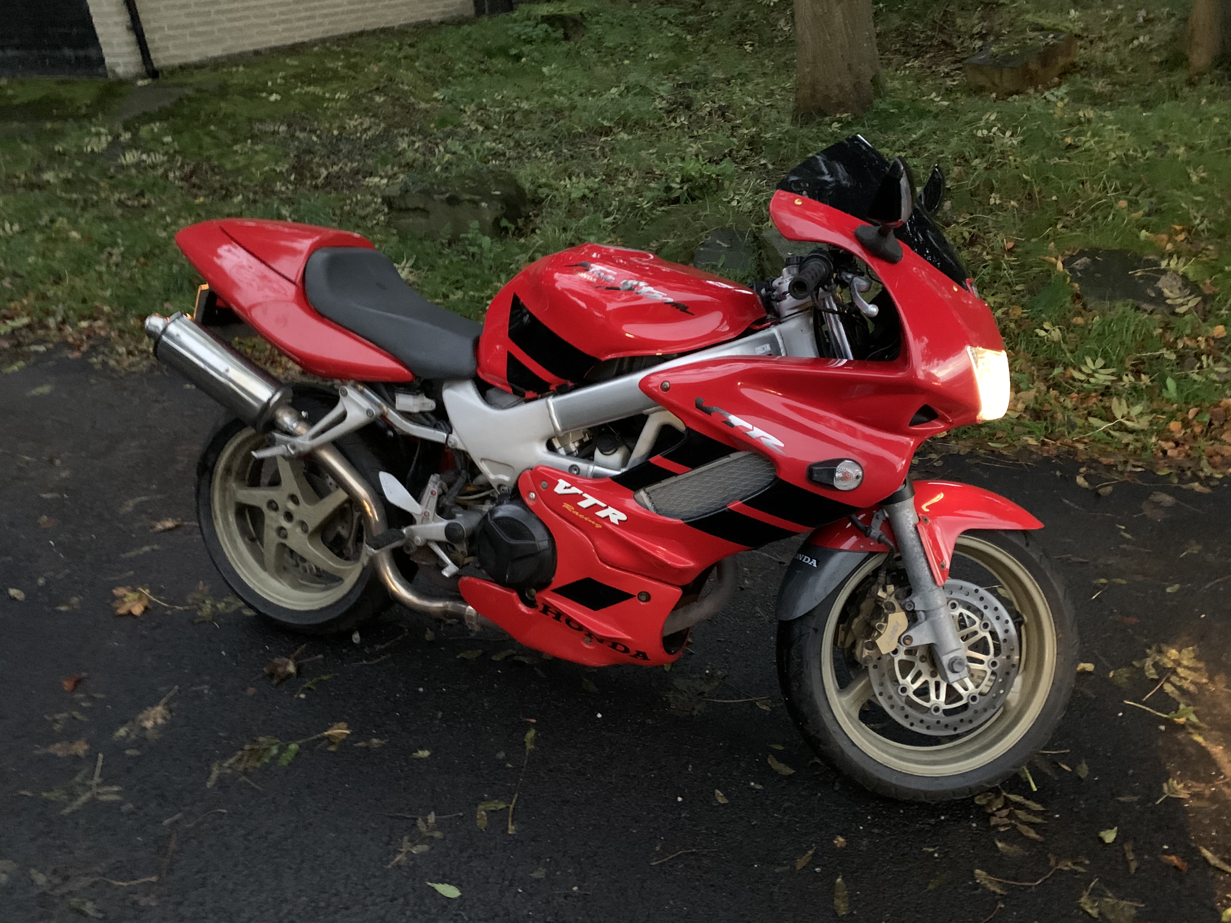

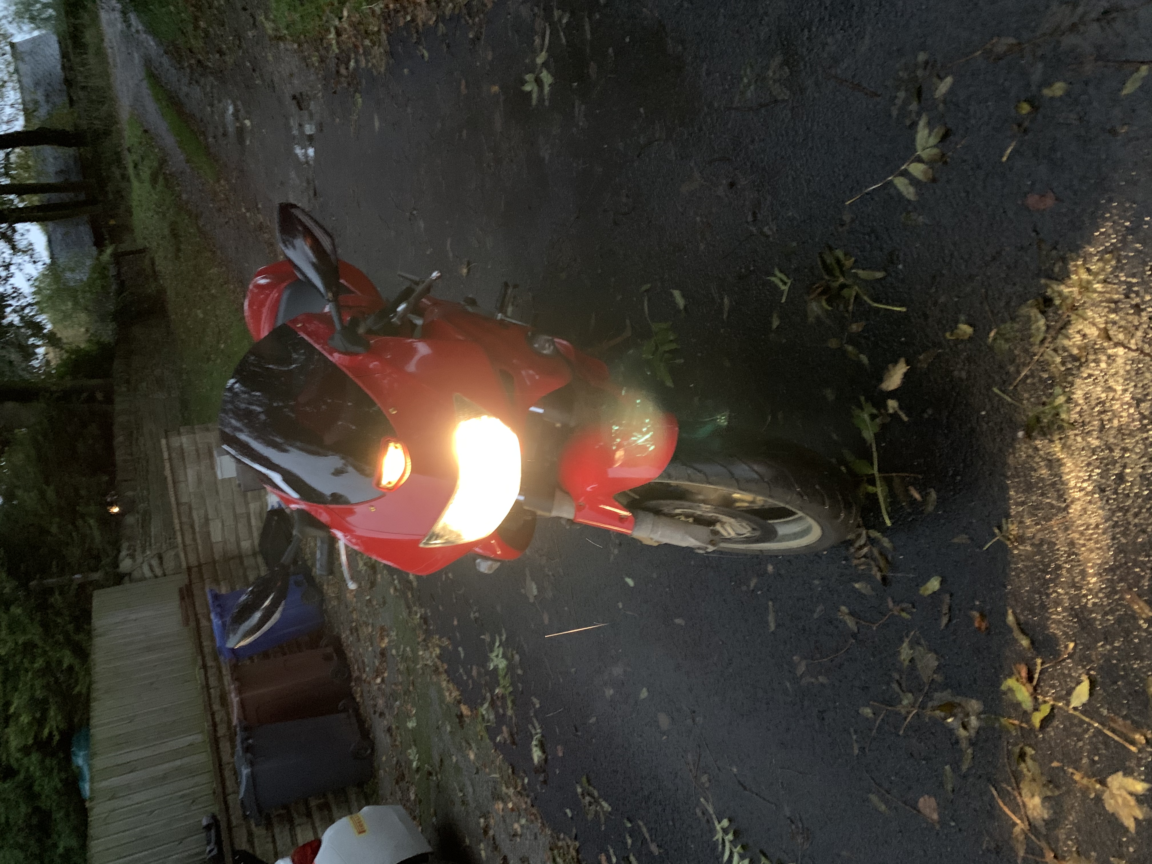

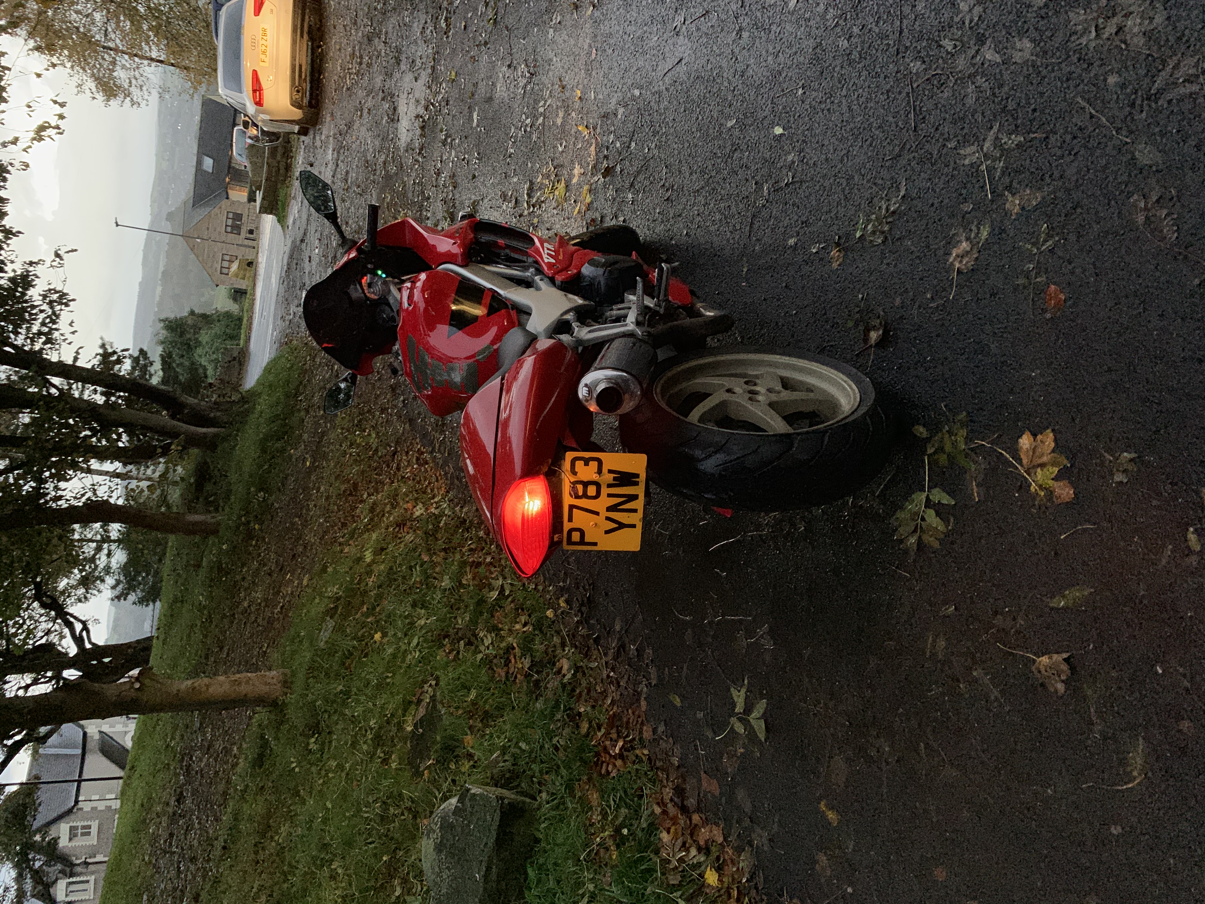

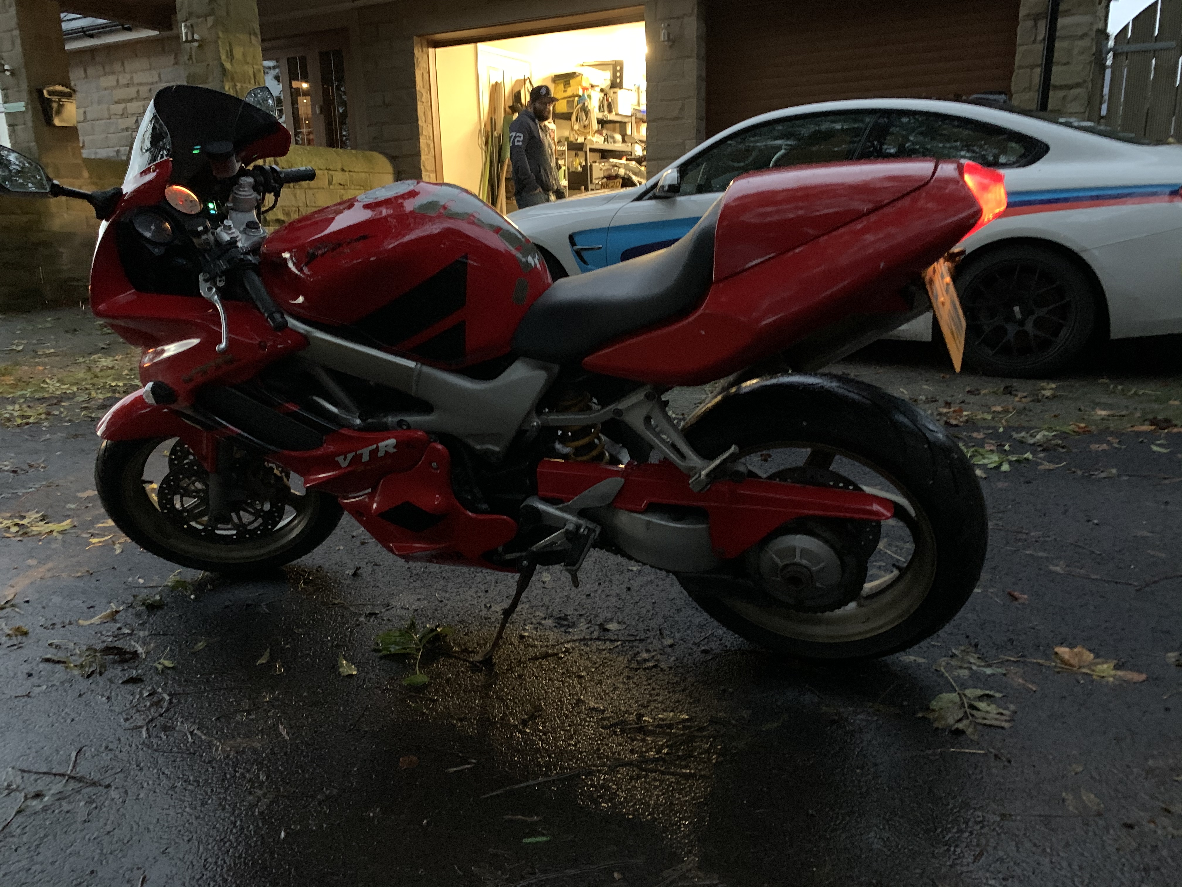

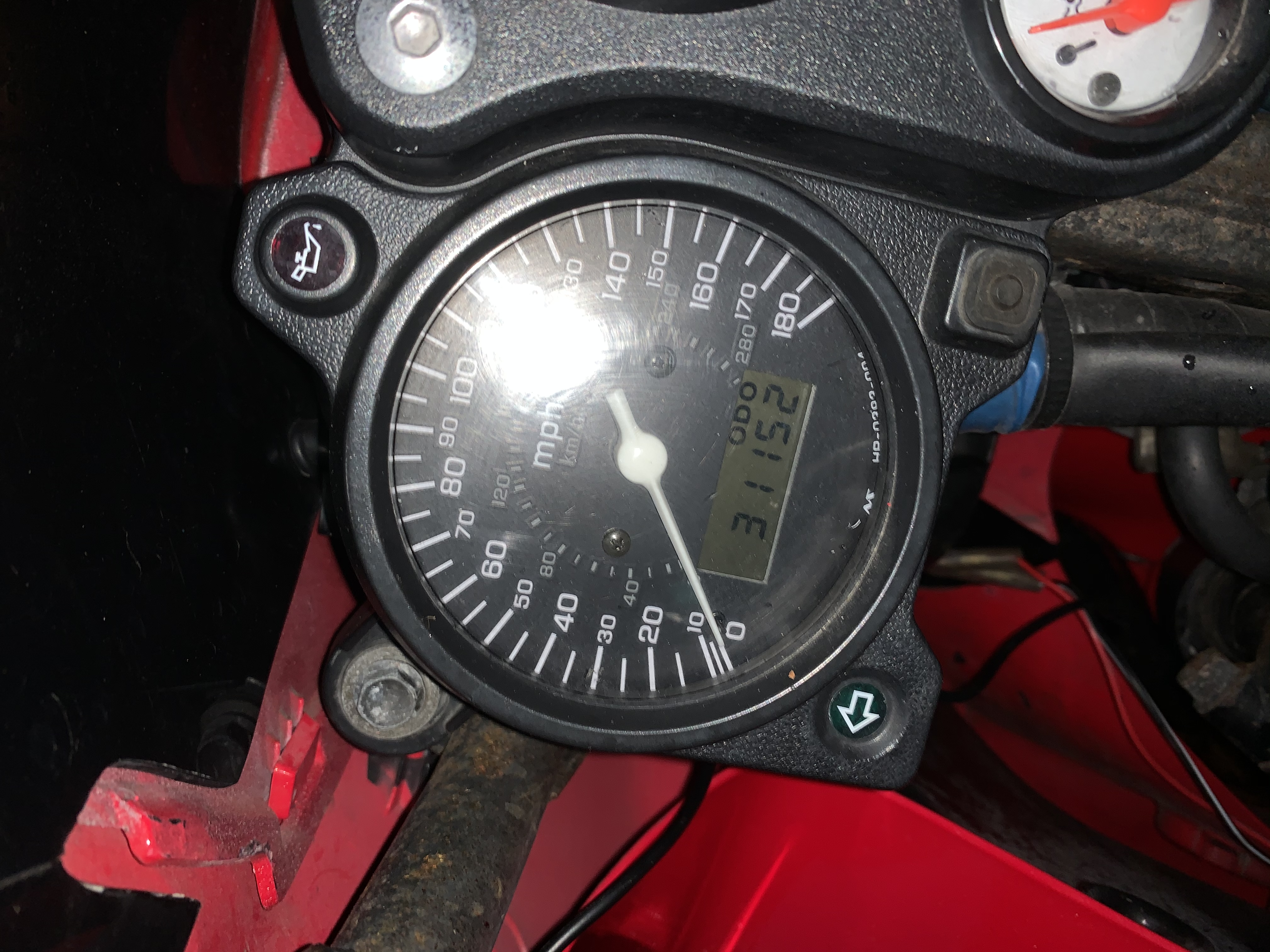

Hi guys just bought a VTR and looking for some help as to why it has a single arm swing arm as from what I can see that’s off the 800 also looking to sell the bike but cannot post in the for sale group also could anyone advise on the price I’ve no idea what it’s worth 31k miles no mot seems like it’d fly through with some rear indicators thanks (reason for selling is I’ve not passed my test)

Greetings
Seems like a 'cut & shut' job using VTR/VFR - Does it have the VTR's V2 engine or did they use the V4 engine?
What did the previous owner say about the bike to explain the mash-up?
Usually folk cut & shut VTRs with the racier VTR SP version as they're worth more.

The single sided SA weighs more and makes the wheelbase longer, so handling is made worse, unless you like motorways.
The fairing looks like a trackday SP1 or SP2 one.
The air intake in the nose won't connect to a storm airbox, as the SP routes through the headstock, which you can't do with a storm frame.

The VFR rear end is a mod thats been done a few times, If I was buying a Storm with that done I would want to know who did it & give a very good looking over to make sure it was safe...
