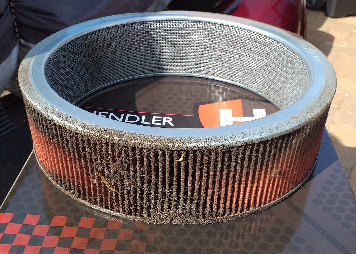

Not meaning to go off track here, but the mention of air filters reminds me to display what I took out of my new (to me) 2001 Pan Euro yesterday :confused

nigelrb wrote: Fri Sep 18, 2020 8:36 am Not meaning to go off track here, but the mention of air filters reminds me to display what I took out of my new (to me) 2001 Pan Euro yesterday :confused
Plant spuds, that's next year's chips....

tony.mon wrote: Fri Sep 18, 2020 7:09 pm
Nah, I got enough on my shoulder! :thumbup:
