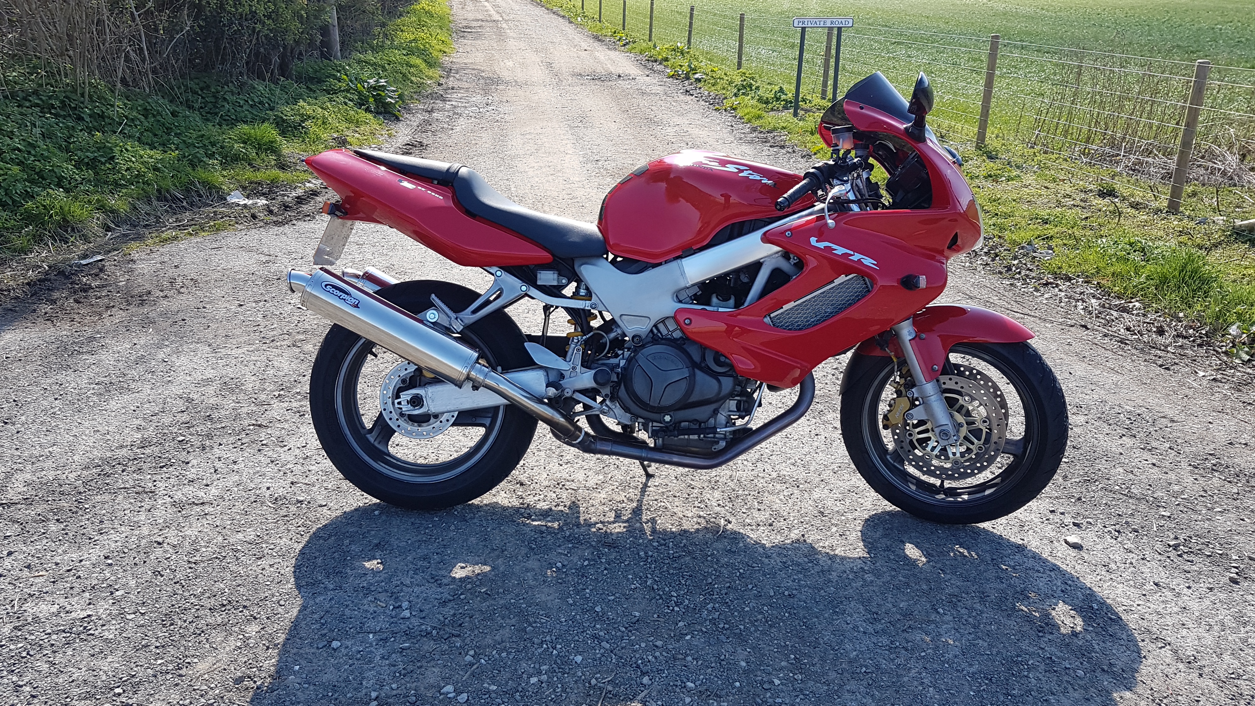

Post by marc morgan »
This is the bike anyway.

Post by grumpyfrog »
There were a few for sale in Edinburgh last year that were Canadian imports.
Oh, hi and welcome by the way.
Shinny bike there.

Re: Import bike
Looks very good and mainly original apart from undertray with different indicators, and bar ends. Presume pretty low milage from lack of wear on the fork lowers but careful and keep an eye on the pitted chrome oil lines.
Handy extras with the braided brake hoses, screen and Scorpion Cans.
Did it coome without the seat cowl? and hope you plan to preempt the auto imploding CCTs with manual tensioners. Also check the R/R to see if it's the orginal self-cooking unfinned one and plan on upgrading.

You have a keen eye. Going to source some more original indicators and the seat cowl. Low mileage at 22400. I will replace oil pipes aswell. Cct's are manuals already so don't need to worry about those. What do you mean in the last bit of your message about R R thing.
