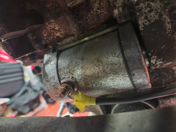

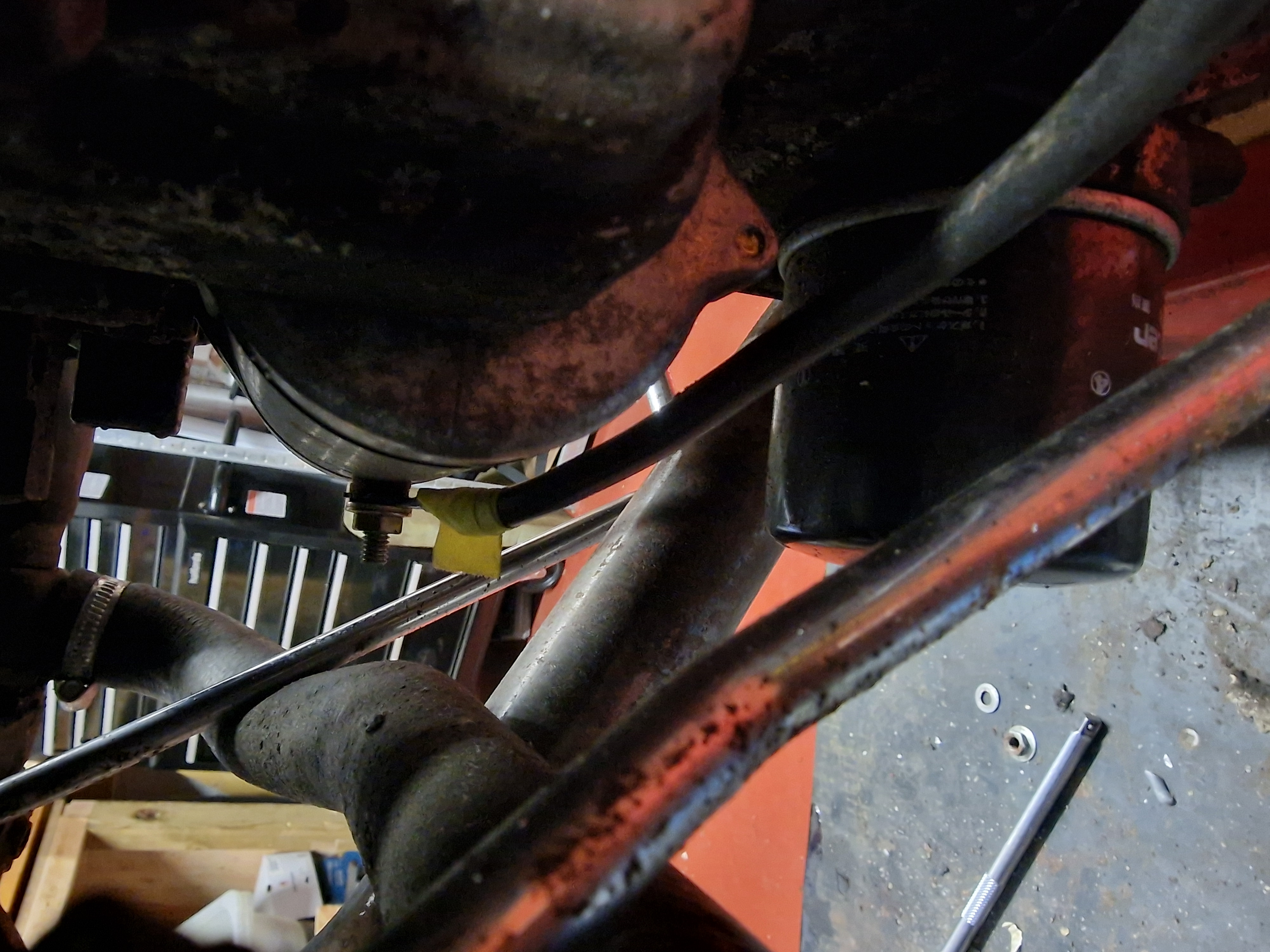

I'm not convinced it is the lithium battery as the symptoms persist with a known good AGM battery, but very odd that regardless of the battery fitted, as soon as you attach a jump pack, away it goes, but also more than happy to be wrong!
For reference, the AGM battery being used is a Motobatt HD - slightly higher specced than the OEM, but not by a whole load.
Finally got down to my lock up today to get some photos/footage.
Photos of starter terminal attached to this post.
For reference, this video was shot on the fully charged AGM battery.
Not sure if the video throws up any pointers...I'm really hoping I'm missing something obvious!
Posts: 16009
Re: 1997 Rebuild gone bad
The only other part of the circuit is the earth lead, so check that there's no corrosion where it mounts to the rear of the engine.
