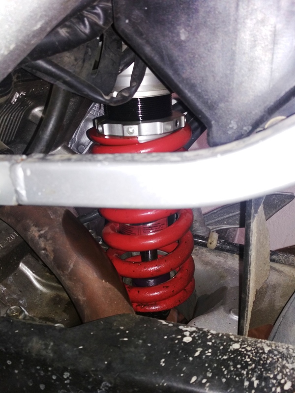

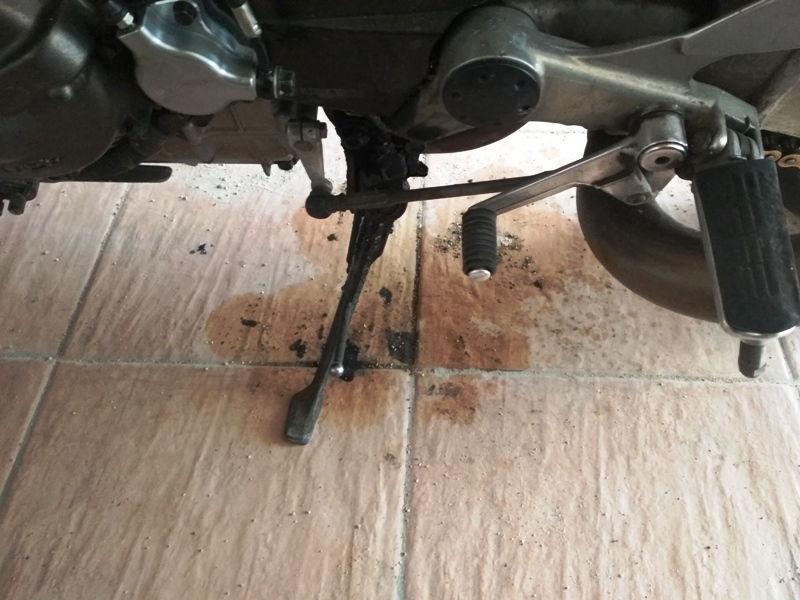

My new YSS rear shock absorber installed in February died today..
Arrived home and I ave seen a big amount of white smoke coming from the lower part of the bike.. Very confused, I have removed the seat to see if there was a electrical problem, but not, the problem was a high amount of oil dripping from the shock absorber to the rear cilynder exhaust manifold...
Lets see how the warranty works.. :confused four months of use.

felix barrao wrote: Thu May 23, 2019 5:10 pm My new YSS rear shock absorber installed in February died today..
That's not good, lets hope the warranty is better than the shock has been so far.
Hopefully this is just a one off and not something that normally happens,

I have to dismount, send to the seller, ( paid shipping, I have to say) the seller will send to the manufacturer or dealer, wait up to three weeks, they will decide if is warranty or my fault, :confused :confused and decide the result.
The seller has told me that it will be covered in warranty, but at the moment I have to dismount, install the old one, and in three weeks again, if warranty works well.
It has been a catastrophic failure, I think, check the pictures, all the clear oil on the floor is from the shock absorber.
You can see also the spill on the exhaust manifold.

The only reason I see for this high oil quantity and smoke is that the oil was expelled by the nitrogen pressure.
I have asked for a money refund instead of a new YSS, I´m not confident with the brand.
This is a real concern, what if it happends on the runway, and the oil goes to the rear wheel? Hopefully it happened arriving home, and when I stopped the bike was a big smoke quantity, and oil spilling like crazy..
