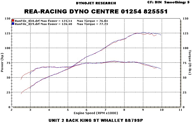

Initial chart below. All I wanted from this first Dyno session was to know the fueling was OK. The first set of runs produced the red line and it was way too rich on the main jets, a bit rich on the needle and lean on the pilots. Smaller mains in, half a turn out on the fuel screws and it gained 1bph and 1 ft-lb torque max values but 1 or 2 of each in places through the rest of the range. Plus max power slightly later and torque tailing off later
Fueling is still lean below 3k but I'm not worried about that for the use it's getting. It's still rich in the mid-range and top end but it's safe so I'll run it in as it is. I'll then go down a size on the mains and I'll have worked out how it's riding and what to play with next. Given the relatively low revs for peak power there's more there with smaller mains and maybe the lower down torque can be improved. But given the shape of the curves I'm very happy.

That's a weird graph, the dip at 5k isn't on the torque curve ??.
Talking of the dip I don't think you'll pull I out with needles, I reckon the exhaust system would be the culprit.. would be interesting to see it run with a full Akro or Yoshi.. bigger bore downpipes could help with more volume.

popkat wrote: Fri Jun 29, 2018 6:26 pm That's a weird graph, the dip at 5k isn't on the torque curve ??.
I've said much the same on the build thread so confirmation for that line of thinking is good. With smaller mains the top end was better but flat when I would expect it to keep climbing. Initially I thought making it leaner would sort the top end but it didn't with reduced mains on the blue graph it just pushed the peak power further up the revs. So going leaner again when it's run in will more than likely do the same.
I'm going to investigate exhaust builders locally, and nationally if there are none around me, and see what they can offer. The more I think about it the more I reckon that at those revs it just can't move enough gas.

Overall though I think it's all very good, just depends on how far you want to go with perfecting it, the bike I'm sure will ride really well. The slight jaggedness at the top end is most probably the bellmouths/stacks and could be smoothed with tuning the lengths. Very time consuming for the perfect power curve, if it performs well on the road and track then that's what counts and no need to fiddle further.
My VFR has a big hole at 5.5-6.5k but as longs as I'm not down at those revs it doesn't matter, as it's a track bike it's not worth me trying to fill it as it would require a different exhaust configuration.

You have got some very tasty results there. They seem to always dip around 4 to 5. You must be really happy with that and I bet it rides like a diffrent bike.

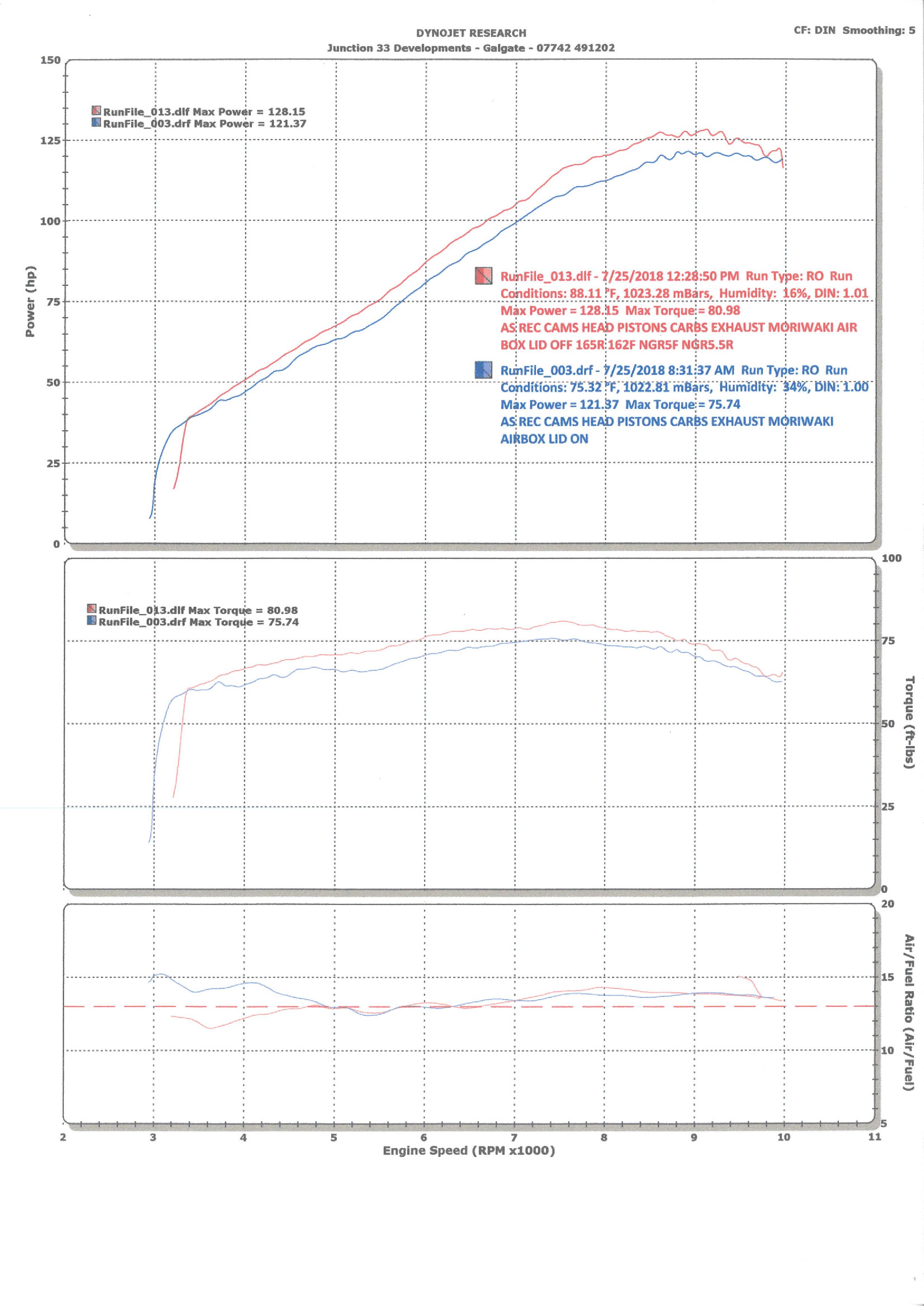

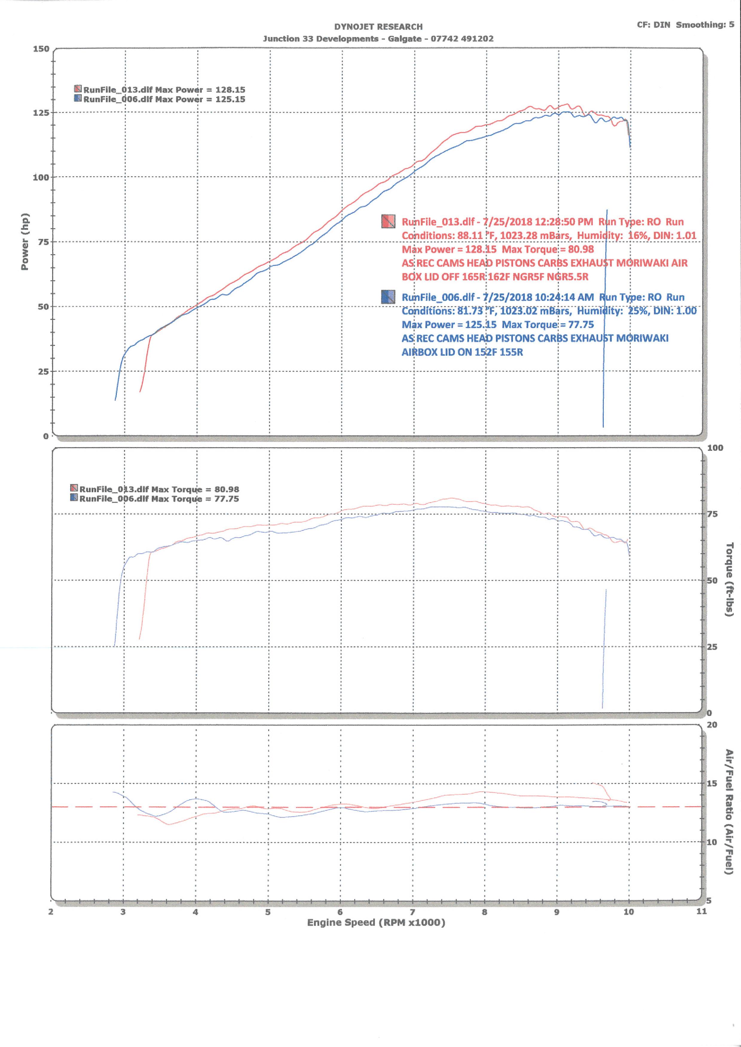

After riding at Oulton the fuelling was clearly off. Drive was good all the way to the redline but it was lean on small throttle openings - lots of popping and a bit jerky - which didn't feel great on the way into Island
Booked in with Andy at Junction 33 and we spent four hours sorting it out so now I have two great setups, one with the lid and snorkel on the airbox and the other without the lid. I wanted the lidless setup because the bracing in the frame I'm swapping to covers the area where the snorkel is fed from.
Below is the initial setup against the open lid. I'd swapped the exhaust for the Mori system which helped with the riceness from the last session. And the rings have obviously seated now as there was hardly any smoking. Given the 126 reading on the other dyno is now 121 it would be over 130bhp if I was chasing numbers :whatever. The leanness low down has gone and the slight dip between 5k and 6k too. The torque curve is much flatter at that point too.
Below is the open and close lid comparison. With the lid on the fuelling is bob on. Without the lid the mains are larger and the needle richer but still a little lean past 7k. Andy was happy to leave it there in terms of Dyno runs but suggested going up one size front and rear when I next take it apart.
