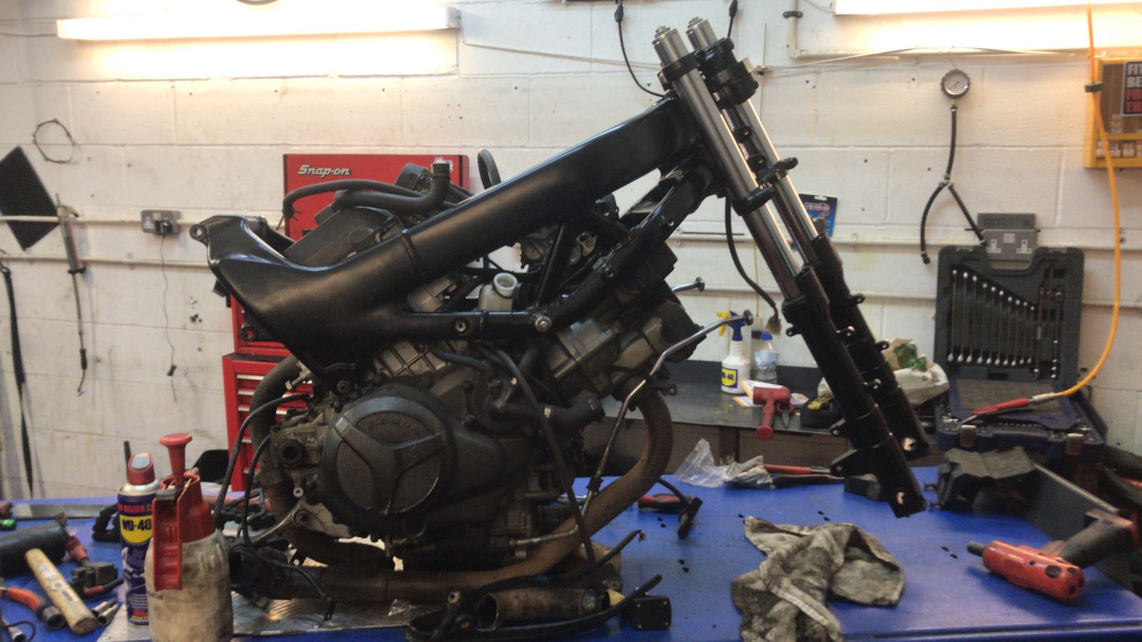

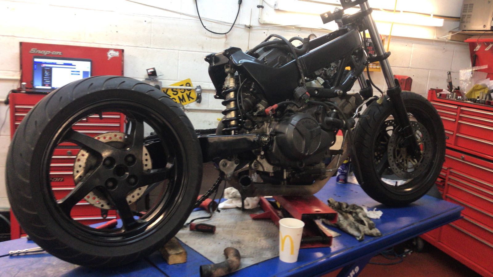

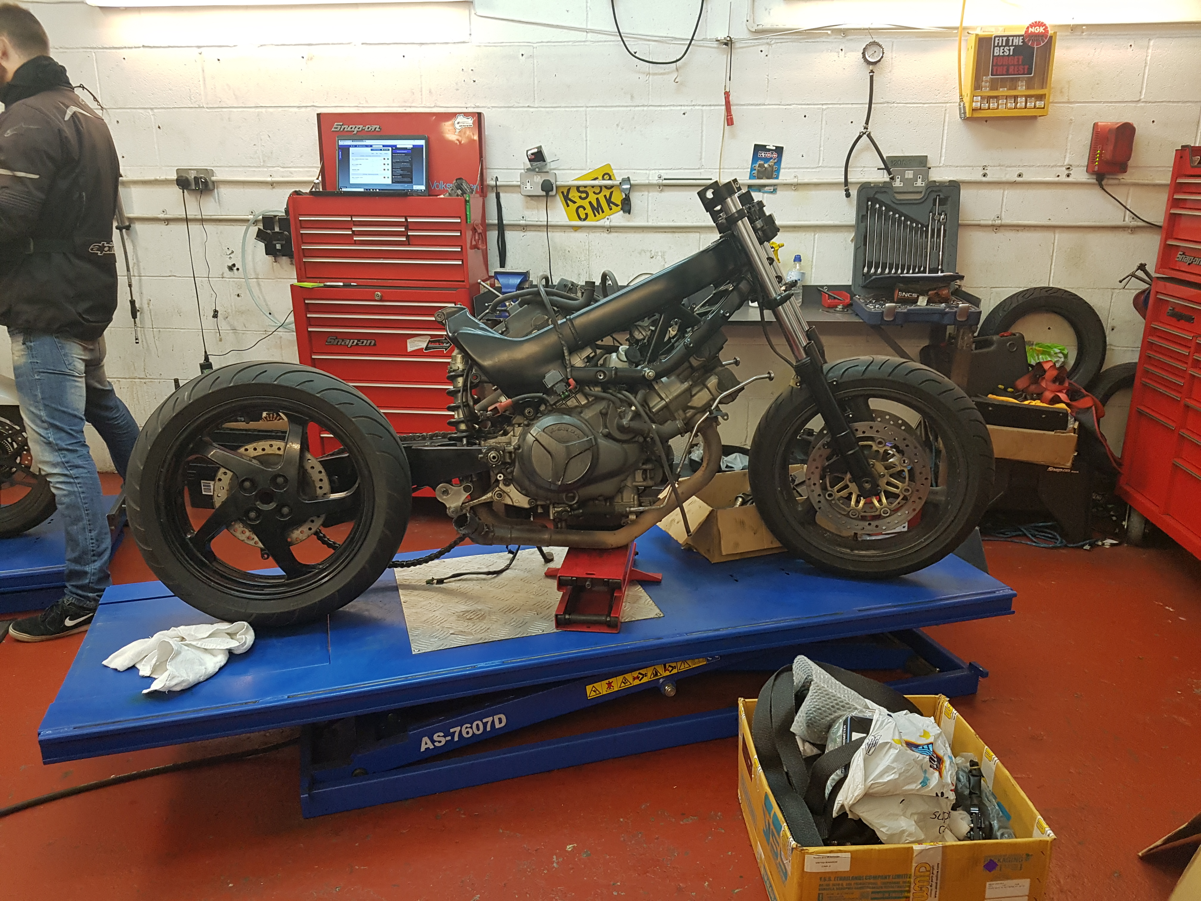

Bit of progress on the project.
Been stripped and powder coated including the shock spring.
Bought the rear end off a vfr750 for 200 eBay.. was some faf and unforseen expense having it rewelded to accommodate the shock and wheel.
More to come

Screw the bike...I want your workshop :lol: The perfect opotunity to give things a good clean including those headers. Any plans for the bodywork?

Hah not my workshop very sadly :sad2 in my pals. Gonna give the engine a clean up and spray. Currently got the tank front fender and tail piece getting gloss blacked. Keeping the rest of the bike matte black.
Cutting the exhaust 2 into 1 and dropping the gearing down to get more low end.

Feel like the single sided has increased the length alot although I haven't measured it. Dropping the gearing 45/16 with bar risers and renthals should be interesting to see how she handles.
