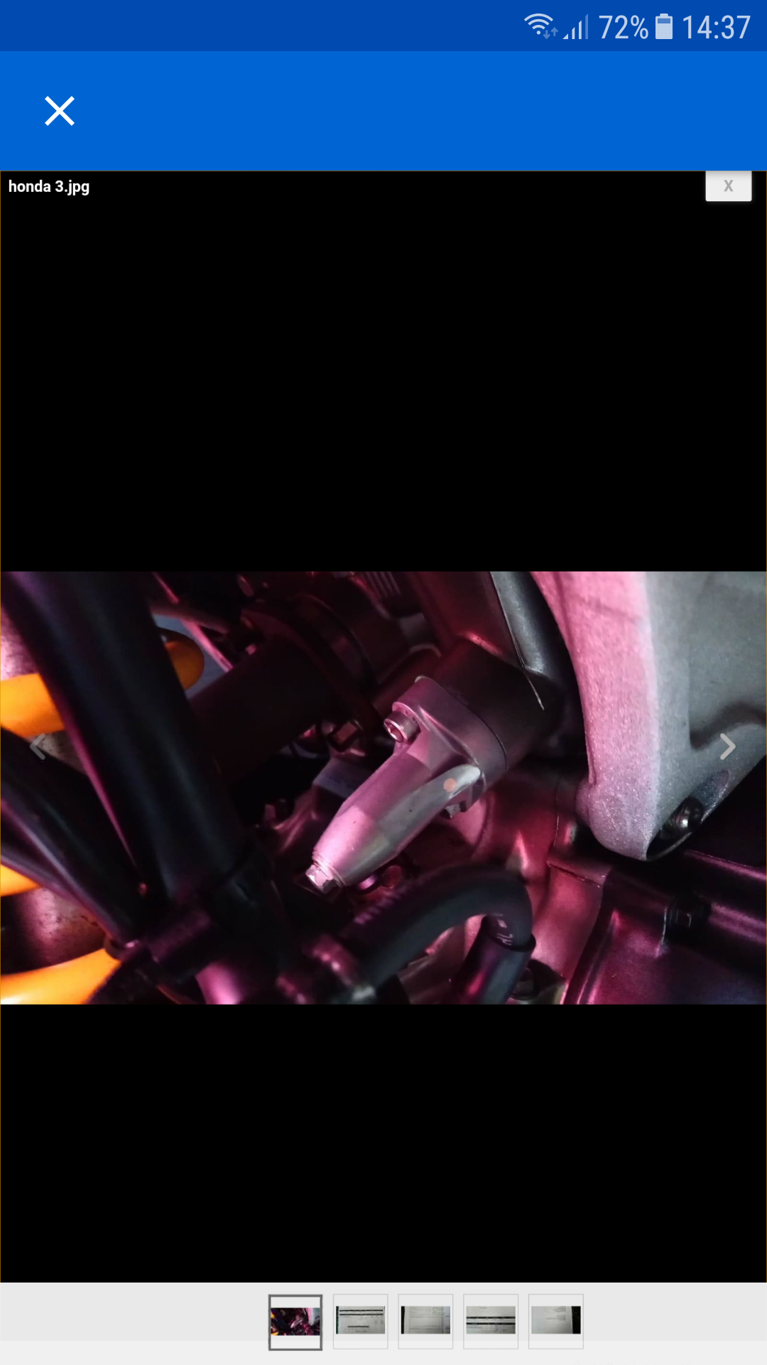

Is this a manual CCT it's on a bike I'm looking at. Cheers.

It's an Auto CCT, standard item.
Posts: 17472
Re: Does this pic work?
Yes unless its had a stopper mod done, you'll only know that by taking it apart tho... Or when the spring breaks & you engine dosn't try to eat itself.
If you have any doubts change them to Manuals, far far cheaper than rebuilding an engine...
& yes we can see your picture...

Cheers there is paperwork saying they were changed in 2010.
Posts: 17472
loinstallion wrote: Sun Mar 11, 2018 12:58 pm Cheers there is paperwork saying they were changed in 2010.
Makes no differnce if they were changed yesterday they can still go pop without warning...

Thought as much. Cheers.
