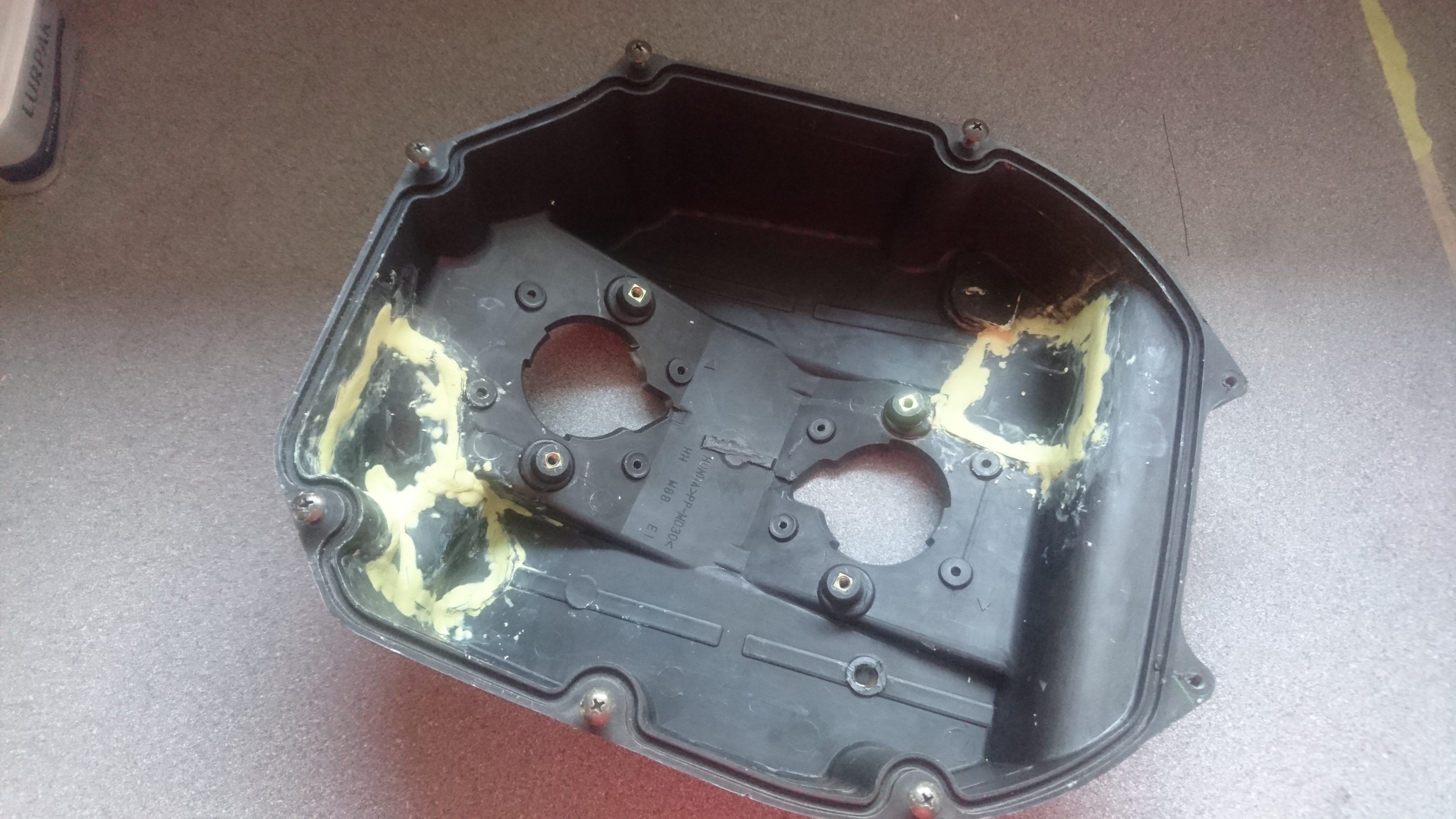

The bike is coming together now having snatch the odd hour or two here and there. This weekend should see it all sorted.
I finished off the airbox today and the fuel pump should be wired in early doors along with the carb rubbers after being matched to the ports. Then it's all plain sailing. I hope.
