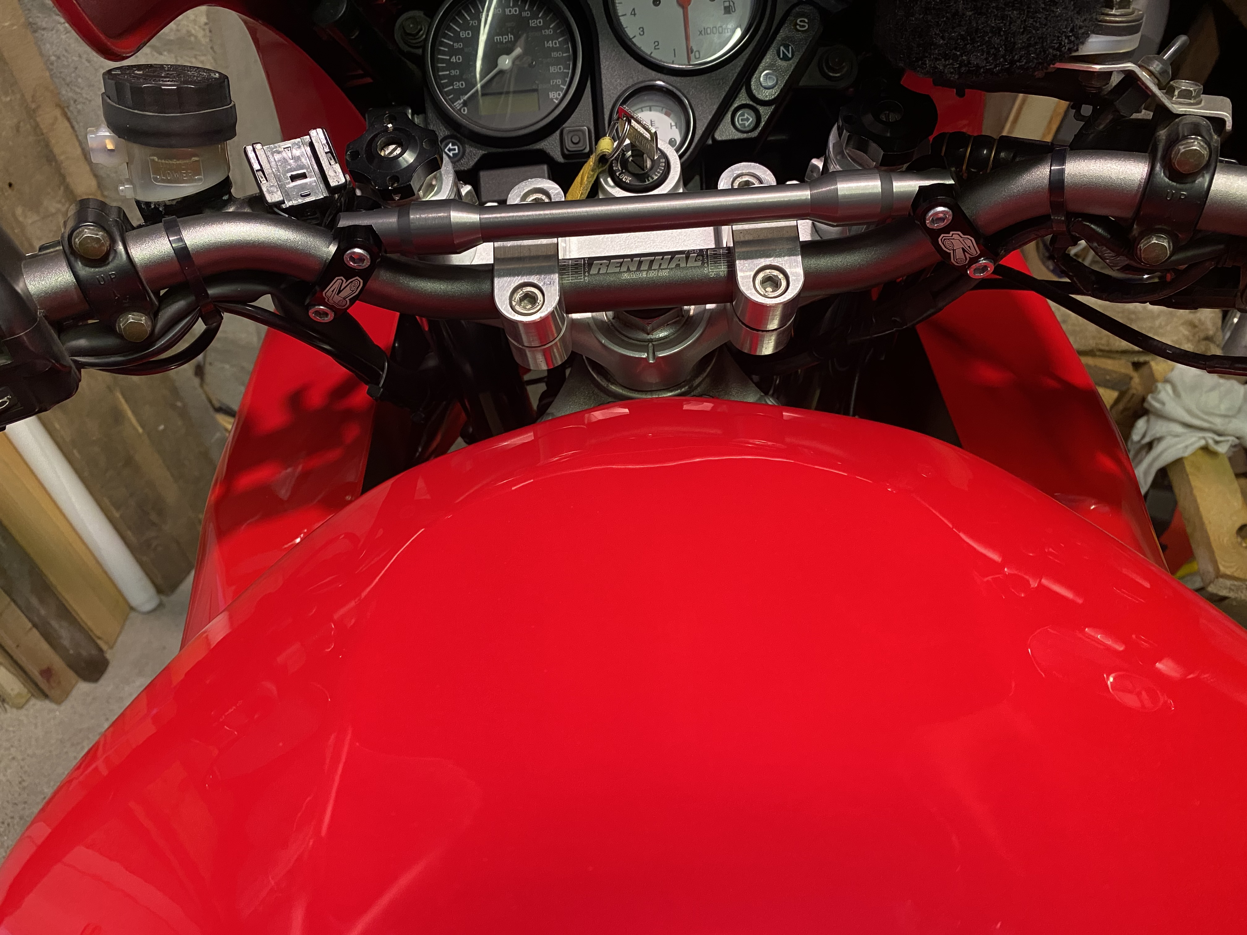

I believe the kit you are thinking about purchasing in that link is designed to sit on top of the existing Firestorm top yoke. The only thing I'm not sure about is what height the handlebars will be sitting at. With the risers I used the h/bars sit 19mm (3/4") above the Firestorm OEM top yoke, if they are higher than mine it may mean you will need to trim the fairing. Also the handlebars supplied, if they are higher than the Renthal Ultra Low h/bars I used the fairing may still need to be trimmed.
The OEM front brake and OEM clutch master cylinder positions are determined on my bike by the fork stanchions that protrude above the top yoke. I have them both as close as possible to the stanchions (in-other-words they are both slid along the h/bars towards the ignition switch as far as they will go), although the banjo bolts are not quite touching the stanchions. The OEM clutch master cylinder reservoir is fixed to the master cylinder body (I had to remove the safely bracket that stops the lid coming undone and it's fixing screw as it didn't clear the fairing, it now supports a wide rubber band I made from an old inner tube that does the same thing). The OEM front brake master cylinder reservoir didn't need moving for it to clear the fairing, although due to the new angle it now sits with the Renthal H/bars I did fabricate a new bracket. This means when the bike is standing upright the reservoir is now sitting level, although I'm sure that wasn't completely necessary, I'm just a bit on the fussy side :wink:

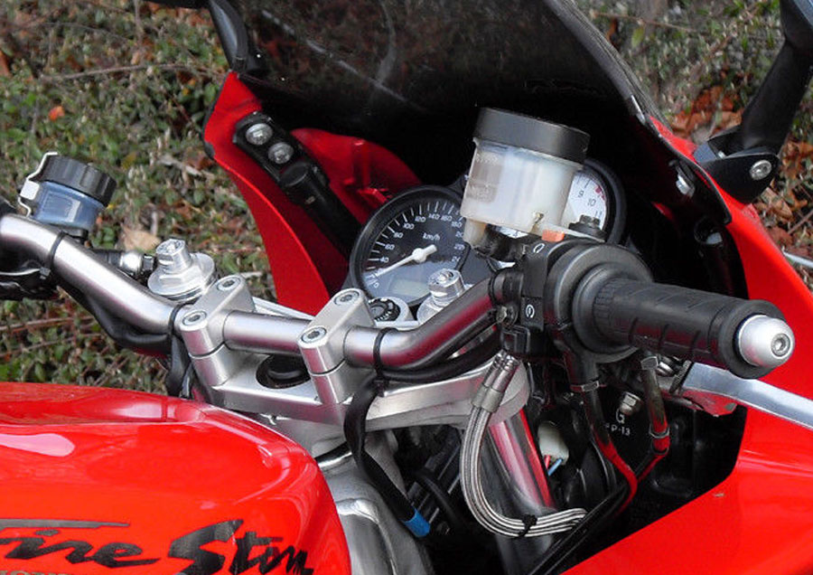

A good idea would be to contact the seller first to find out how much the bars are raised up from the top of the top-yoke, hopefully similar to my risers, by 19mm (3/4"). Then at least if you use Renthal Ultra Low h/bars like I have you will then know by using steering stops you won't need to trim the fairing, if that's what you are hoping :)

You're most likely thinking of the CNC top yoke conversion, or one similar to that.
Have a look at the picture below from that link :shh:

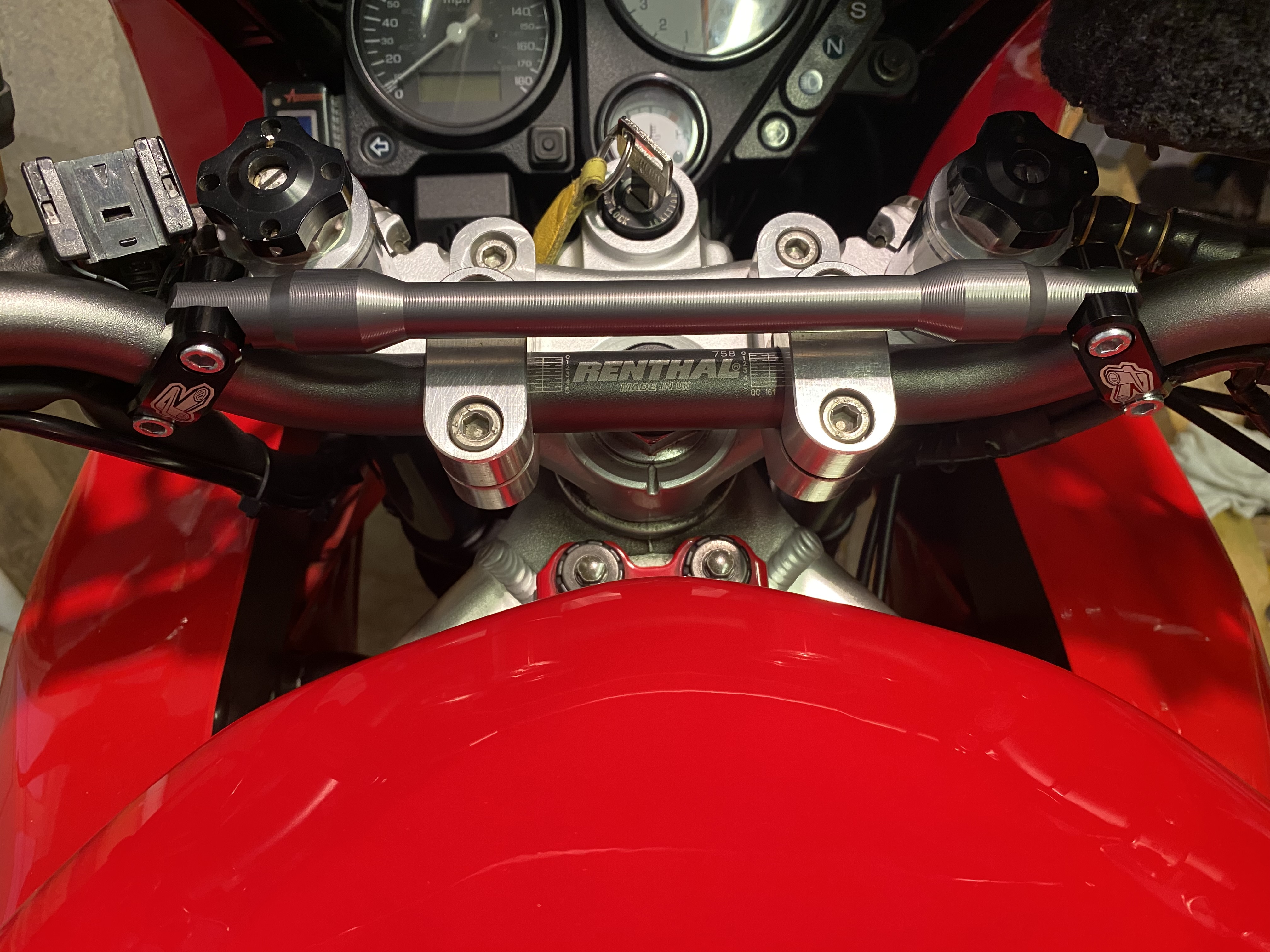

I had been thinking about this for a while. I noticed some flex in the Renthal Ultra Low handlebars I fitted, mainly when picking the bike from the side stand. So after a recent discussion on this with a very good friend of mine I have decided to fit a Renthal handlebar brace.
It has certainly made the bars more rigid.

Looks a quality bit of Kit Chris.
and there I was thinking your stunt riding, wheelie days were over :D
Life in the Old Dog yet, eh?

Is the obligatory Rental foam tube cover going on it? Otherwise, you might find out where the phrase "brace and bit" comes from...

Yes, it is a very nice quality piece of kit you're right Pete :thumbup:
There is no harming in dreaming though is there :D :D
tony.mon wrote: Tue Apr 16, 2024 9:13 am Is the obligatory Rental foam tube cover going on it? Otherwise, you might find out where the phrase "brace and bit" comes from...
:lol: :lol:
No, no foam tubing going on there Tony, yet :wink:
