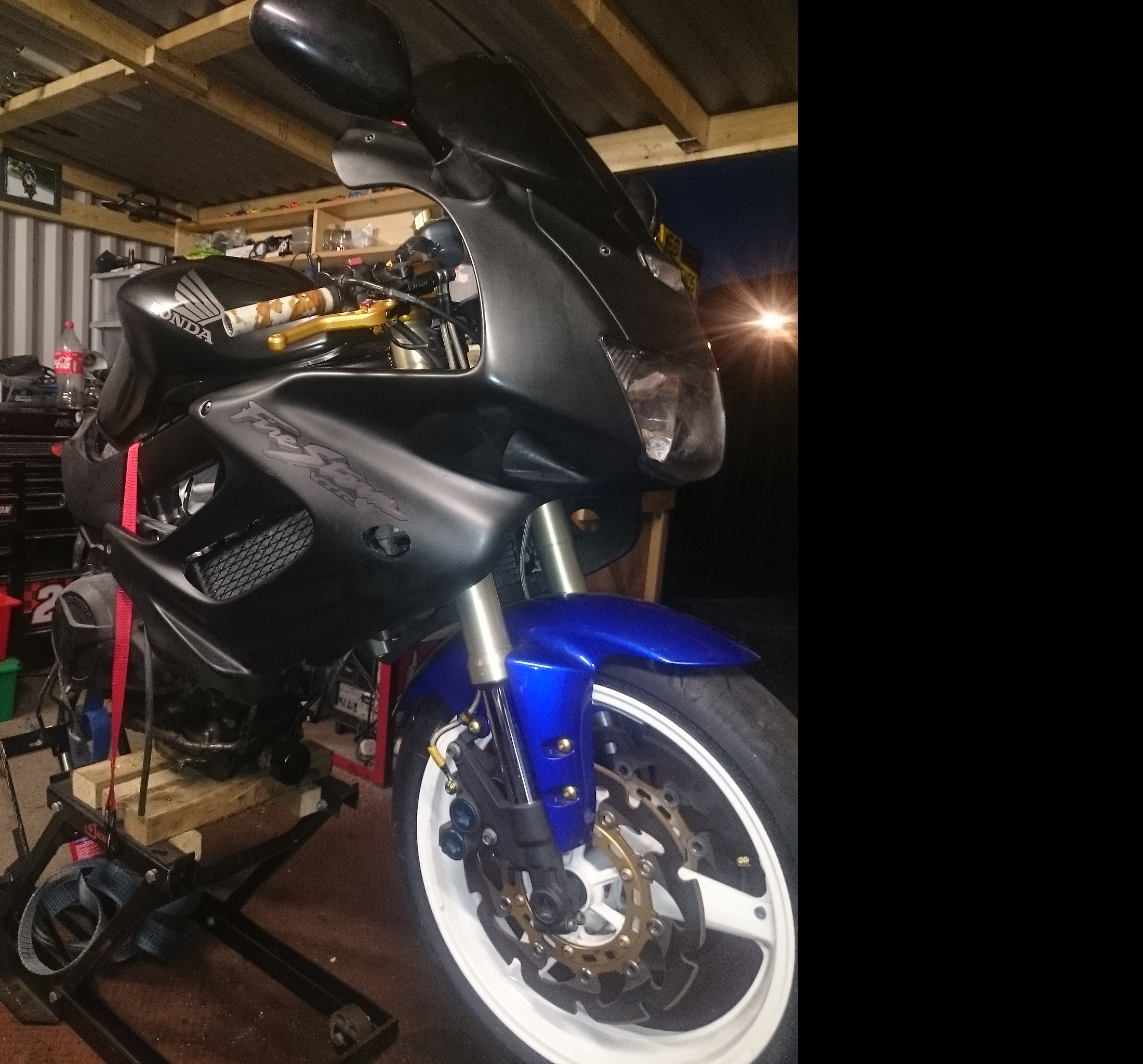

Re: It's that time again.....
And were off... couple hours stripping this evening after taking my red storm out to stretch her legs... Haven't been at all bothered about not riding so far this year but was quite upset when I got back home and the realisation set in that as from tomorrow I may not have a bike on the road at all...
Left the water and oil draining.. all being well the engine will be on the bench tomorrow

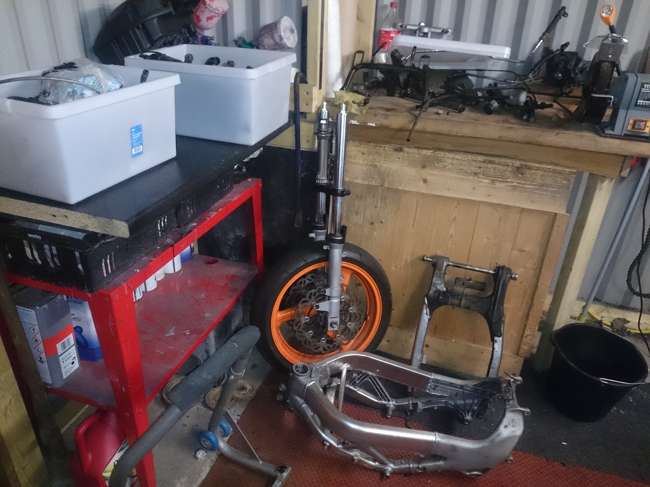

And....... One complete front end, all mint from a 2003 R1
Oh.. and a Brembo rear master cylinder... if it will fit

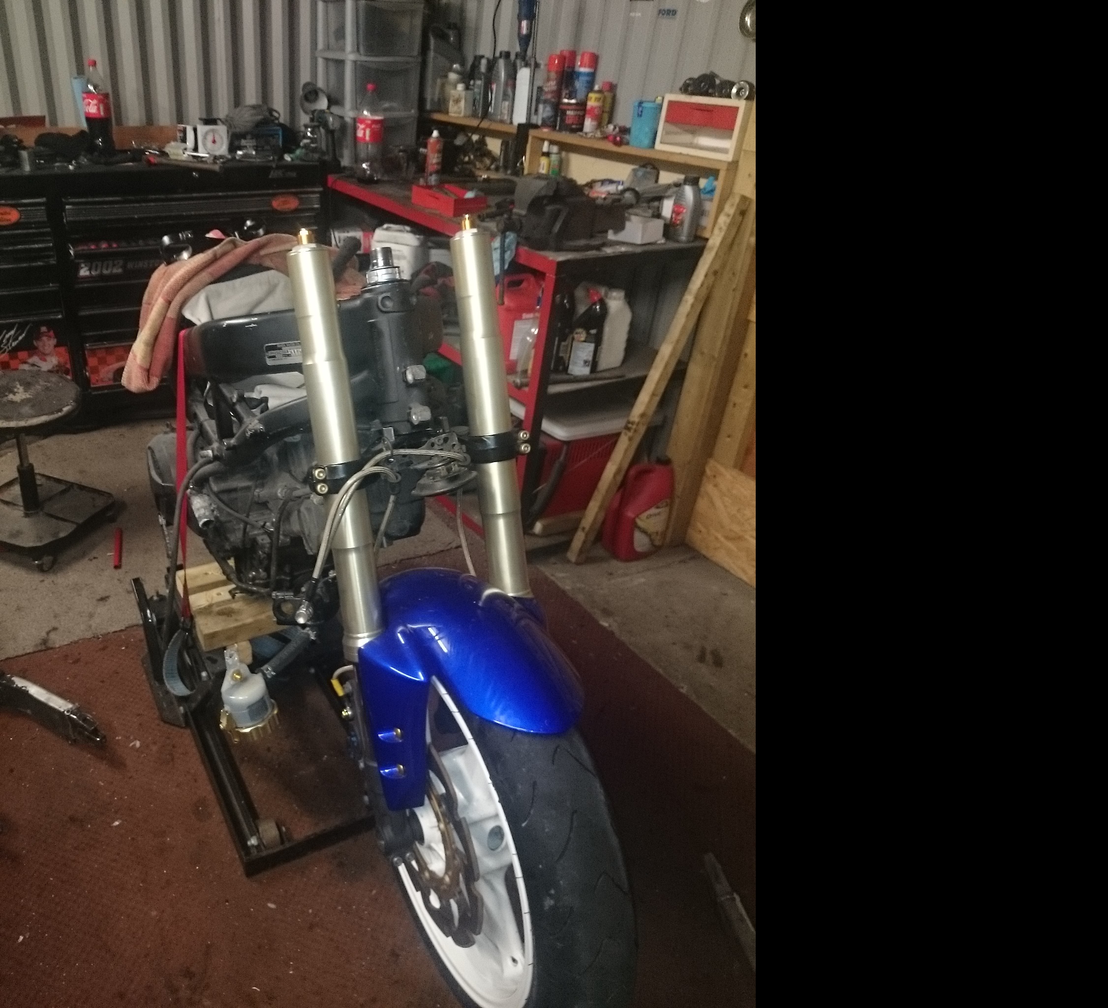

It looks pretty straight forward.. bottom bearing the same as the storm, just need a custom bearing for the top and have found one to do the job... all being well I will have it tomorrow and can do some proper test fitting. Only thing I have to work out... If I stay with the yamaha yokes then I have to work out either fitting the honda locking barrel or rewiring the yamaha barrel to do the job also have to fit the hiss module to the yoke somehow... I could go with 954/929 yokes.. forks fit and solves issues fitting locking barrel but the honda yokes are wider so then i'm into finding or having made wider wheel spacers. The last option.. which i'm tempted to go with is to cut the area that the locking barrel bolts too on the honda yoke off and getting it welded to the yamaha yoke... Don't have to cut anything off the yamaha yoke that will effect it's strength.. would just mean sitting down for a while at a bench afterwards with files and dremel at hand so to clean and smooth the welds up before powder coating.... all sounds rather crude but it is doable as long as the welding process doesn't effect the strength of the yoke.fabiostar wrote:good work that man...be interesting to see how the R1 front end swap goes.
As for any progress.. not a lot but at least a few steps in the right direction...
One donor blade swing arm before and after I butcher it
Brace and replacement swingarm all cleaned up ready to go to the welders...
I say replacement because the arm I took off the bike looked like this..........
One cleaned and scrubbed up frame ready for powder coating.....
The front end that i'm hoping to end up with..........
And last but least... for now anyway, the test bunny.. set up ready to trial fit the front end to save me playing around with what is my nice clean frame and all being well soon to be freshly coated frame.
I will use this to mock fit everything up before parts go for powder coating... only other trouble I may have is at first glance I don't think i'm getting full steering lock on the R1 front end.. the bump stops (for lack of a better word) are in different places between the two bikes so I may have to modify somehow either the stops which are on the lower R1 yoke or the lower lug on the front of the frame that the bottom bolt which holds the headlamp bracket on goes through... will know better once I have the top bearing and can bolt up properly.

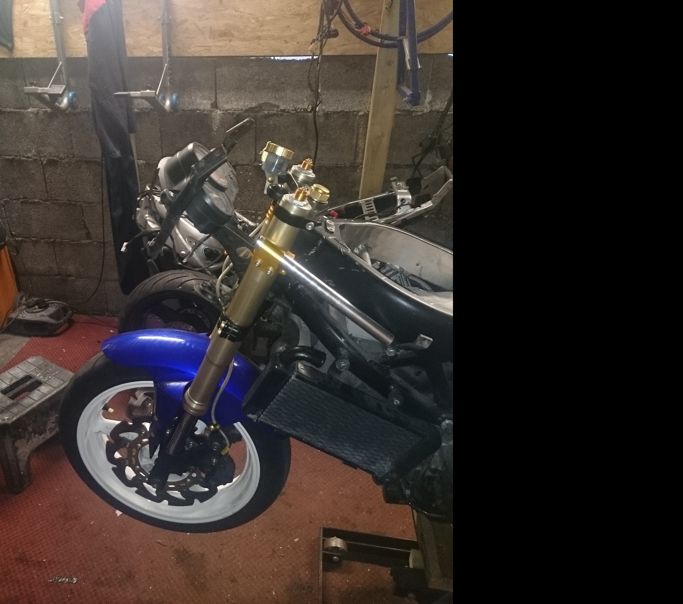

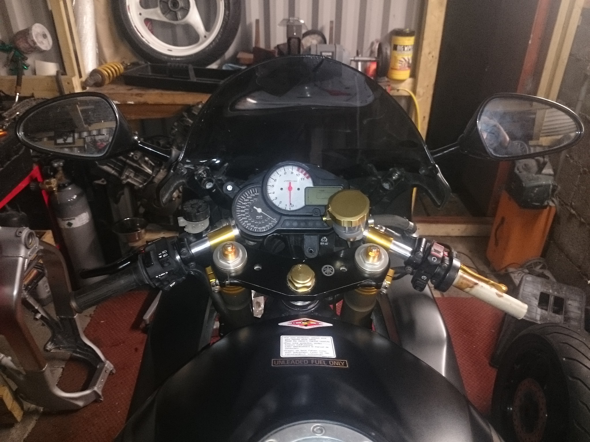

Bit of progress... swingarm/brace is at the fabricators... also has a chat to them about modifying my top yoke as I had mentioned previously... no problem, I have to just do the cutting and shaping and they will do the rest.
Had the new bearings for the top of the steering through the post this morning so fitted them properly to the test bunny to see how everything fits up... few issues, not that I was expecting anything less. Had to remove the small triangular infill panels that the indicators normally bolt to to be able to get full steering lock... will need to do a bit of reshaping but should be able to refit them later on. Have full lock without the bars fouling the tank.. fluid pots both clear the fairing, rads will have to be moved back a touch but was expecting that. Now have to try and get clearance around the top fairing/clocks area... both master cyls are hitting the clocks on full lock but I think that's because the bars are lower than what the standard storms bars would be... if I can find suitable replacement clips approx 1" higher then I think that will solve my problem.. also the levers are hitting the flat part of the fairings where they go up towards the mirror.. again hoping on suitable adjustable bars to take care of that too.... the trick now being to find said bars at a reasonable price lol
All in all happy with how things have panned out so far. As the test bunnies frame is black it gives me an idea of hows the bike will look once I have my frame done seeing as that going into satin black and to be honest I quite like it... Originally was thinking of going all black although it would be different shades here and there but recently came across a cbr600 in a lovely bright red which had black frame s/a etc and really fell for the idea of having my storm the same.. now, not so sure. Not that it matters right now, won't be thinking about paintwork until winter time. Oh.. ignore the gold bits.. except for the top of the forks all gold bits will be coming off!!

Bit more progress.. Had a phone call early yesterday to say my swing arm was ready less than 24hrs after I dropped it off for welding... wasn't expecting that so was well happy. Other than pick that up the most I did yesterday was stand and stare at the bike trying to find inspiration where needed to try and solve a few problems I have... have managed to adjust the clip ons so I now have clearance in all directions although they are pretty low which could cause a problem when turning ie jamming my hands against the fairing. Had previously mentioned getting clip ons with a inch rise... doh! that's what I already have but maybe if I can find another set with a different rake on them.. get a bit more clearance under the bar when on lock.
Need to find or fashion some longer throttle cables because of them routing around the wider yokes.
Put the swing arm and enough other bits on today so I can roll bike about plus sit on and get the feel of it.. see what's different etc. Front end of bike is same height as standard although the clips themselves do feel a bit low compared to the standard storm set up.. not sure how well my back will take to that.. that said I still have to find a way to raise them slightly anyway because of them being close to the fairing so if I can find the right replacements then it may all work out ok.
Fitted the swing arm and rear sets.. then as an after thought I fitted one side of the rear exhausts.. wasn't until lining the fixing point up on the link pipe that I realised I have a bent right side rear set. It's not a lot but it's enough that I can't line the exhaust up properly(link pipe hitting swing arm) gonna have to have a think about ways to try and straighten it.. either that or i'll drop it up to the place that welded my swing arm up and see what they can do.
I was originally hoping to run 6 spokes but that went out of the window once I decided to go with the R1 front end... however, It may be back on. Took the trouble to do some measuring up and basically discs, calipers etc are all good and line up lovely. Issues I have... R1 runs a 22mm spindle where the storms is 20mm.. hoping I can find bearings with a suitable inside diameter to do the job.. if I can then it's just 2 custom spacers and the wheel is in.
I have low level black Scorpions that I was going to run with but since trying these on... really don't know now.. quite torn between the two.

It is steeper at the front but photo makes it look worse than it is... tbh I hadn't noticed until you pointed it out. Got the bike out and stood upright so I could do some measuring but never thought to check the wheel base. With a quick bit of measuring I would guess the front wheel is about 1.5 - 2 inches back compared to standard which on realising started to concern me (no expert on changing front ends so wouldn't know if changes like this would make for any problems) but.. I just had a look at photos of my mates bike that I did a fireblade front end conversion on last year.. his looks basically the same so that is encouraging because I rode his bike when I was finished with it and it all felt nice, he has always liked the bike since the swap was done so hopefully there will be no adverse effects with my set up.grumpyfrog wrote:
Is the angle at the front much steeper now? Or just looks like that in the photo?
Hoping to get a carbon fibre mudguard, not sure if it will be the same design or if I can find something a tad more substantial.. will depend on money, things a tad tight at mo.. at least as far as the bike goes. Only had a little play around with bike yesterday and pretty much sure I need some decent adjustable clips on. I have found a set that will do the job but the idea of spending £200 on them doesn't sit to well with me.. maybe i'm just tight Bar choices right now are between Apex and the only other similar set up I have found so far Danmoto. Both adjust in every direction possible meaning that not only can I alter the height but the post that acts as the rise.. I can turn that to the outside of the fork which will bring my bars back giving more clearance at the front. Decisions decisions
