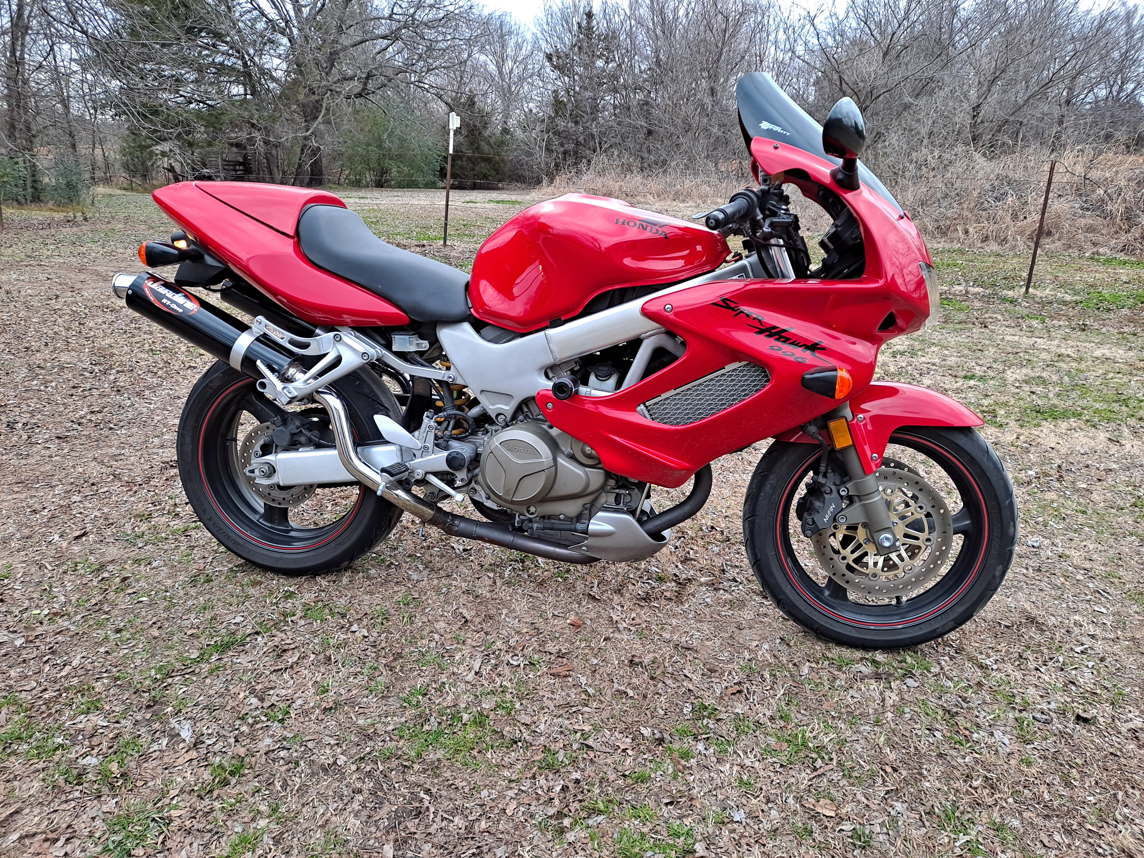

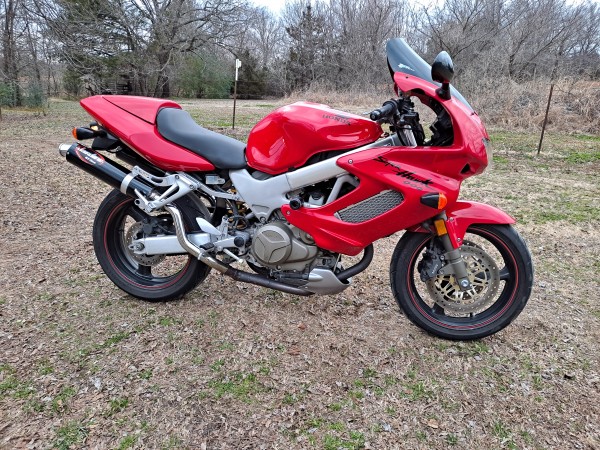

Well I got it back together and took off on it. Let's just say I was gone for longer than I planned and came back with a big smile!!! Thanks or the input. Also I need a new back tire now. It was getting close to ready anyhow but almost showing threads now
