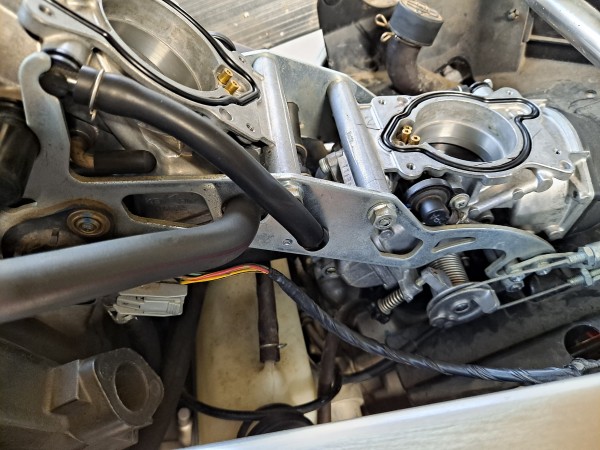

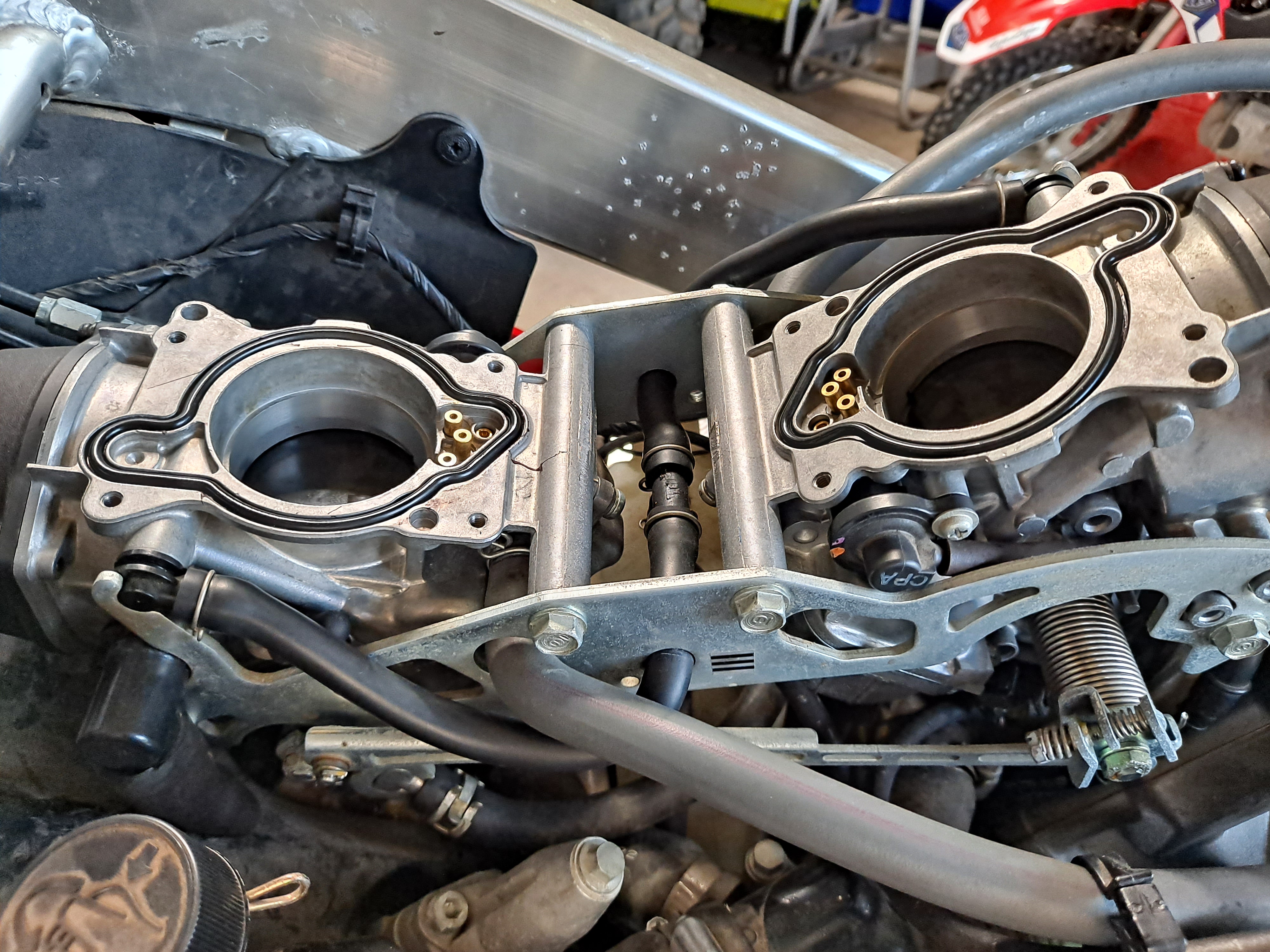

Here is what I have. Yes I know I have mccts on the way. The bike has 9k miles so I figured I am ok for the moment

ramer33 wrote: Sat Jan 30, 2021 11:59 pm 20210130_173153.jpg
I could be wrong but by the pic it looks like you have the float bowl vents tied together instead on being open. On top of that the bowl vents should be pulled out of the carb stays as it can cause issues under hard braking.

I was thinking those were overflow and yes they are tied together. I will take care of that. Maybe that is preventing gas from running into the carbs. So I must have the overflows capped off? Or there aren't any overflows? There is one cap on the rear carb and 2 on the front and all can be seen in the pictures
Re: Carb set up
ramer33 wrote: Sun Jan 31, 2021 4:24 am I was thinking those were overflow and yes they are tied together. I will take care of that. Maybe that is preventing gas from running into the carbs. So I must have the overflows capped off? Or there aren't any overflows? There is one cap on the rear carb and 2 on the front and all can be seen in the pictures
There really isn't an "overflow" for the fuel bowls. I guess they could serve that function but they are the breathers for the float bowls (you need somewhere for the air to be expelled as the fuel enters the bowl) . From the pics it's hard to tell if it has a straight fitting or a "T" in the line but either one could cause the issues you are having.
Even the small restriction of passing the line through the carb stay caused stalling under hard braking on the early bikes. So trying to run both carbs through one opening (if it is a "T" fitting) could cause major issue.
Personally I just removed the float bowl lines all together and just pointed the plastic fitting down and called it a day. It has been working fine for over 20 yrs now.
The other capped lines are vacuum taps and are commonly plugged with no issues. :thumbup:

Yes those lines are connected to a T that runs to the front left side of the bike, i will just pull them off. I just put that cap on the engine breather to keep anything from getting in it while it is apart, they are still hooked up to the air box when I put it back together. Yes I checked the diaphragms for holes. Thanks for all the ideas.
