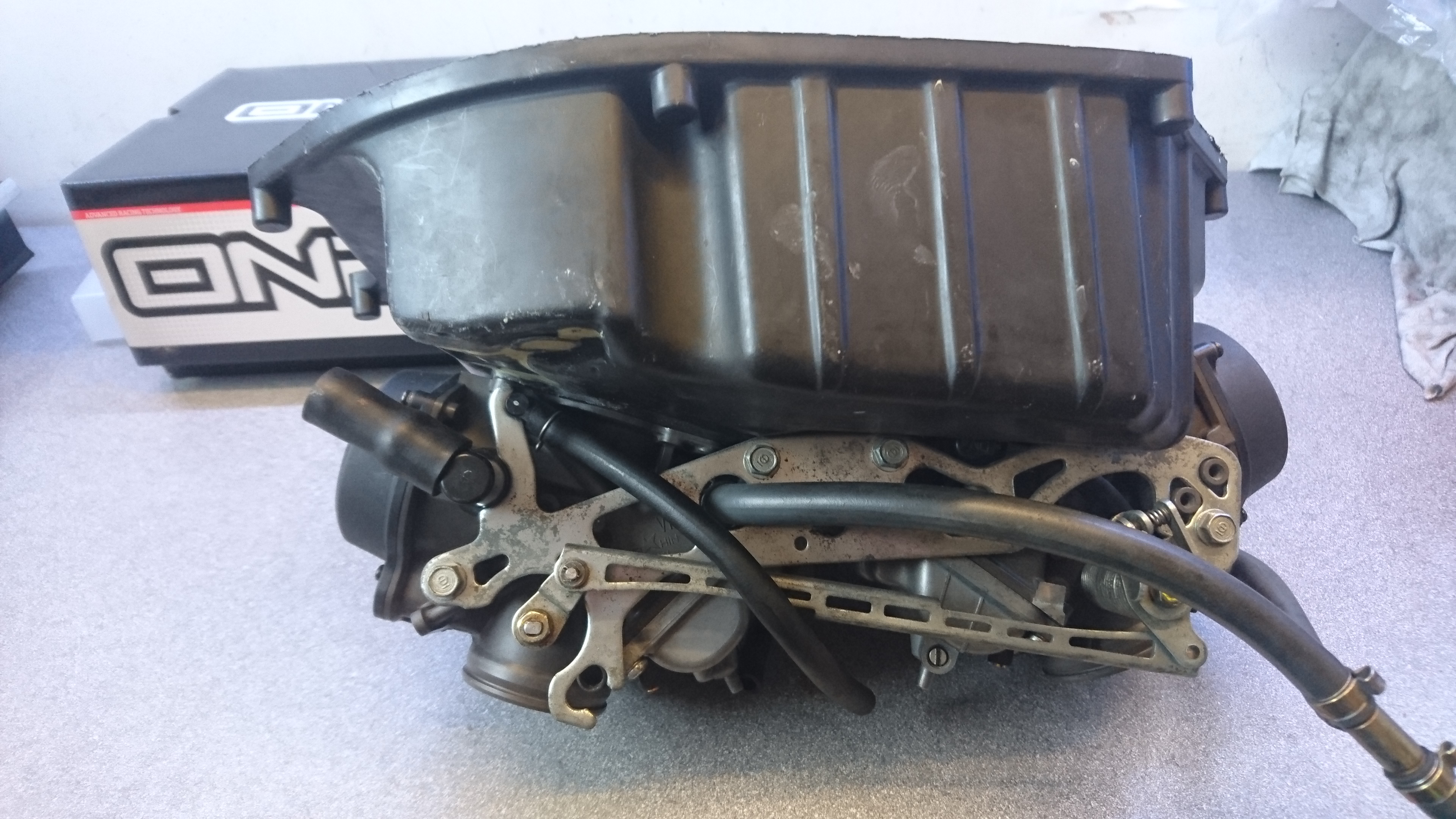

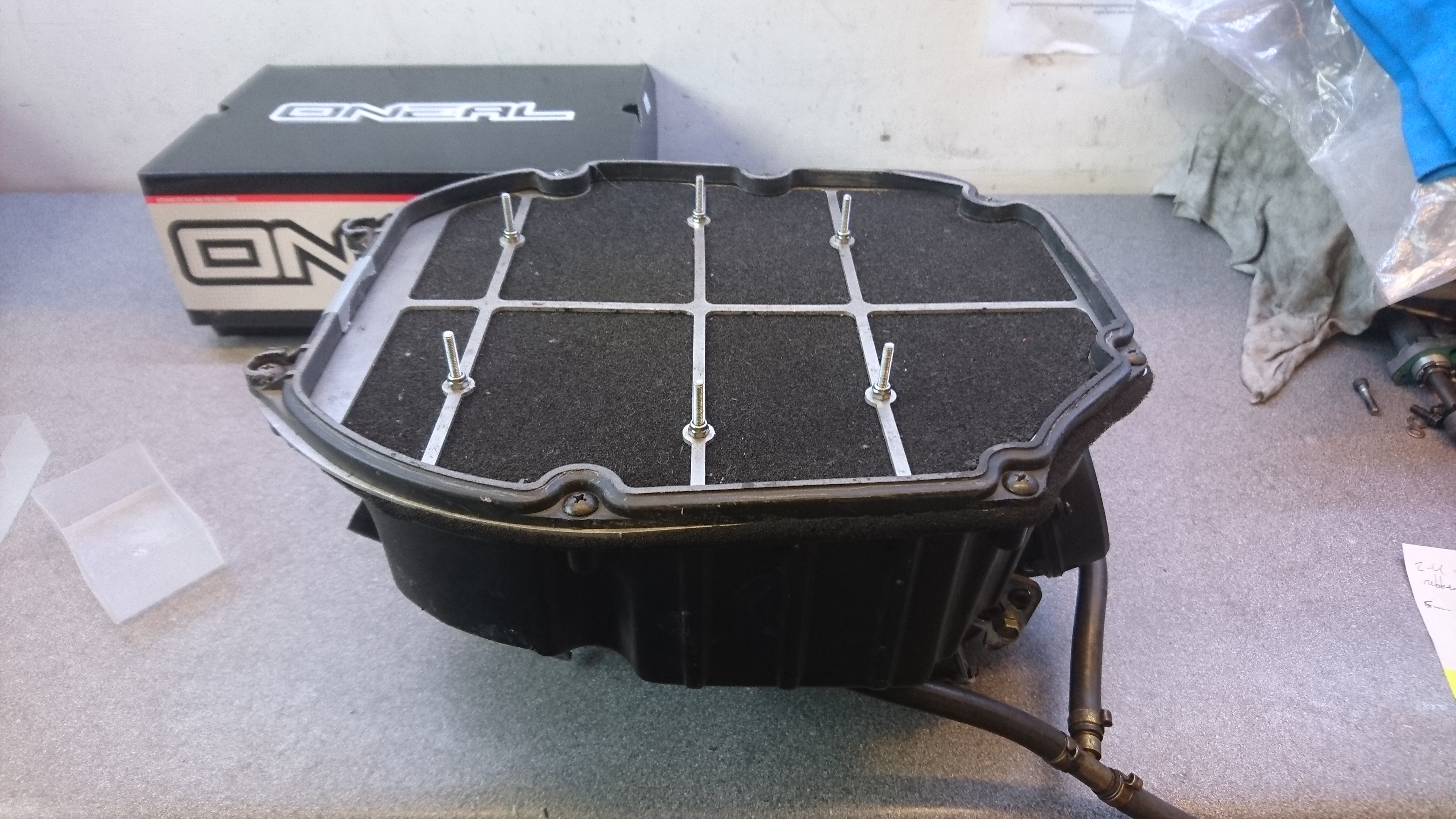

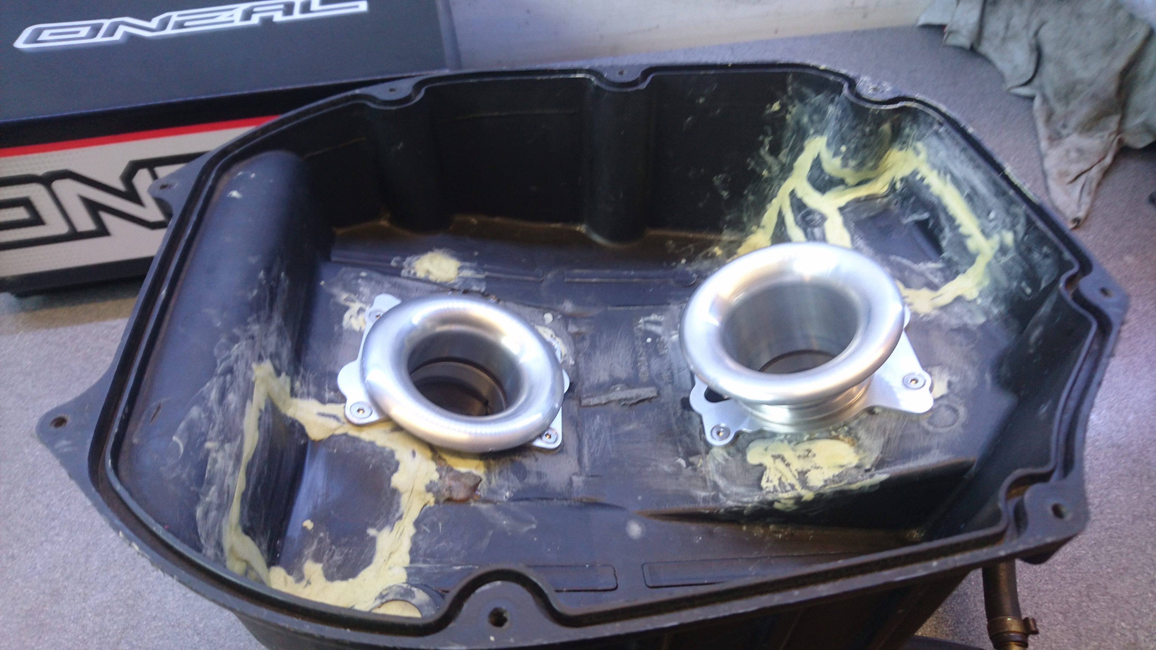

On a more positive note I finally got a parcel of spares through and the rebuild is moving forward again. I'd been busy with the airbox in the meantime so it was a quick job to finish the carbs and get the whole lot back together.

How much are you going to need to raise the petrol tank Nick :?:
Posts: 1593
Re: From 107 to 128
sirch345 wrote: Sat Feb 06, 2021 8:50 pm
That's looking promising 8)
No need to raise the tank. The dyno charts for the old engine were with a standard road frame, with and without the airbox lid, and the tank was mounted in the stock position. So plenty of air could get to the airbox.
When I swapped the frame to the old race frame, it came with quick release front mounts for the tank and these lifted it maybe 15mm. The area where the snorkel would go was plated off but I never went back to the dyno as it seemed to run fine. So with a stock frame I can't see a need to raise the tank if running an open airbox and no heat shield.

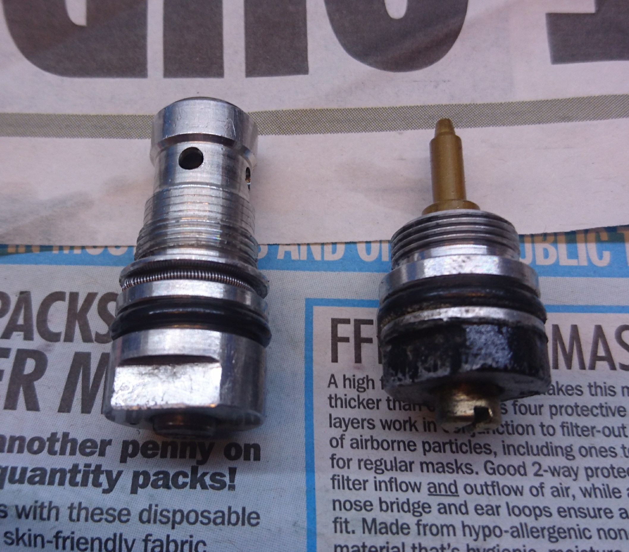

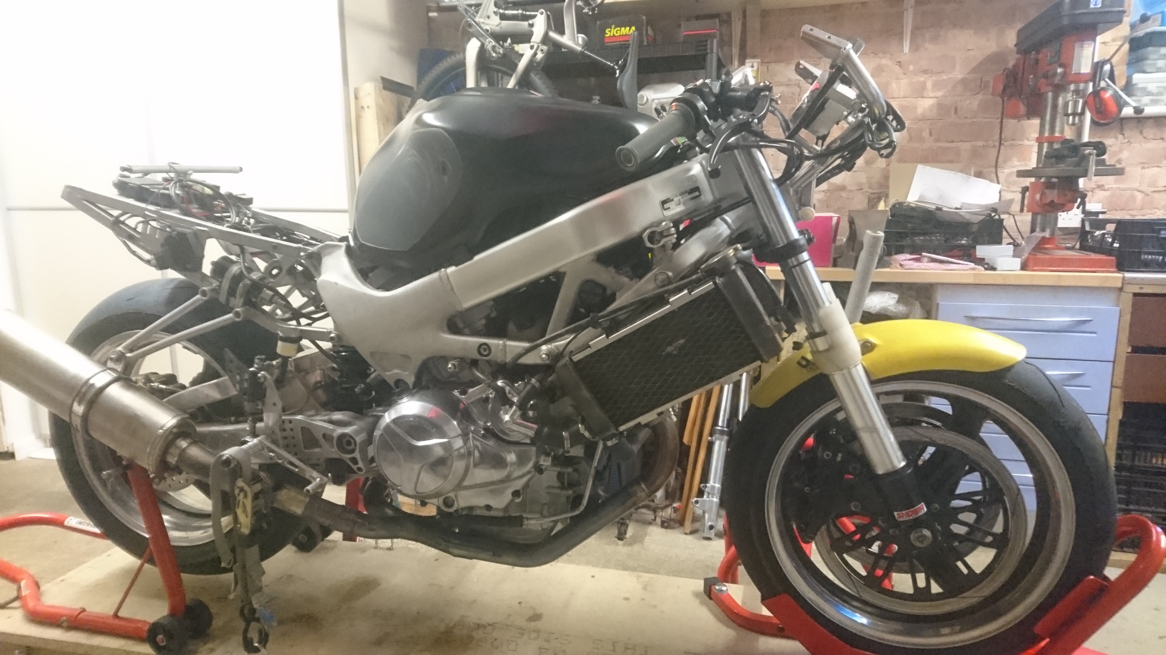

Back on wheels after a lot of head scratching and studying of parts diagrams. I found a set of forks that should have been identical but the compression adjuster was different. On closer inspection the needle seems the same but on the silver forks the adjuster comes out and the needle is sticking out the end. On my broken, brown forks the needle is in a housing the includes all the oil ways.
Checking the sliders, gliders and internals confirmed the sliders should just swap over but the adjuster was bother. Long story short, a couple of conversations with Roger and some more research left me confidant all was good. So having split both sets of forks twice I'm now pretty handy with rebuilds and I've a spares or repair set of brown ones for sale.
All I need now is to seal the clutch cover and fill it with fluids before it goes to Junction 33 for set up on Thursday.
There are still a few odd jobs after that, like brake lines and left grip, but all easy stuff. Fingers crossed.
