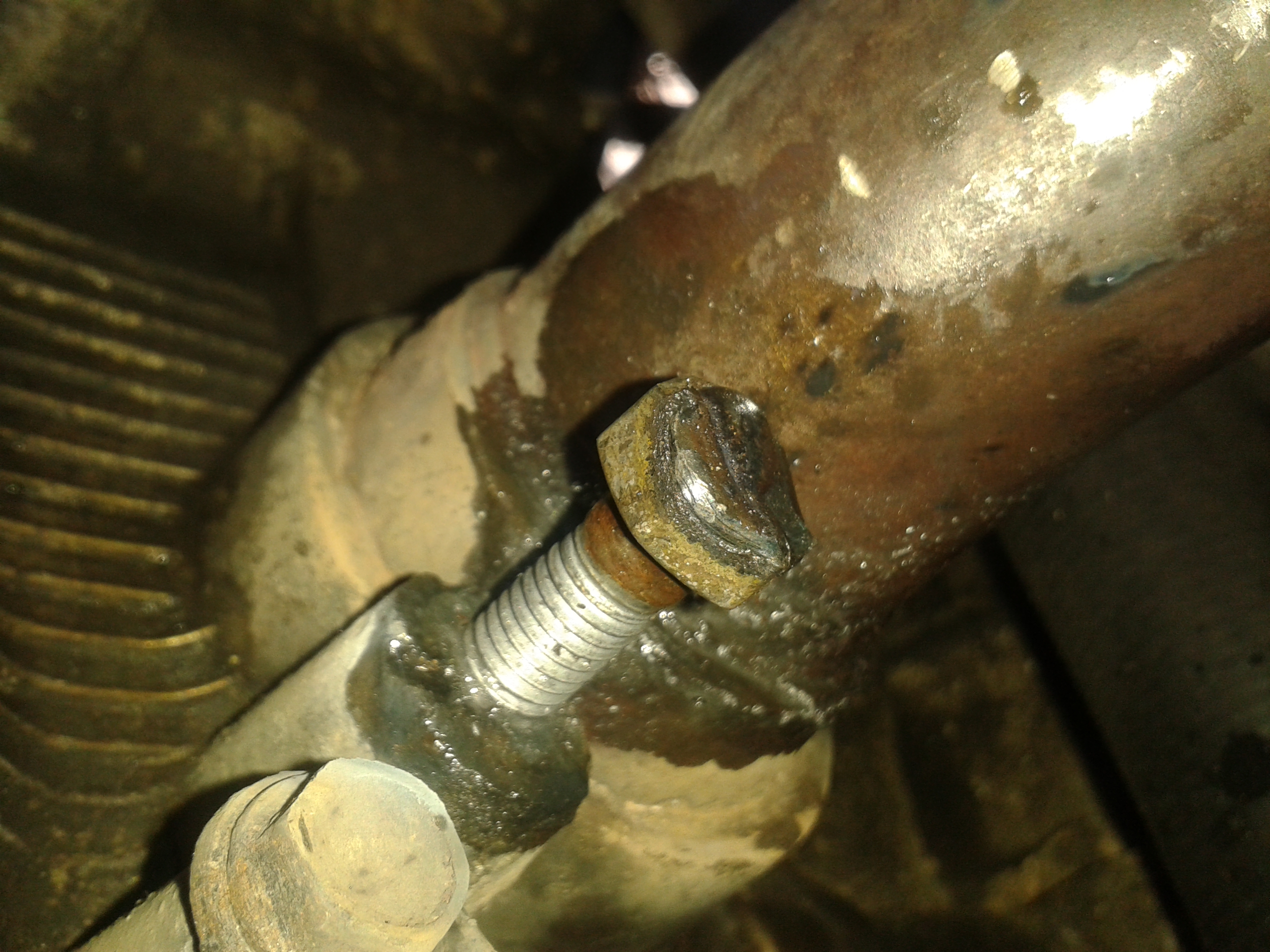

thanks for the info, i was lucky it turned out as i managed to extract by welding nuts to the remaining bits of exposed stud..cheekykev wrote: ↑Wed Jan 17, 2018 12:28 pmIf you go in up to 20-25mm you'll be fine, I went in about 25mm, the stud is very hard so you will need cobalt drills.fatfreddy000 wrote: ↑Wed Jan 17, 2018 10:28 am i may have to do this yet.
if i do i will just use straight 8mm stainless threaded bar all the way.
do you know how deep the stud get into the head?
i dont wanna drill+tap to deep!
removing broken header exhaust studs

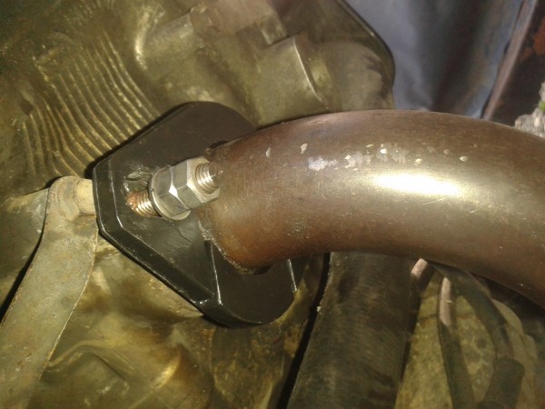

SUCCESS!

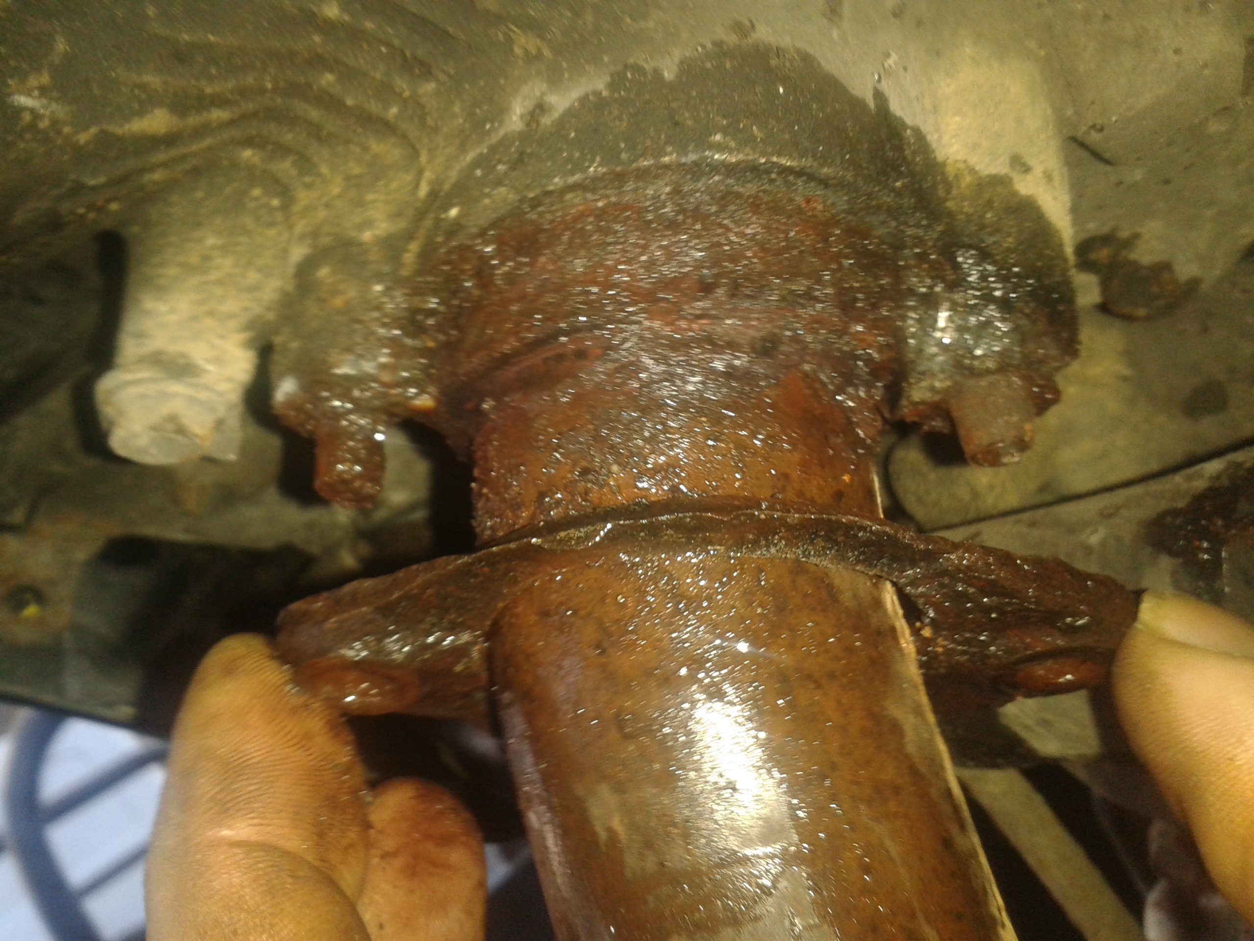

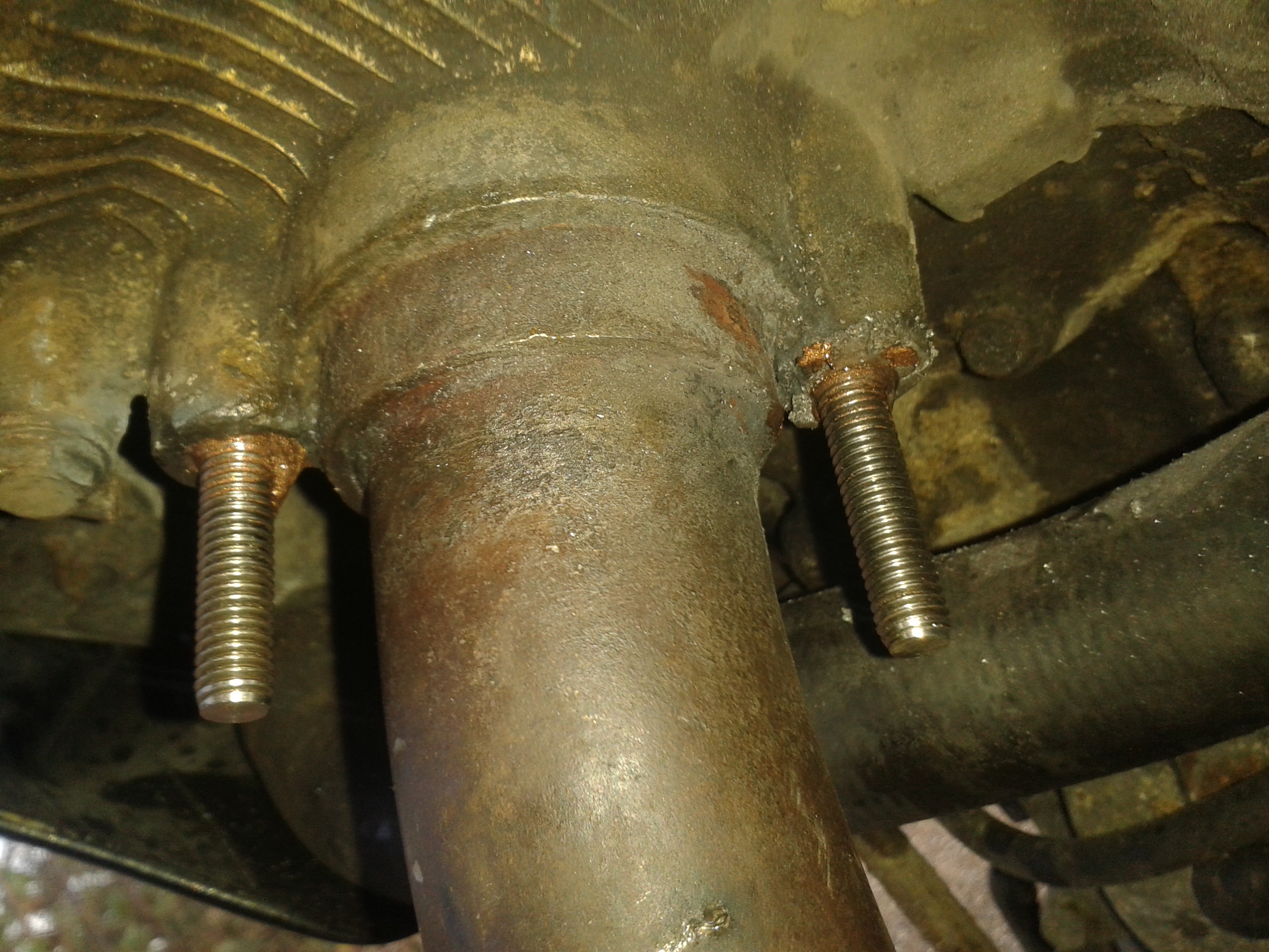

i was lucky and didn't have to drill and retapp in the end.

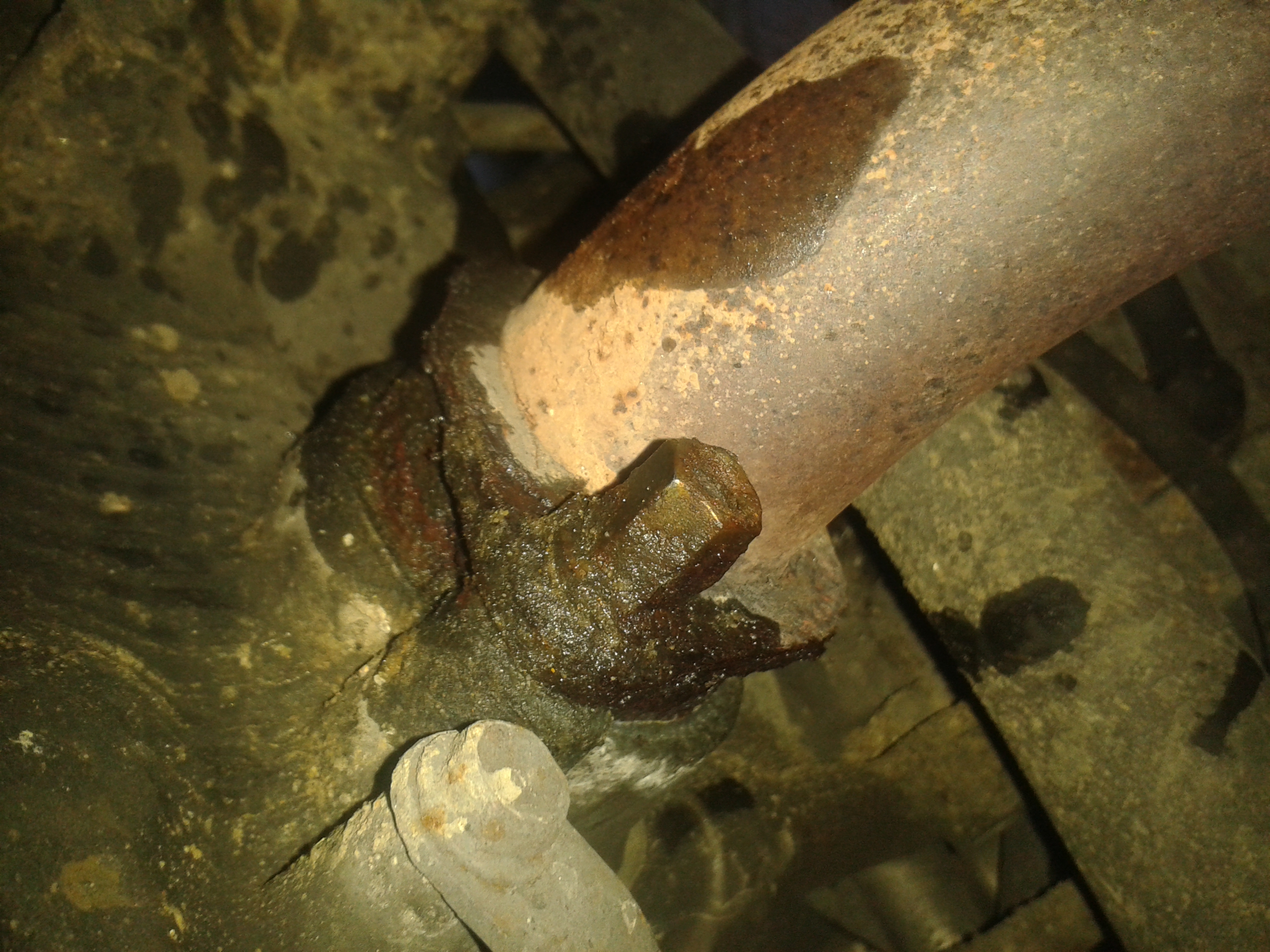

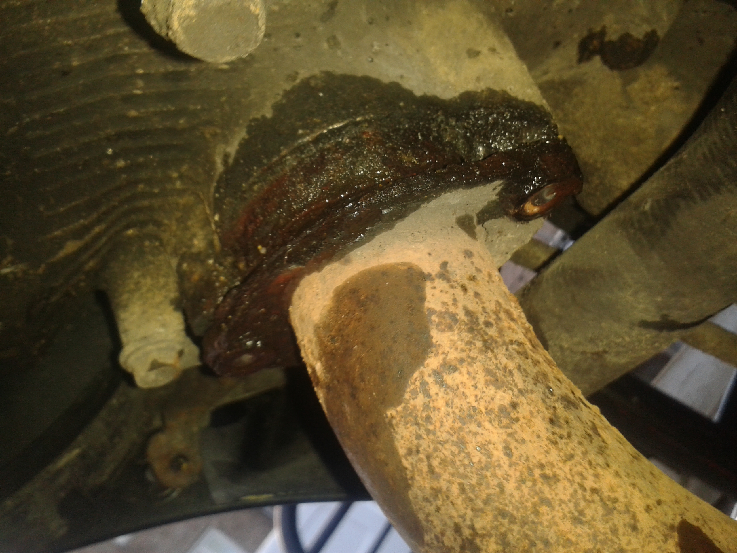

the top stud came out very easily after welding an 8mm nut to it- i think the heating from ark welding really helped.
the bottom stud wouldn't budge and bust a weld twice so i tool a Dremel and Fien tool and cut down the aluminium cylinder boss as recommended and then welded on a nut, and hey presto straight out no bother.

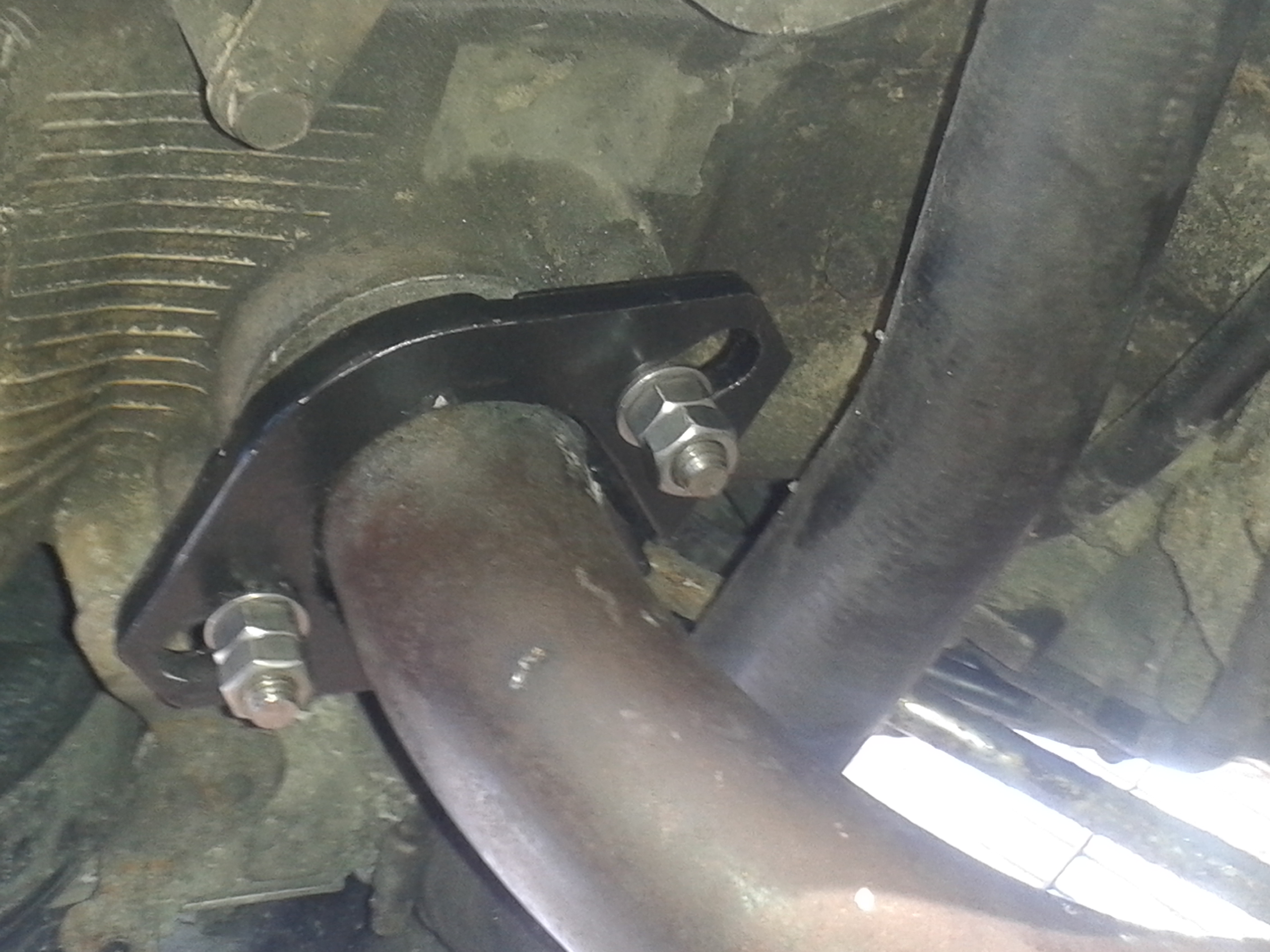

installed 2 lengths of SS 8mm threaded rod and copper slipped the internal part.
split flange went on easy.
it could be tidier but its a dammed site better than it was.

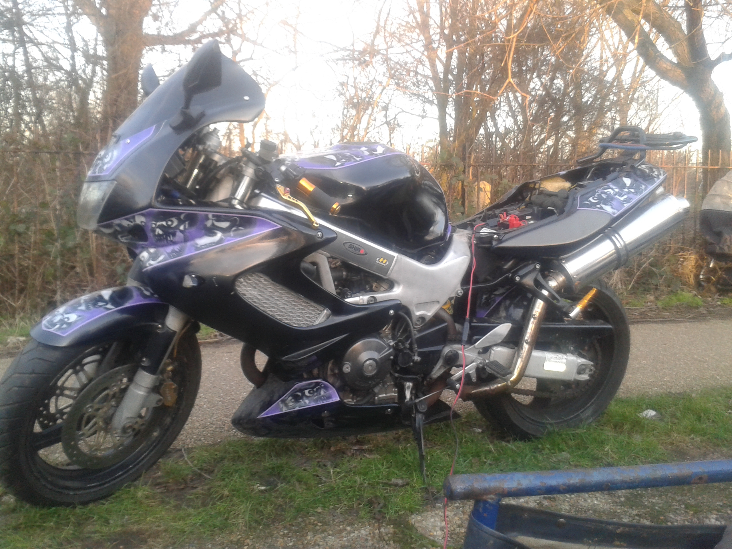

i will be removing the entire exhaust next (should be easy now) to replace the rotten clamps and reposition the hi mount cans so they don't hit the rear wheel when i hit a speed bump or wheelie!
she'll get there in the end- 16 years of neglect by the looks of it..

Re: removing broken header exhaust studs
Top work Mr Fat ...
you did a good job there, well done for sticking at it
- alanfjones1411
- Posts: 2798
- Location: watford
Well done that man.
Looking good - should get through a few more winters.

Now write on your calendar to slacken off and regrease spring and autumn.
Glad it went ok.
Glad it went ok.
good work sir, a really horrible job to have to do
