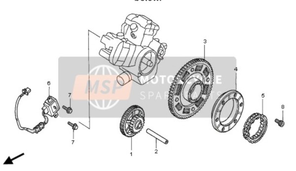

Hi guys i want to replace starter clutch and can't find any is there anyway to replace it from another bike model? I heard blackbird's will fit?

You’re looking at the wrong part,
Posts: 15996
Re: HONDA Flywheel Starter clutch replacement
It is either the starter sprag rollers or the paired gears number 1 in that part diagram.
Posts: 7607
yup its more like the number 1 gear, iv had that :thumbup:
