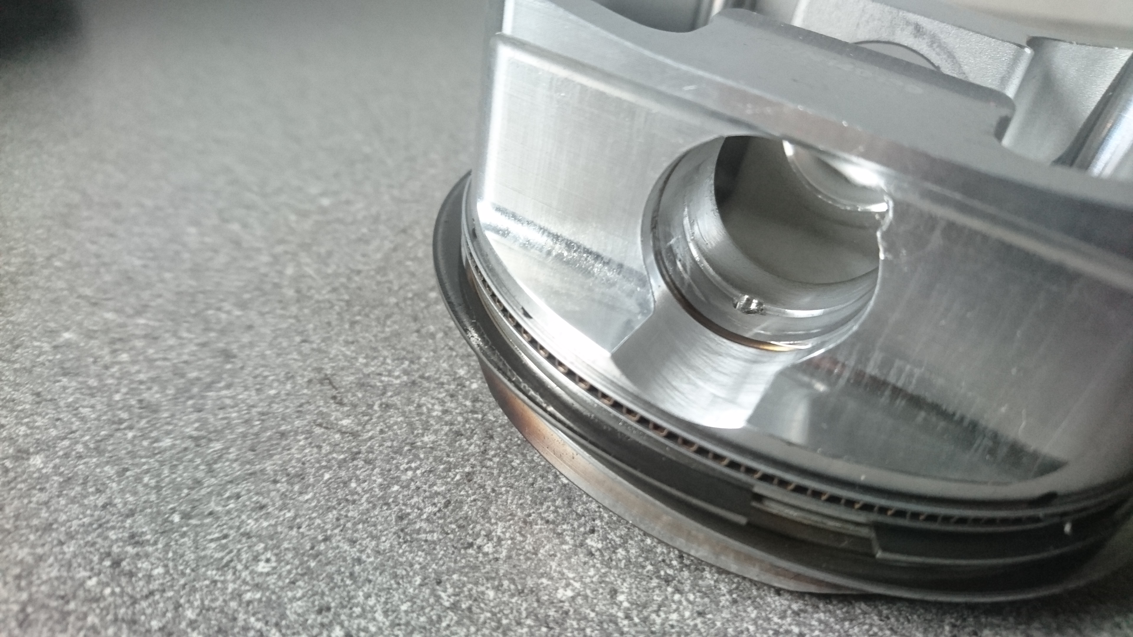

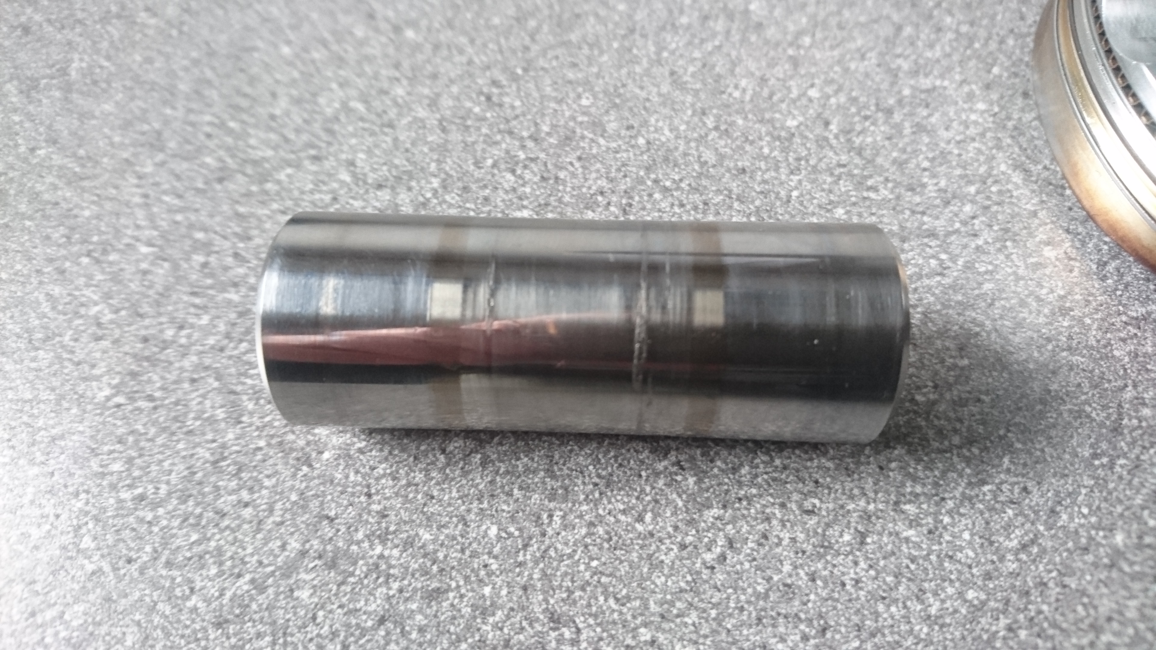

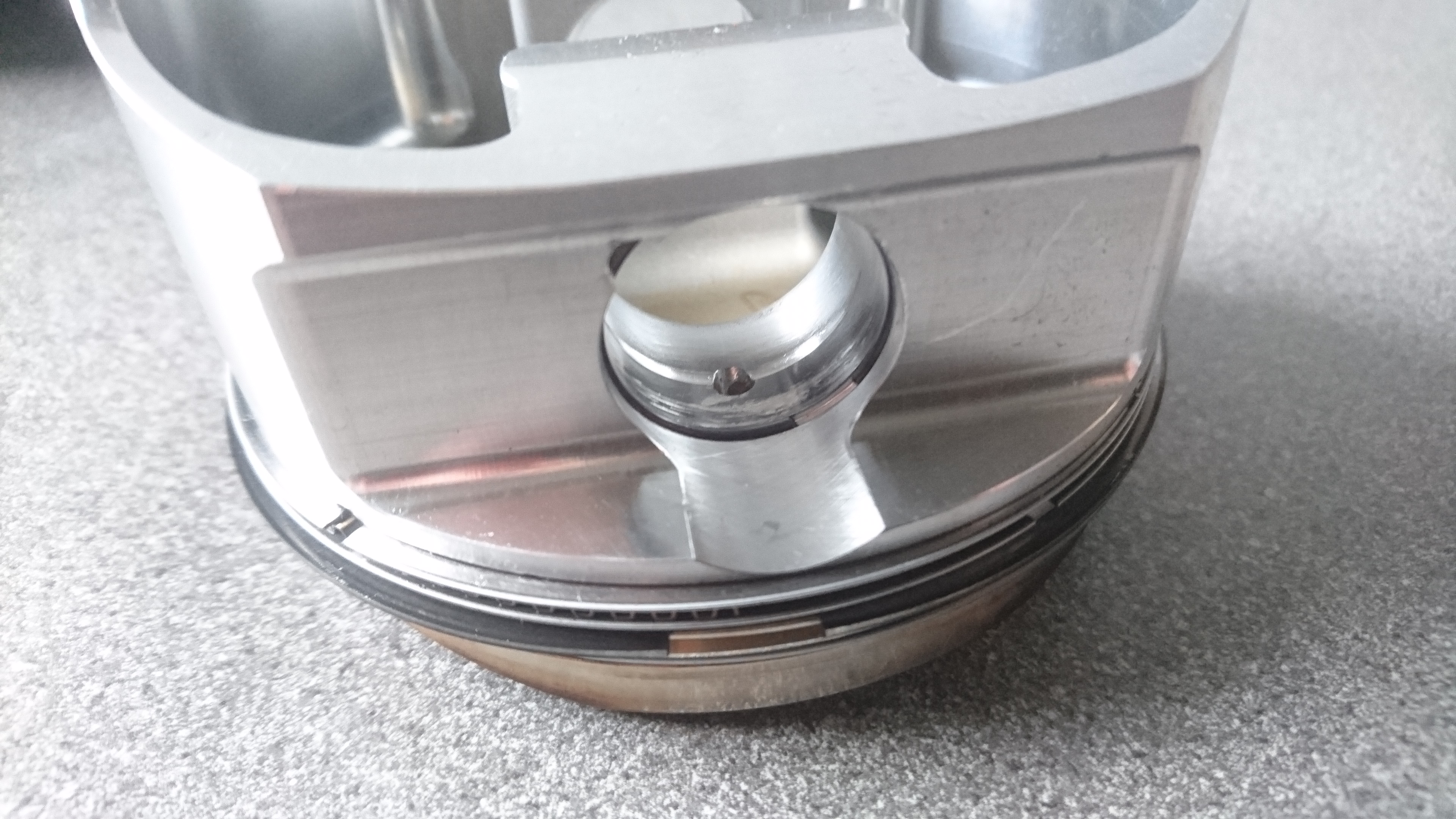

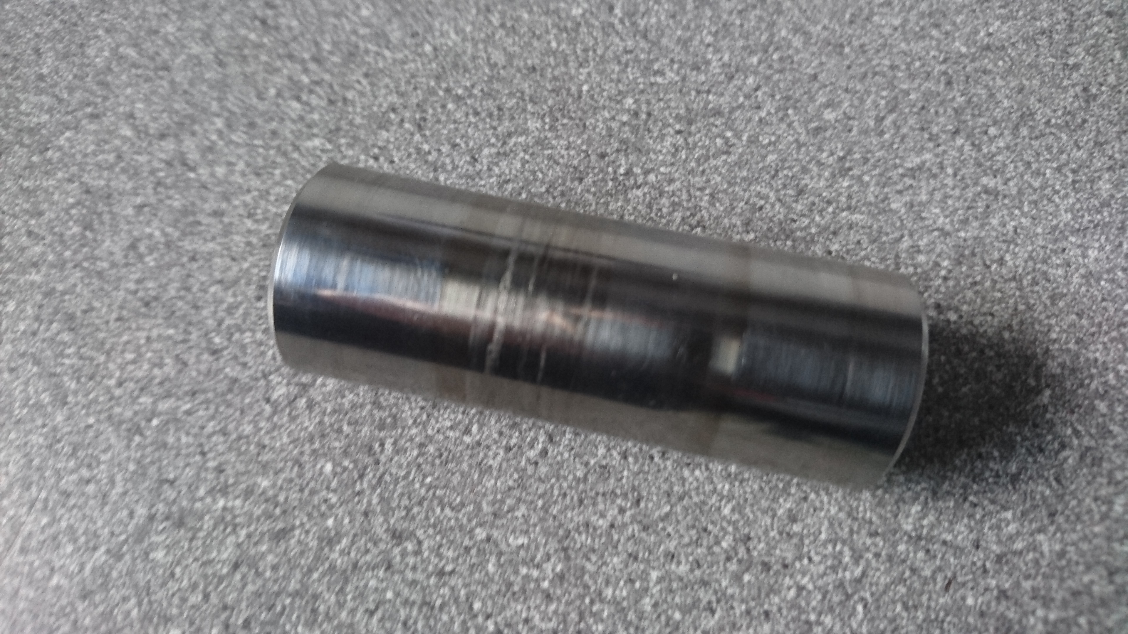

The cases are scrap and I think the pistons are too. Photos below and opinions very much appreciated. The wear on the bearing surfaces for the gudgeon pin are not bad but much worse on one side than the other - clutch side. The gudgeon pins have wear marks that can be felt with a finger nail. They can be replaced but I feel like the wear on the pistons would mean they'd move too much in replacement cases.
Posts: 15991
Re: From 107 to 128
You might get away with the piston skirt marks but they would wear quicker than normal. I assume that the pin grooves are in the small end area rather than the piston journal area?
The other option for the pistons might be ptfe buttons or dlc coating in the skirt area.

tony.mon wrote:You might get away with the piston skirt marks but they would wear quicker than normal. I assume that the pin grooves are in the small end area rather than the piston journal area?
I've never tried that myself, but apparently it lowers friction and heat transfer.
Yes the grooves on the pins are from the small end. They'll obviously be replaced if I use the pistons again and I won't be using the con rods.
