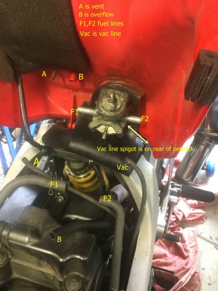

Now in the process of removing the fuel tank to get to the air cleaner, and to also move the choke cable back to its original position.
Q now is - how do I get to that 17mm nut? I can under the 10mm fine, just after some worldly advice to remove the 2nd nut.

That 17mm nut is the shock top mount - leave it be .
Undo the ten mill nut and from the other side undo ten mill bolt then slide it out .

Yep that black plate stays where it is...
The tank pivots on a bolt that goes through that bracket & the tank.
Start at the front...
At the front of the tank 2x 8mm bolts & washers cover rubber gromets which should have top hat spacers fitted from underneath.
Lift the front & remove the top hats, they have a tendancy to drop out so be aware...
Prop the tank up & undo all the pipes... see below for putting them back...
Now lower the tank back down & find the black wire for the sender unit, it will be on the right hand side, follow it back the bunch in the clear shroud in front of the battery seperate from the block.
Now the rear pivot bolt, 10mm nut off, push the bolt through & remove.
Lift the tank off & place away from work area...welll away from tools being dropped & size 9 hoofs...
Do what you need to do & refit in reverse as above... Tank on, pivot bolt in, reconect sender wire, Lift & prop, attach pipes, lower tank fit front bolts...
Job done simples...

BUT when I went to disconnect the hoses, pipe F2 (using photos above) was pissing out fuel - not just a dribble, but flowing fuel. I quickly reconnected the hose.
Is the vacuum switch buggered? Can they be rebuilt?

sure sign the vacuum diaphragm is damaged. yes you can get rebuild kits from david silvers and other places
you can still turn the fuel off using the 8mm square on the tap, so switch the tap to OFF and then remove
