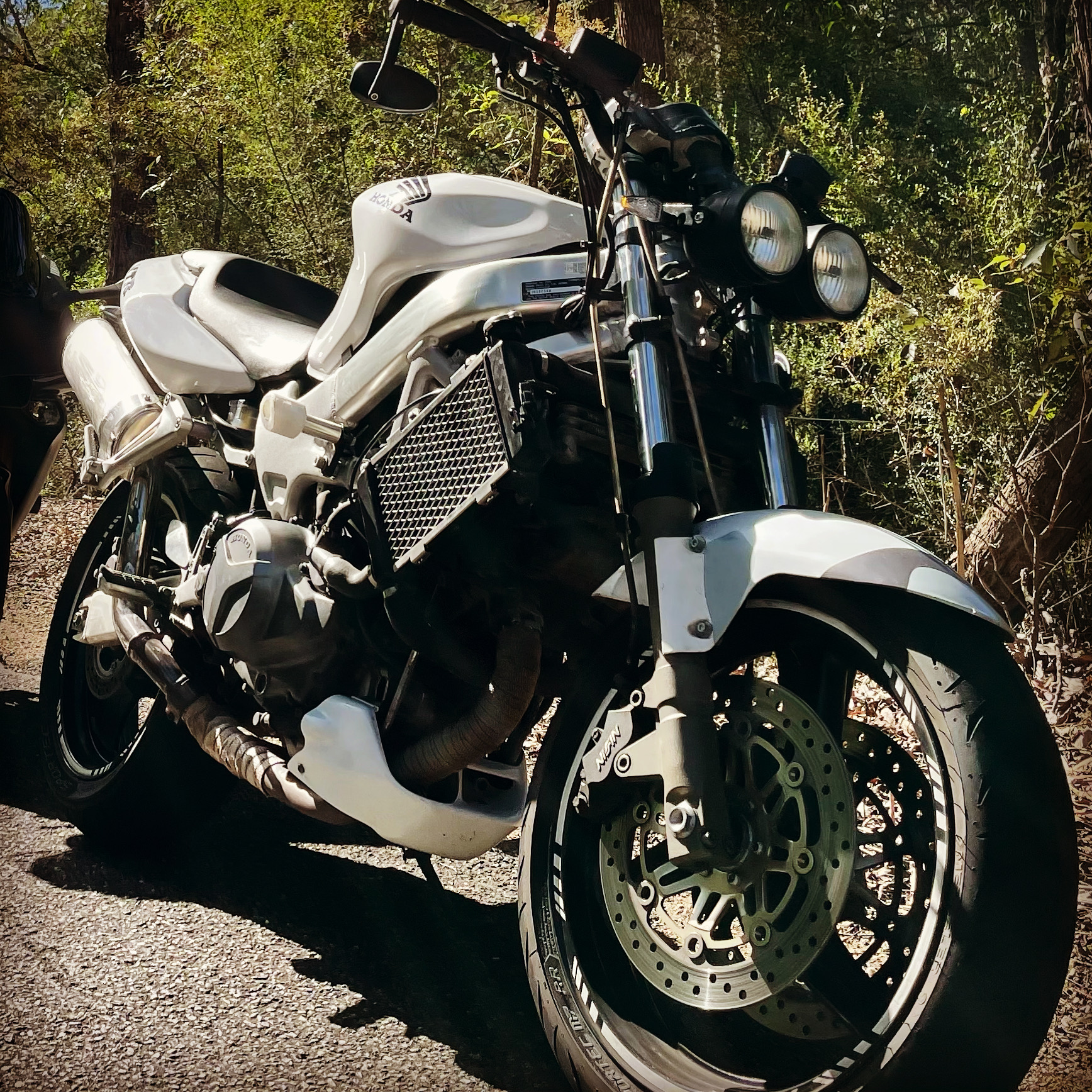

Like these bikes streetfightered, very different with rads all on show! Stick a gas mask over those headlights!!!
Sent from my SM-A415F using Tapatalk
Posts: 2936
Street Fighter Day One (Tips and recommendations)
Rads look better black ImageImage

Duffy1964 wrote: Tue Apr 20, 2021 11:16 am Rads look better black ImageImage
Looks amazing mate. Mine is nowhere near finished but I’d be happy with something similar to yours in my own way
