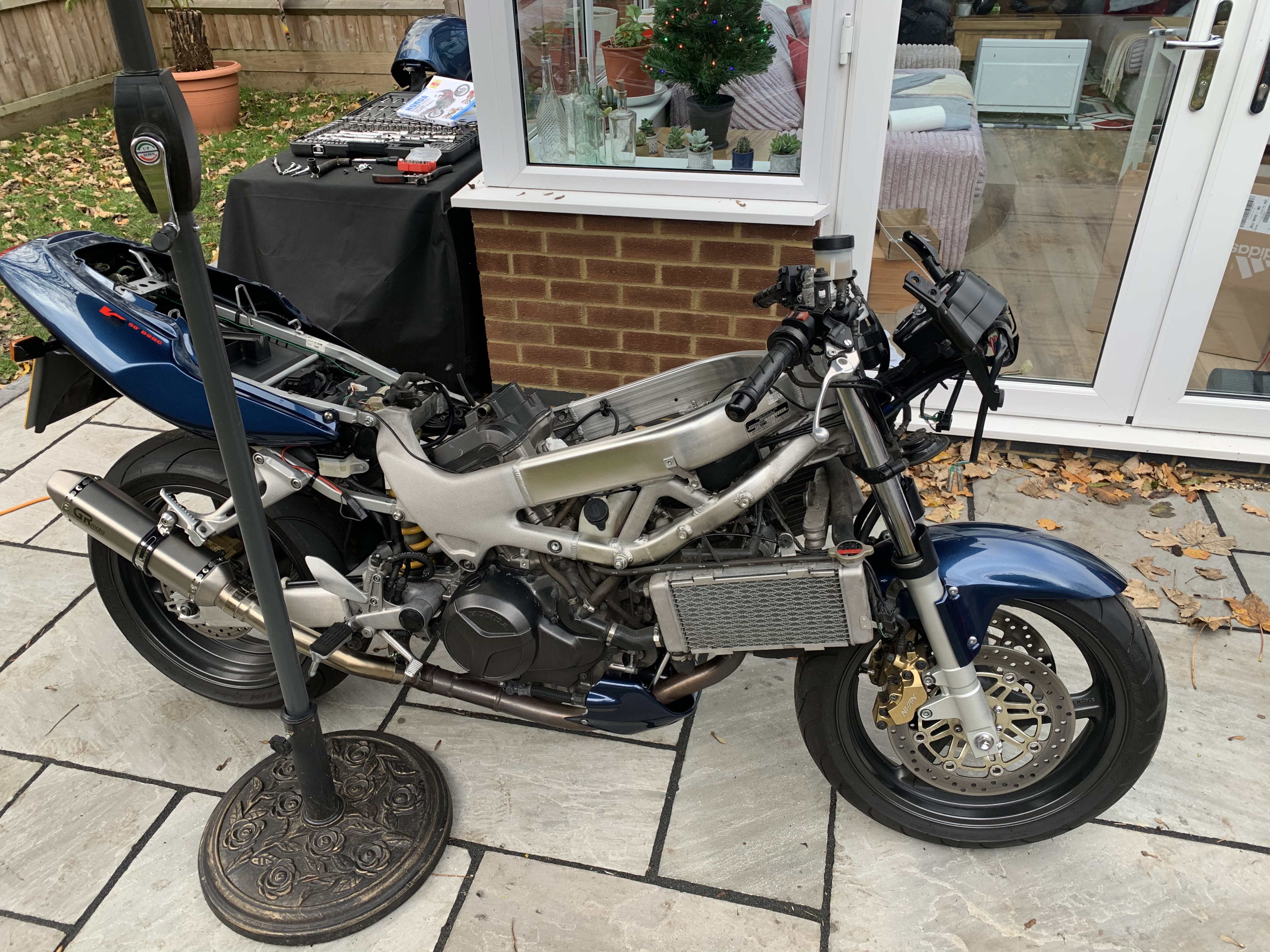

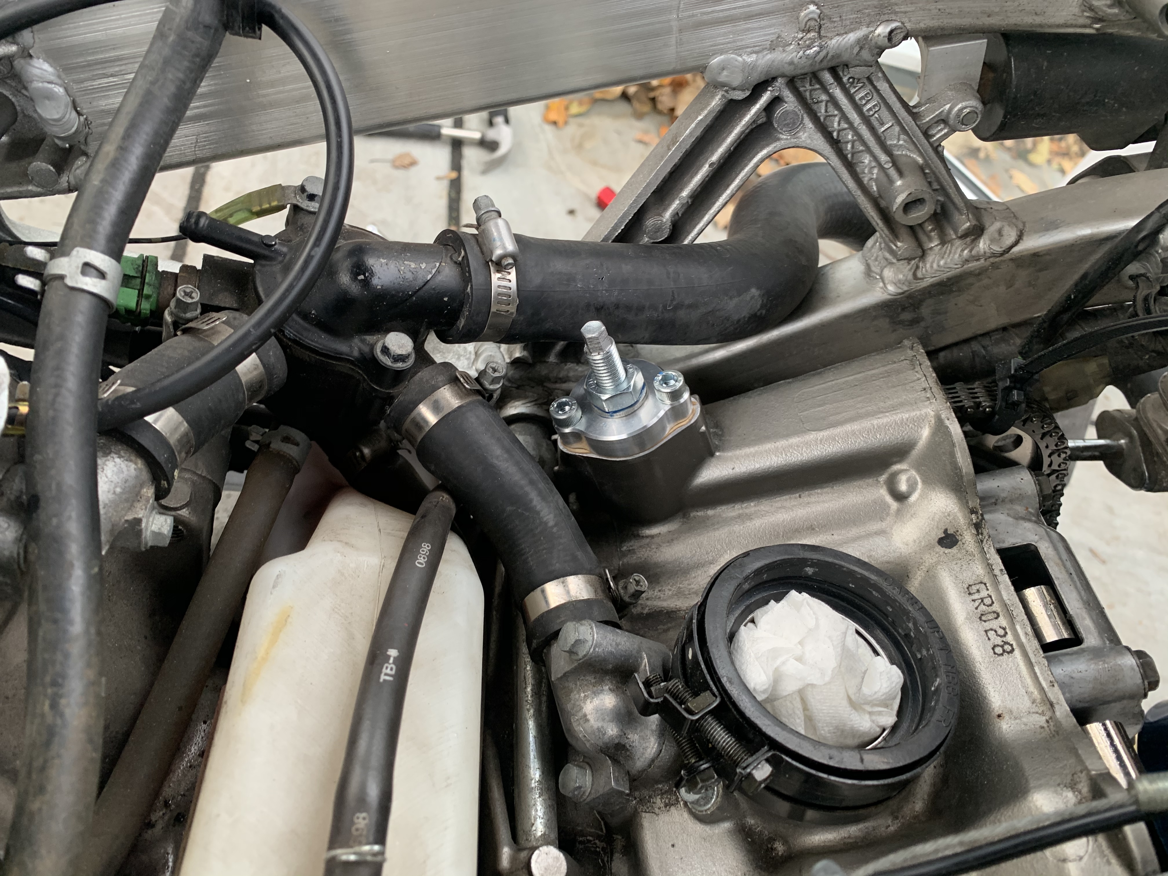

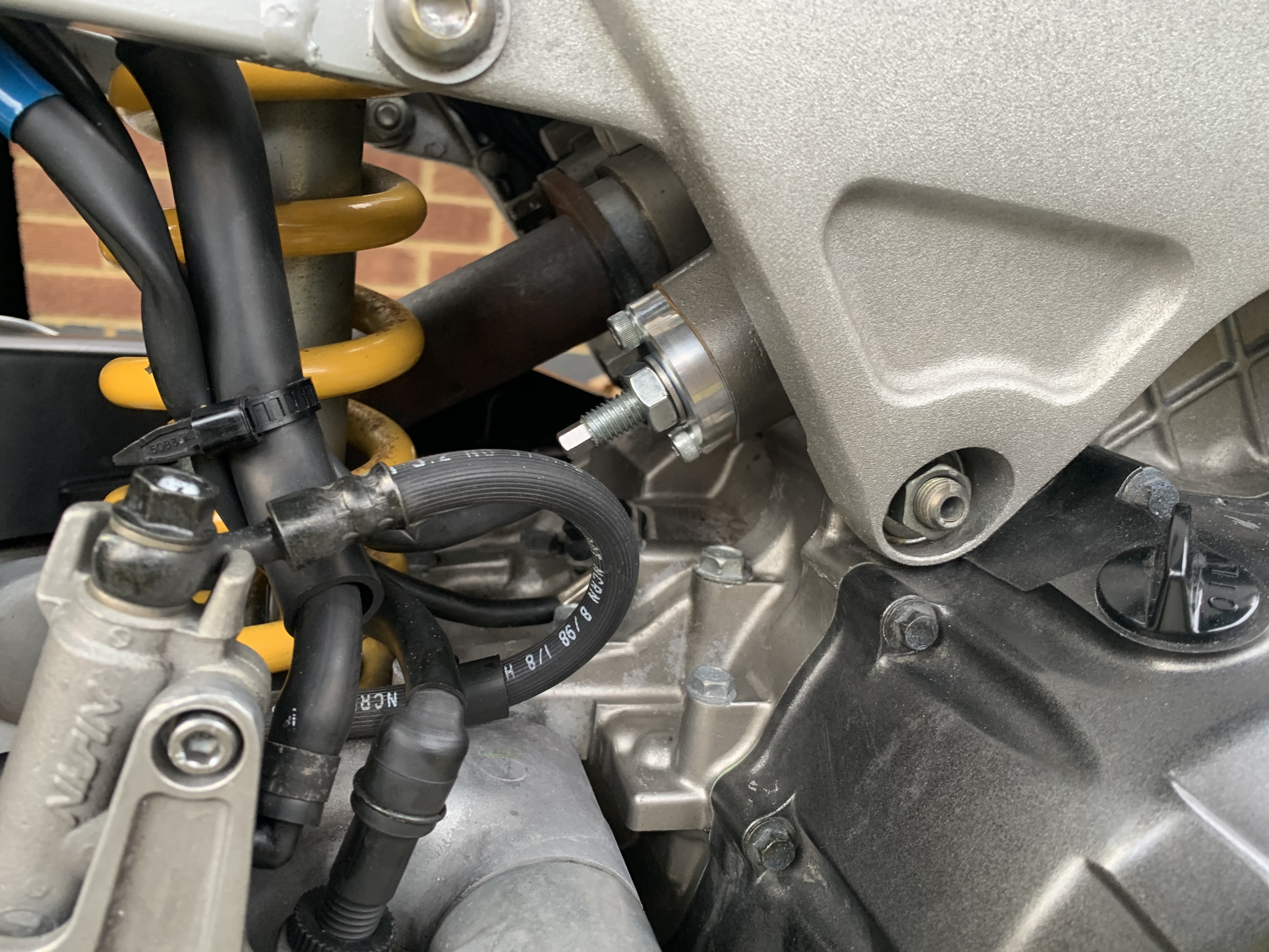

The CCT’s have been done and now are MCCT’s!! I followed the instructions from on here which was amazing and super helpful, though the 2.5 hour job time was a little bit of and underestimate 😂 it too me all day! 6 hours start to finish but I did go slow and take my time. Gonna run the bike at home for 10min once warmed to check for any oil leaks (fingers crossed all good). I did scratch the tank though which I’m gutted about but chips away can sort that soon.

Re: Hello - a new VTR rider
Top man well done.
My go took a lot longer than that
I also completely wombles a tank when I tried to seal it. All slumped in a big pool in one side of the tank. I could have sent it away but found an exact match on eBay so went that route
Posts: 2793
Took me a lot longer than six hours,but like you followed the instructions on this site.I turned it over by hand God knows how many times and was hesitant to press starter.Great joy when it fired up though.

The carbs are a little awks, just undoing the screws around the front carb rubber seal is fiddly but doable with a long thing Philips screwdriver.the plastic tray above the carbs is simple to take off wins bit of wiggling. Getting off the front plastic cam cover is the most awkard for me (got it back on ok though). If you can’t get to the screws (because of the first owner screws you) try a little long hook and try to pull them round to accesse them with a screwdriver (through the hole in he plastic)
I just used my Halfords tool kit I bought half price a few years ago at Christmas (paid £100), only other tools I used was a hammer with rubber end (to tap off the old cct’s and tap the rear plastic cover off) and also used the Honda spark plug socket that was in the bikes tool kit.
I did have some fuel leak out as I moved the carb to the shed, but that’s prob as I held it sideways as I carried it off 🙈 I didn’t see any fuel residue at the mounts.
I didn’t re-sync the carbs, they are running just as good as before thankfully. Long as the mcct’s are set right you should be fine.
Would recommend having the Haynes manual standing by, I had mine - helped when I got a little confused over some of the steps.
I’m no novice when it comes to engine work but I’m def not expert either! Take your time, read all instructions twice and should be fine.
I was sooooo nervous starting the bike back up! But I hand turned the engine twice round, hit the started and she purred to life, I was soooooo happy!

Just let her run for 10min to get to temp, oil level still perfect and I couldn’t see any leaks around the new mcct’s or the plastic covers and nothing dripping down. Sounds and runs great. Had a little light smoking just under the tank right of the carbs but that stopped and didn’t smell of anything so don’t believe it was a cable (I’d smell the plastic melting), hoping just a little excess oil/fuel burning off. Fingers crossed all should be fine now. It’s def a job that has to be done but sure is a nerve racking one to do yourself 😂🙈
