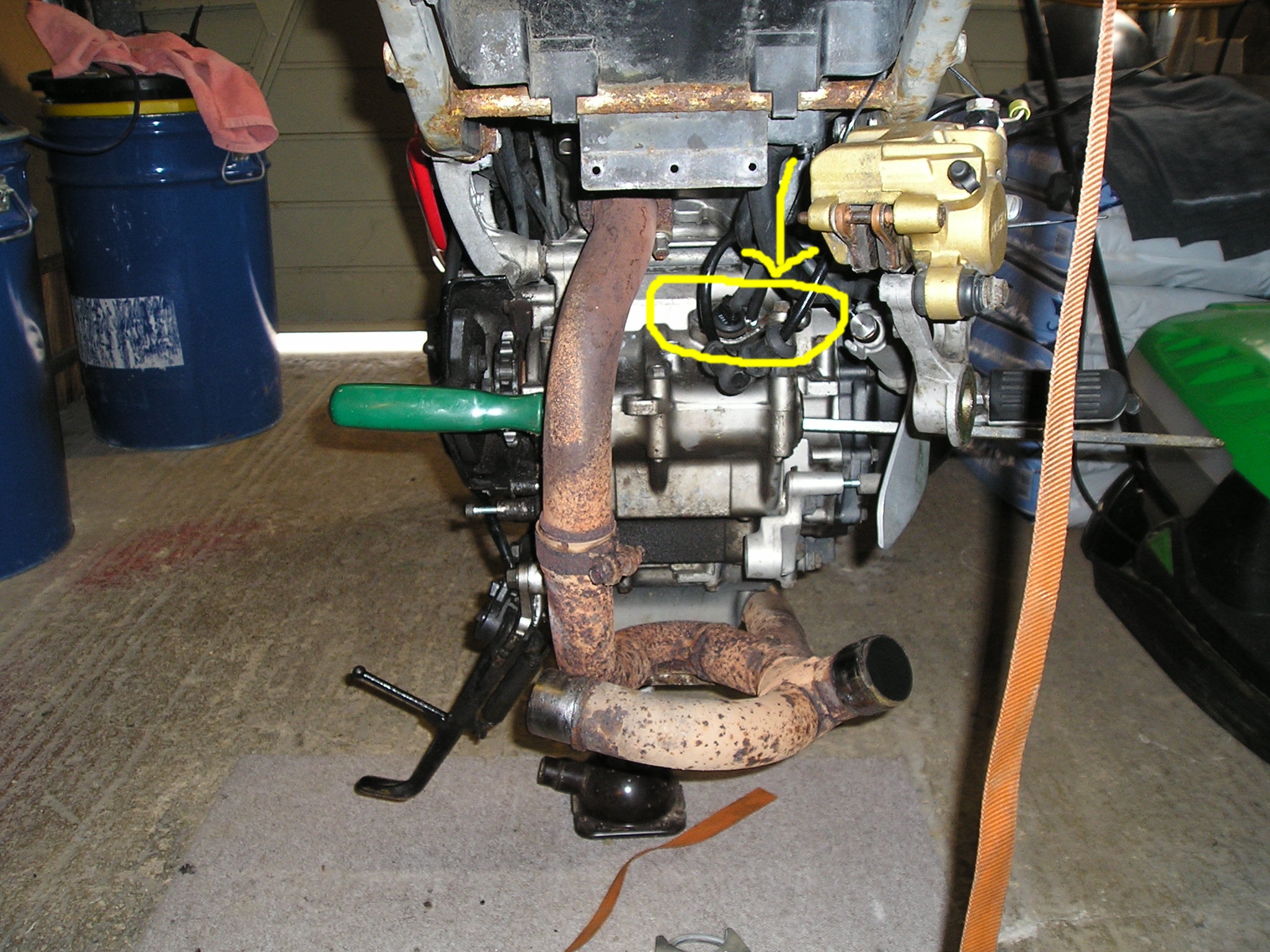

Speedo sensor is mounted on the r/h side of engine casing I think it must take it's reading off the gear box...
Changing the sprockets will alter the reading...
