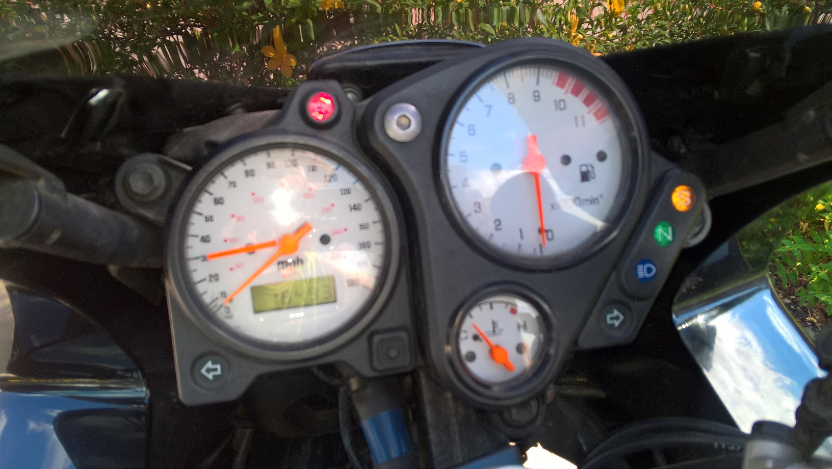

V5 has it as first reg in UK as 22/5/98, so I suspect it's not an import. I haven't poked around for a speedo healer specifically, but last time seat was off, I think I would have noted if there was something that looked non-original. It almost seems as if the relationship of the odometer is out of sync with the speedo, insomuch as the miles turn over at a higher ration of error than does the speed reading.
I was actually wondering about taking the cheap way out and just putting a 15T front sprocket on to negate the climbing mileage.
There is no overlay on the speedo. Pic below. The red 30 mph was a stick on by the previous fuddy-duddy owner 8O .

nigelrb wrote: Sun Jul 12, 2020 2:23 pm Thanks for your input Pete and Tony.
Well the clock face is not standard, so maybe they are KM clocks & the face has been replaced...
Std UK clocks the speedo is black...
Best bet is to try a different set of clocks & see what happens...
Re: Speedo weirdness
UK Standard clocks
Continental clocks

Thanks Mac and Wicky.
So I have an inbred clock :eek2 . I'll never be able to find out about that cos the bike came to me with nothing but 2 MoTs.
Makes me wonder now if it had been converted for someone maybe living in the Euro region for a while - hence the dual mph/kmh - and there is now a readout conflict. As previously written, I had felt as if the odometer was turning over in kilometres, but I think (in my limited Storm experience) these models don't have a conversion via the dash reset button.
New clocks might be the best solution. Is the mileage stored in the odometer or the ECU?

Pete.L wrote: Sun Jul 12, 2020 8:21 am Any chance your bike was a European Grey import and it's only had the clock face changed to make it look like a GB bike? . . .
You're on to something, Pete.
On re-reading the V5, the front says: 'Declared new in GB by independent importer.' (Still first regd in UK on 22/5/98, according to DVLA)
So it seems something has been botched - possibly over the life of the bike, BUT it's had 8 previous owners so I'm surprised no one has rectified this, OR none of them had a clue or couldn't be bothered.

Interesting.
I wish I knew where info was held. ECU or clocks? Has anyone got a spare set you could swap out temporarily?
You don’t have to worry about the MOT they will just note a chang of clocks and list the original miles and the start miles of the new clocks
I suspect the clocks , Like Tony suggested. Probably had a little glitch

The good news is, your bike has less miles on it than you thought.

tony.mon wrote: Mon Jul 13, 2020 1:45 pm The good news is, your bike has less miles on it than you thought.
True Tony, but the downside might be convincing a prospective purchaser of that if/when the time comes to sell it.

lazy way, junk the clocks and get a uk set close as possible to the miles on the bike :thumbup:
Posts: 15980
True. As long as they're a little more than the milage at the last mot, you're good to go.
