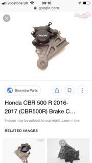

Mr Squid, one of my Storms has a suzuki ( huck spit...spitoooooon! ) SV650 rear calliper on it...
It's on the bike I bought from the Master Breaker himself...Jonesey...
It has much more power/feel than the std honda one...
If your std ones rubbers have disintegrated then when replacing take the thing off & give it a propper clean & service...Piston & seals out proper clean!
Edit update...It is a CBR 500 not an SV also the bike has a braced swinger so the mounting bracket is different... although others who have braced still use the std calliper...so it must be the same fittment...
Hmm.. its tempting.. i could get one of those for the cost of pins and rubbers,, but would still need pins and rubbers, and pads, and its still just a single pot.. might put that one on the backburner for a bit. Thanks for the idea though.
