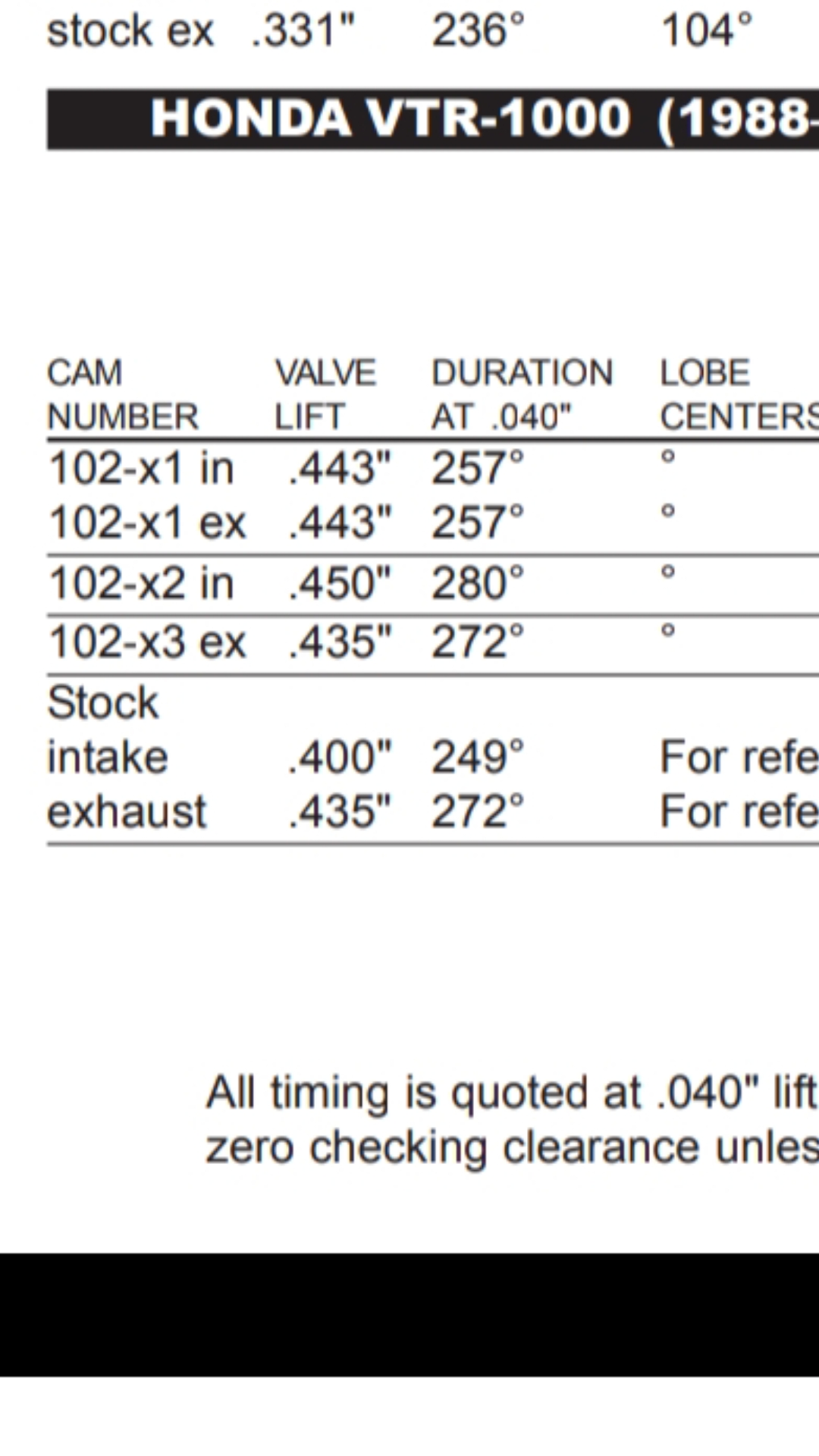

They dont give much info about them, this is all I have.
my cams are the ones with 272deg and 280deg

Thanks ! that is great. They do seem quite extreme.. I will definatly be carefully checking the pistonto valve clearance . Could it be that the durarion is longer because they measured it from 40thou instead of the standard 50thou?

Not sure, i consider 0.04 (1 mm) as standard.

I was doing a bit of reading on the subject and it seems that many different aftermarket cam manufactures measure from 0.050" lift but oem are from 0.040" (1mm)
I would imagine that everywhere besides Canada and the USA uses 1mm as standard... for some reason we seem to be stuck on using imperial units :confused

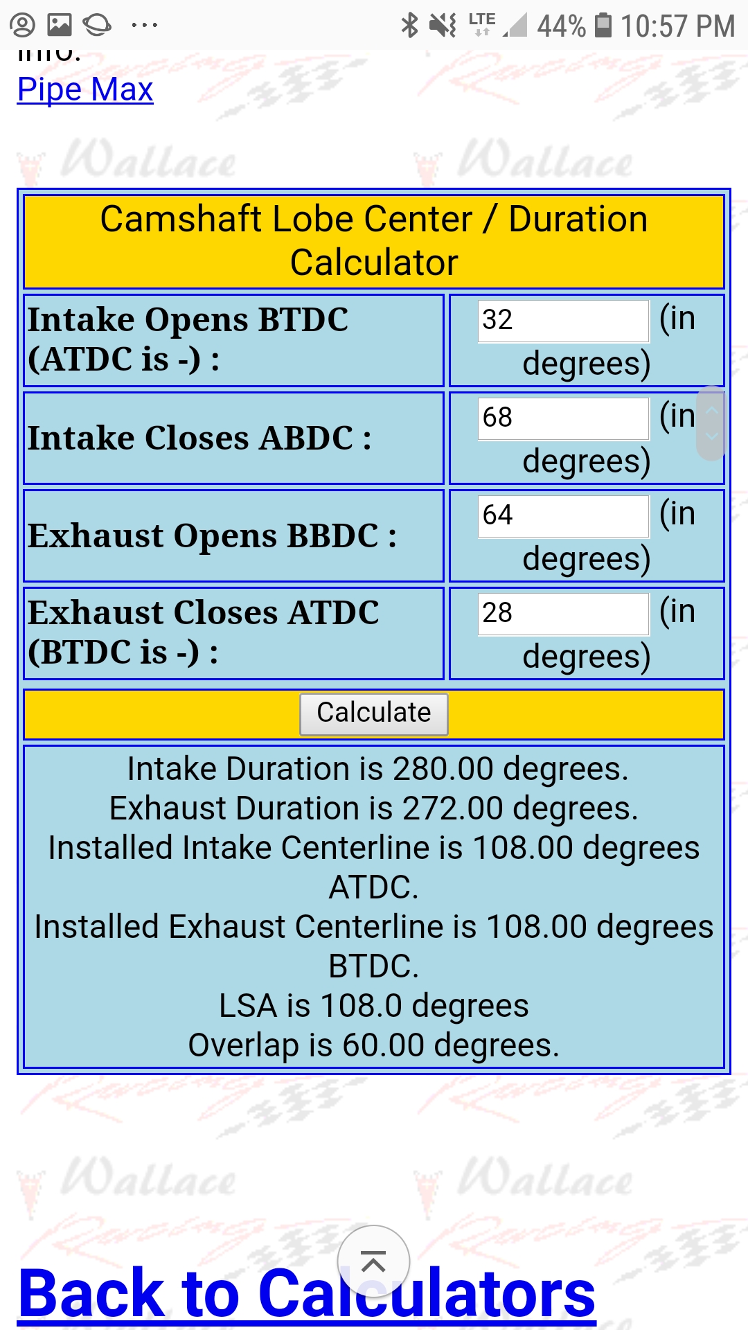

After a bit of playing around with that calculator as well as some others this is what Ive come up with to try:

at least if both, stock and mega cycles are measured at 1mm valve lift, you see the real difference between specs.

My corrected suggestion would be 30/70/66/26 with valve overlap 56.
I wonder how it will perform, because I expect you will struggle with air volume and correct afr. At least open airbox and fuel pump will be needed. This is uncharted territory.

your suggestion is close to what Ive come up with, Maybe better with a bit less overlap.
I have removed the filter plate in the airbox, covered the snorkle , and cut a square in the top of the lid for the filter element. I also raised the tank slighty and removed the foam from the bottom of the tank.
the airbox volume is now almost double and breathes freely.
I may fit a fuel pump. Ive never had a problem with fuel supply before, but I could see that being a possible issue now.... as you say, Its uncharted territory

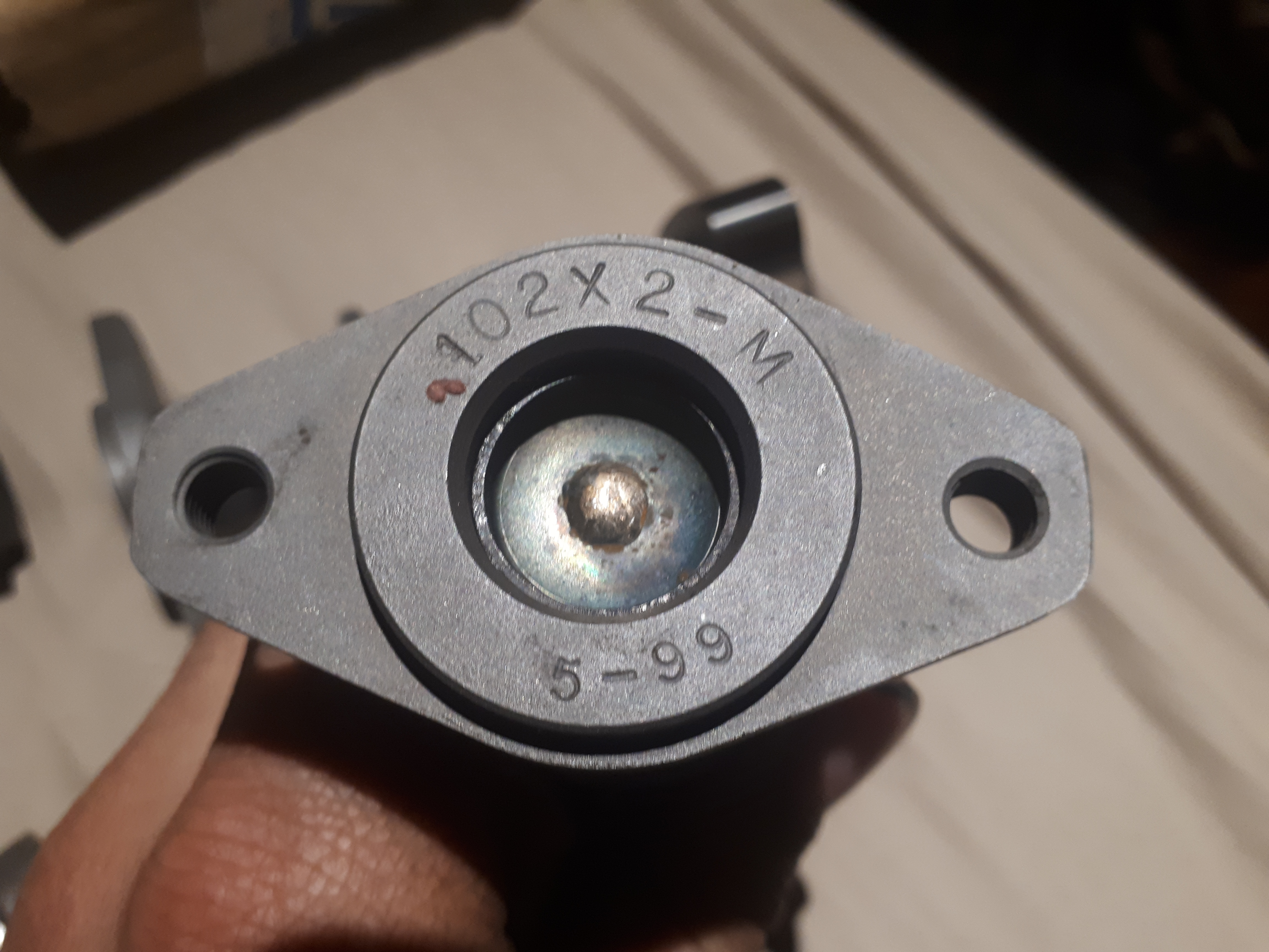

May I ask How the cams look ? Have they got any marking on them at all, or any stamps ?
The reason I ask is I was led to believe I have Mega cycle cams, but upon inspection, have found no markings or any form of identification.
cheers

Martinz wrote: Sat Jan 26, 2019 1:49 pm May I ask How the cams look ? Have they got any marking on them at all, or any stamps ?
cheers
They do use the stock core, but there should be markings stamped on the sprocket end showing the part number. You should be able to see that one cam has a different profile than the other, and some of the bearing caps had to be filed for the lobes to clear.

Thanks thats great information. Did you have to remove the cam sprockets in order to view these stamps ?

Martinz wrote: Sat Jan 26, 2019 7:19 pm Thanks thats great information. Did you have to remove the cam sprockets in order to view these stamps ?
Thanks again,
The stamps are visible with the sprockets on... they are off in the picture because I received the cams without sprockets.

Chris58 wrote: Sat Jan 26, 2019 8:24 pm
Thanks again,
Cheers for the info mate. Im gonna whip the sprockets off anyway.....just to be sure... :crazy:
