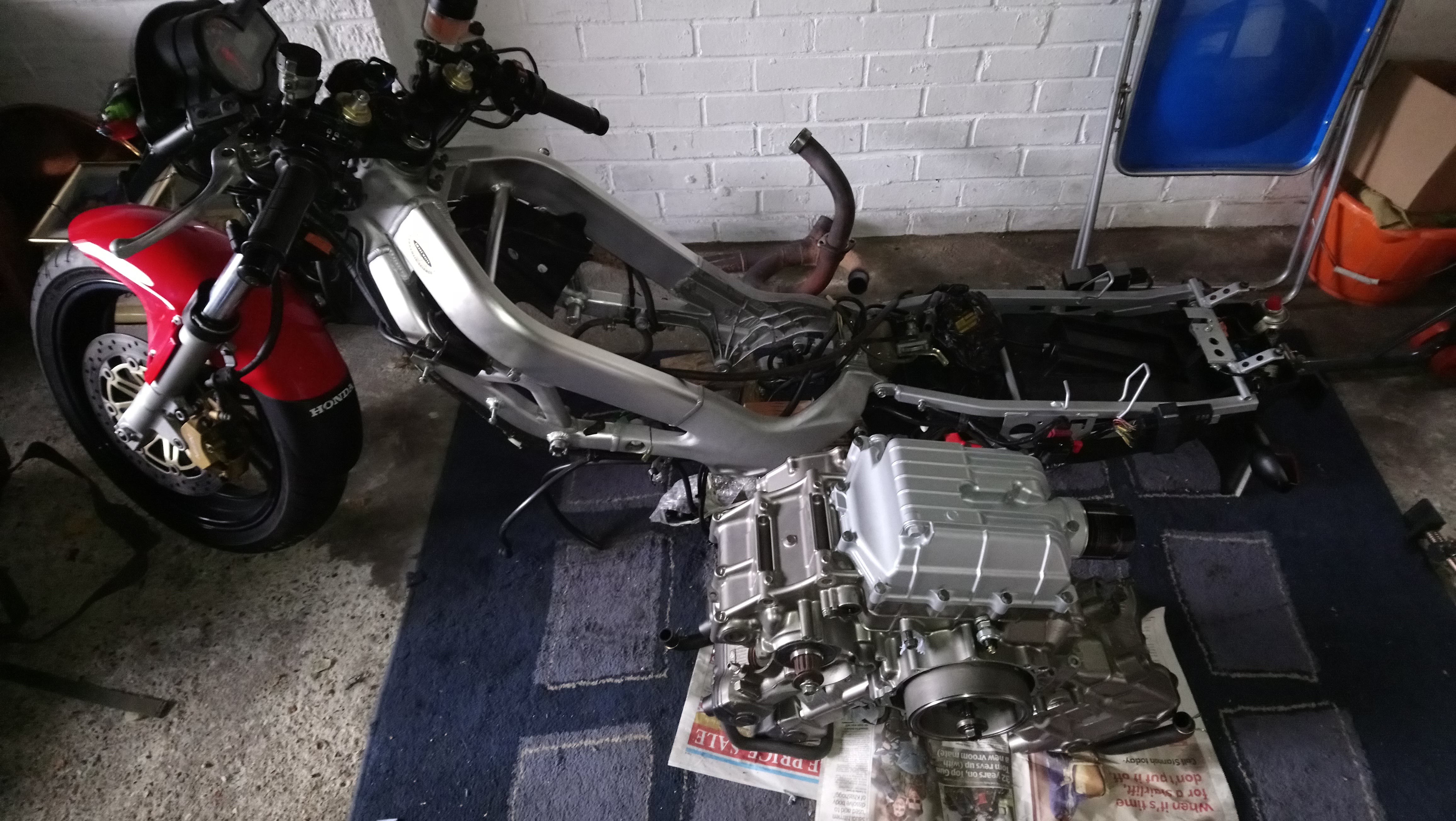

Re splitting the cases, it will take longer to split the cases and leave the upper half connected to the frame.
Unless you have a really good reason it would be simpler to remove the engine and place it on an engine stand to work on.

Perhaps one of the shells hasn't quite seated properly.
Anyway, it's a straightforward fix having done it once, just time consuming.
I'd still suggest pulling the engine out and using an engine stand, it makes it much easier than working at ground level.
