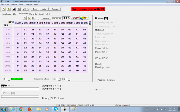

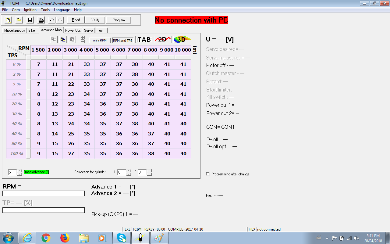

Are any of you folks running a Ignitech tcip4 sparker? If so did you change the advance much? any comparisons would be great!
I have just got to programming it... seems like the map they sent looks pretty conservative with the advance curve.
Heres a pic of the original settings... and one that I've modified the advance chart

This is my map, tuned on dyno

Stephan wrote: Sun Apr 29, 2018 12:54 pm This is my map, tuned on dyno
I notice your base advance is set to 5deg, I just read in 2 of those links from wicky that the vtr is measured at 15deg base advance. Did you get a chance to measure that ? Or did 5 work better when tuning?

Chris58: base advance here does nothing. When cdi get signal from tps and revs, it takes values from table and this base advance is not calculated here.

Stephan, I appreciate the explaination. I have a better understanding now.
Only makes sense to use your map as a starting point, since you've already dyno'd it.

Post by Stephan »
0-4 and 7-9 k rpm are fine in my map, and more advance in top end had no effect on power on dyno so there is no point to change it. Not sure about 4-7 where I stuggle a bit, but this is not problem of ignition, map here is probably ok as well.
